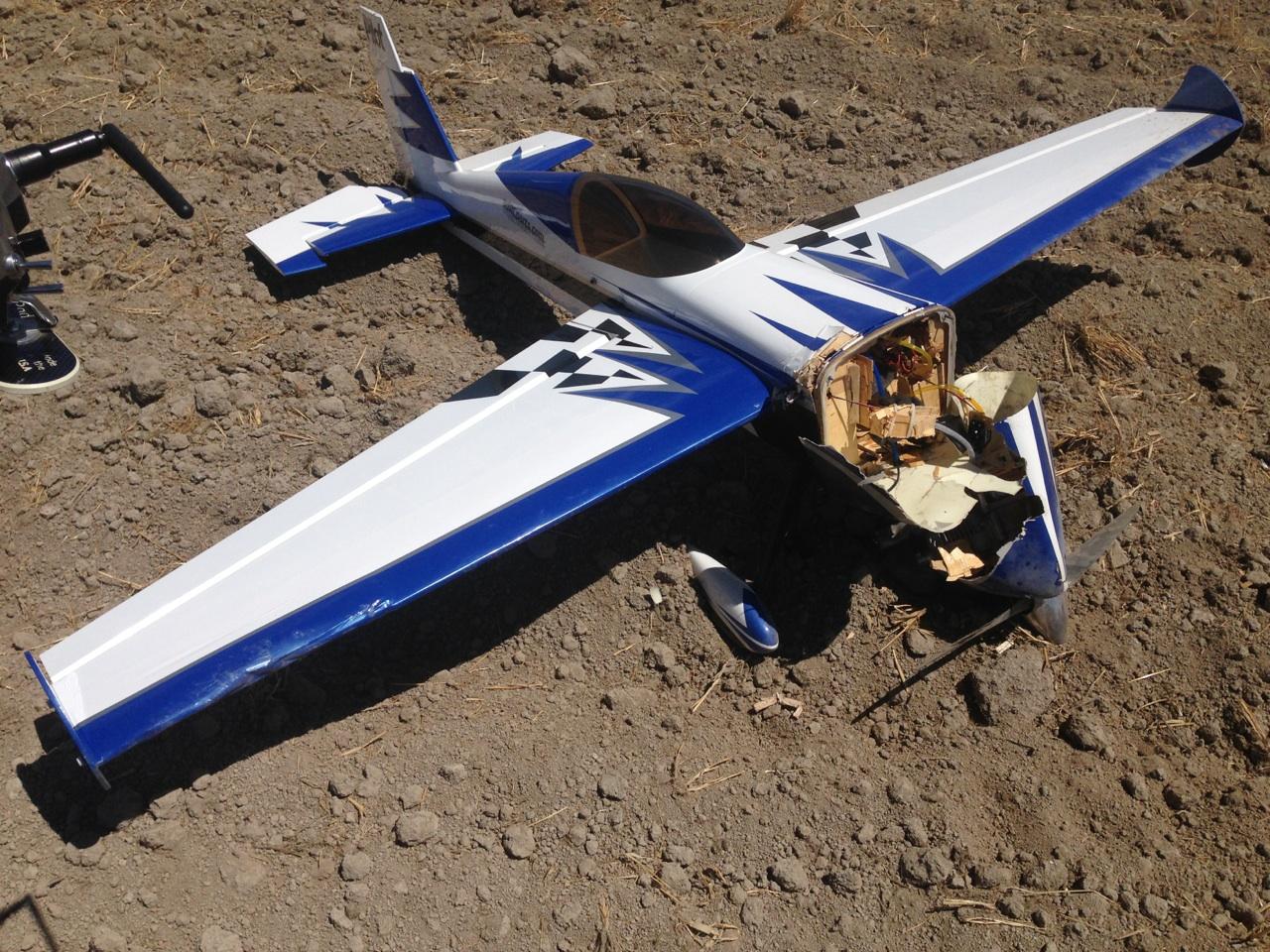

rx battery crapped out due to choke servo binding
3dRCparts.com
gp61 choke arm is not in the ideal location, would have to come out the side of the cowl and use a bell crank, choke servo seemed like a good idea at the time.
Sorry about the crash :(
I used a bell crank on all of mine. In the 3dhs 92 and Aeroplus 92 Edge, It comes out of the fuse on the side just past the cowl. On the Redwing 89" Extra, it's going to come out of the side of the cowl.
