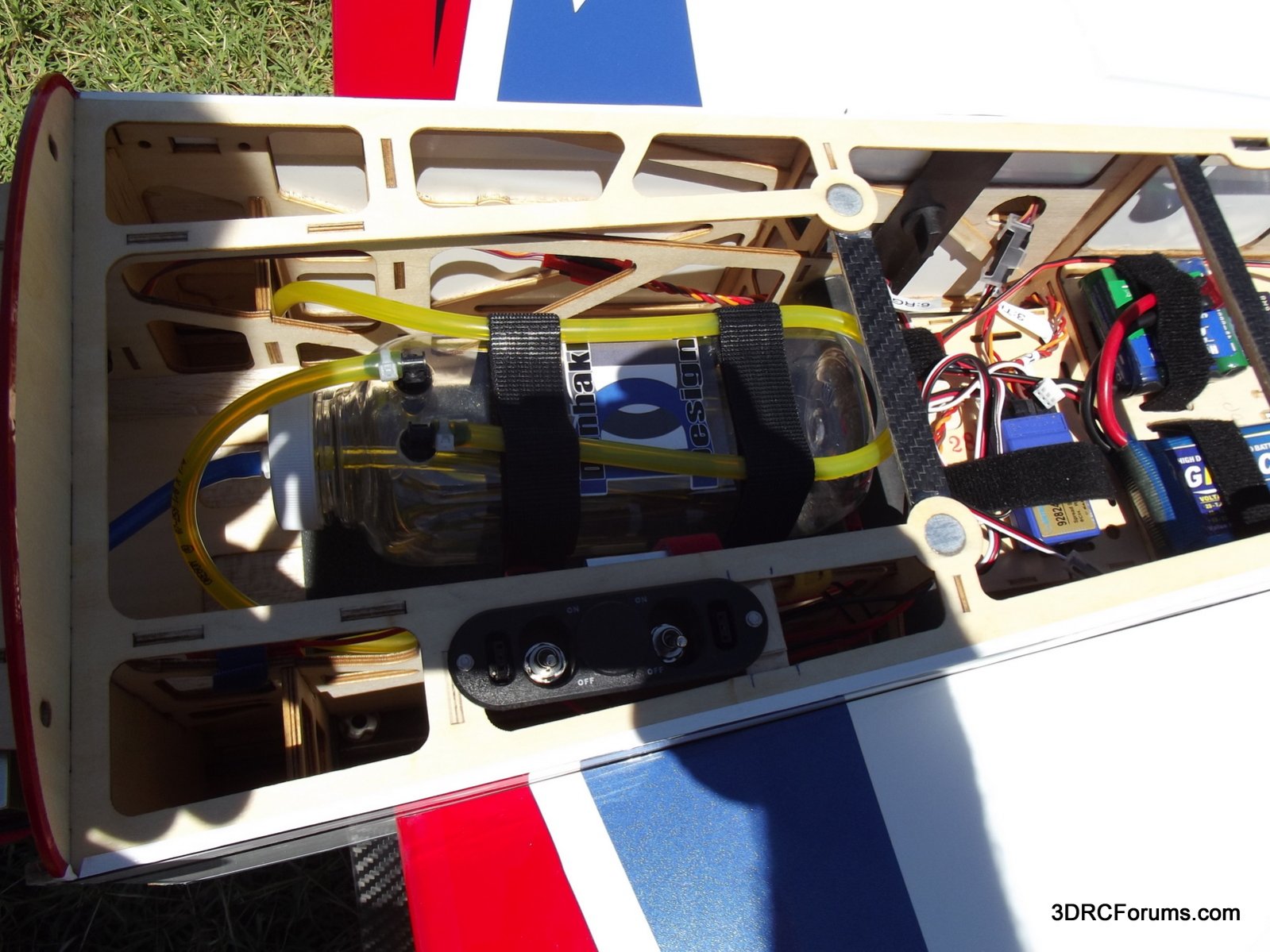

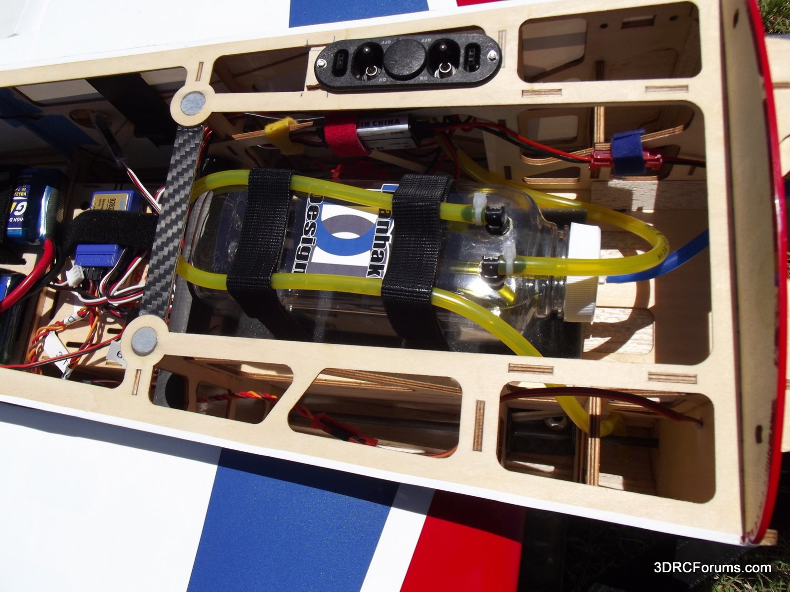

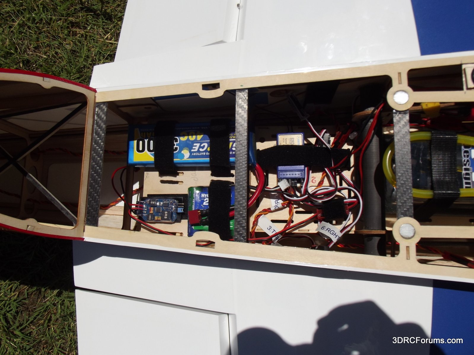

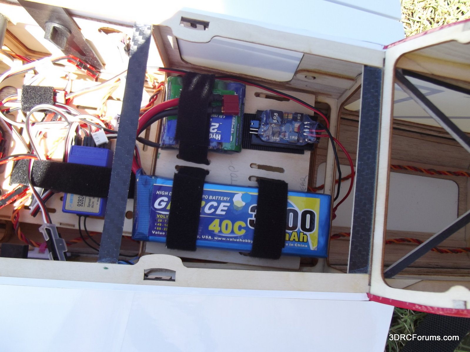

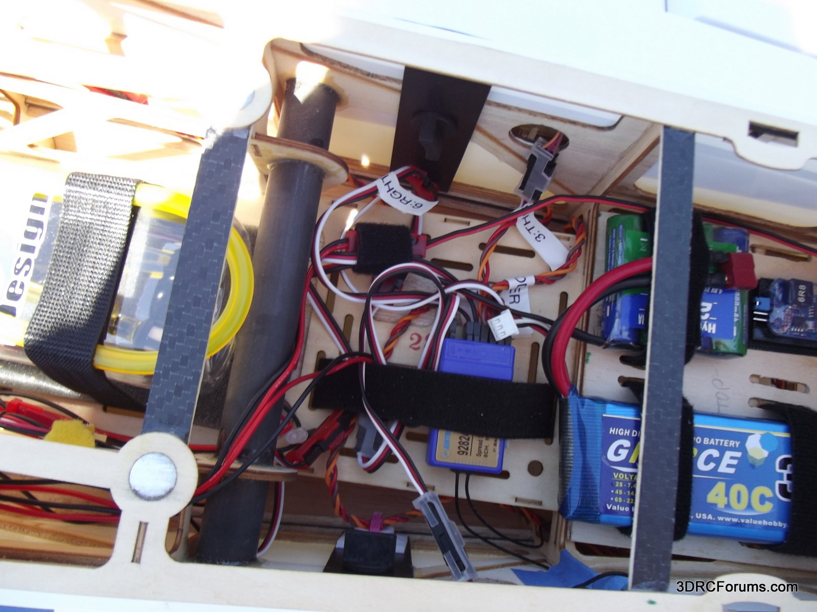

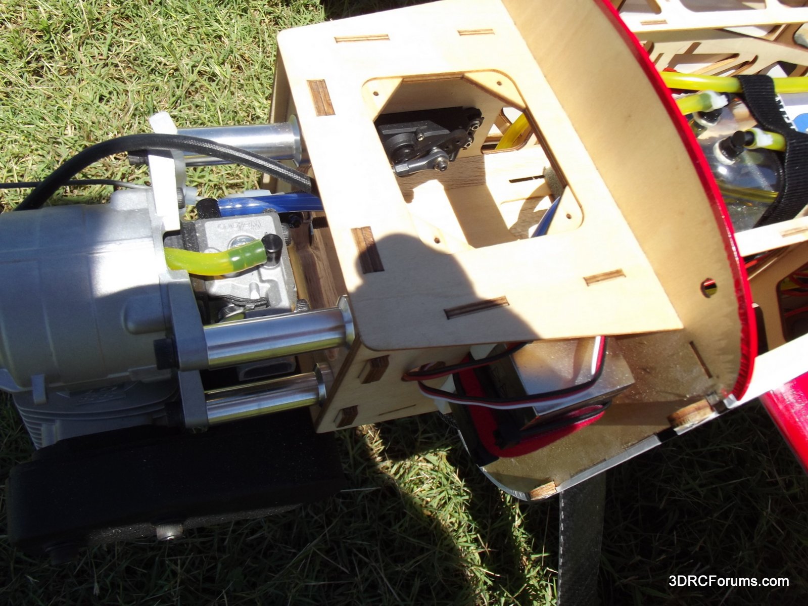

Well, now that I have a moment to reorganize, I figured I better update this build log. I brought the plane (not ready to fly) to Cape G. and was able to get 'er done at the field, with some wisdom from PB about my one remaining conundrum: where to mount the switch. PB looked at the setup and suggested that I mount the switch inside the fuse...after considering it for a few moments I realized this was a good idea. Sure, I'd have to take the canopy off to switch on/off and to refuel, but that was no big deal and it sure made it a heck of a lot easier to mount the switch. If I ever get different switches for this plane, I'll get two individual switches and a fuel dot instead of a combined two switch/fuel dot component. Reason? it is easier to mount two smaller switches and a fuel dot to the exterior of the fuselage. You will notice from some of the pictures that I built a battery tray out of lite ply and secured it over the top of the pull pull rudder area.

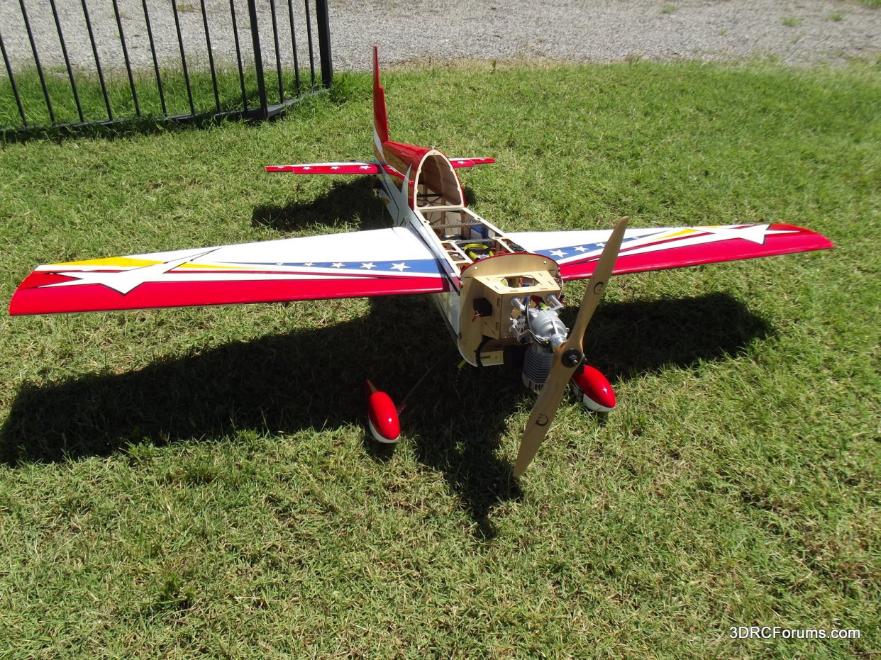

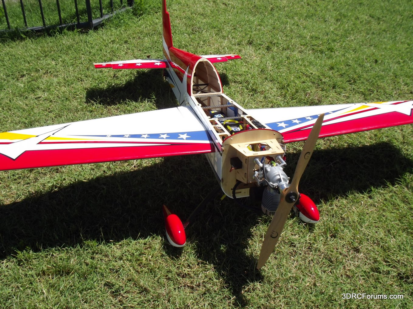

Anyway, here are the last pics taken before the maiden:

As far as the maiden flight went, it was great! Just like you'd hope a maiden would go...no deadsticks, decent throttle curve/response, very gentle characteristics on low rates. CG appears to be a very small touch tail heavy...rolling inverted did not cause any nose drop, and perhaps the tail lifted a hair. Like I said, just a touch tail heavy I think. Since both batteries are in the rear, I think I'll move the ignition battery forward of the wing tube and try that arrangement. Should be just about the right amount of weight shift in the CG.

The OS GT 33 started right up (backwards of course) but the opto-kill, bump the throttle up a notch or two, then restart allowed it to start correctly. This issue is something to be aware of, especially for the holder, but not a big deal. The motor, which already had two gallons run through it, ran flawlessly and idles reliably. No hint of a dead stick, and landing was uneventful. I really like the sound of this motor.
