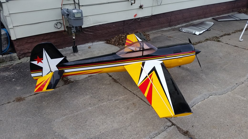

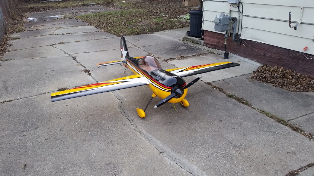

finally done and ready to fly...just need warm weather

That yellow/black sure does look awesome.
I got mine from a guy near me that was selling a blue one new in box for 550, so I couldn't pass it up. But if I was ordering new, I sure would have gotten that yellow/black.

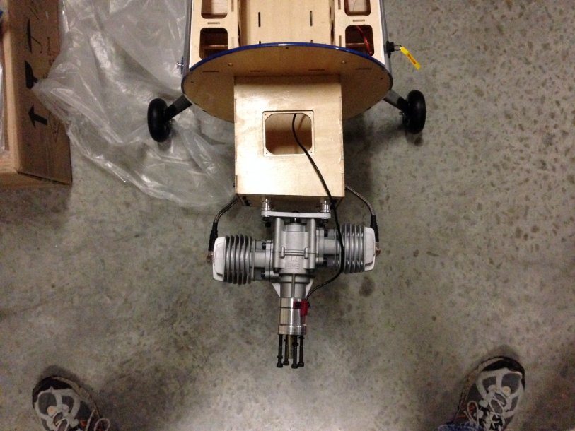

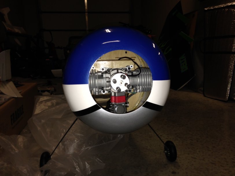

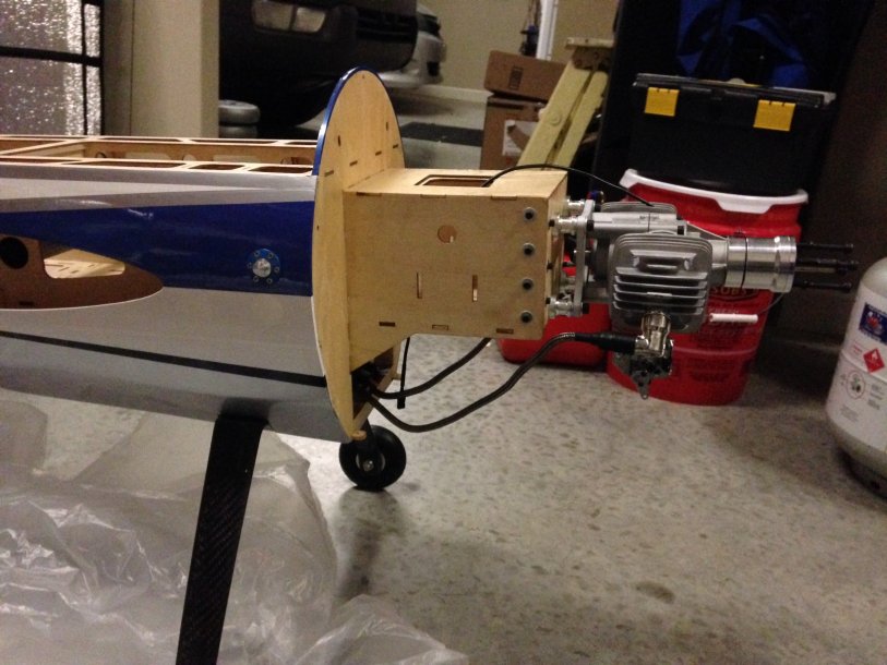

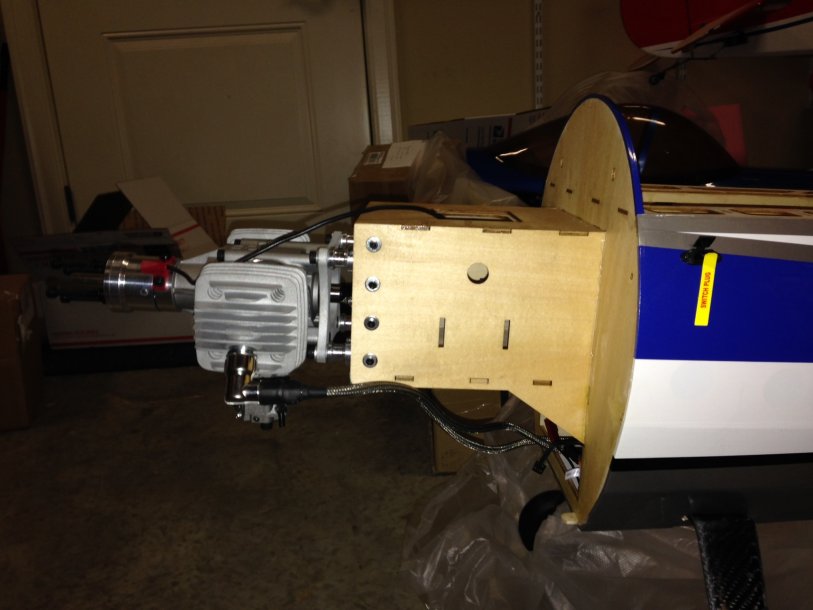

These aren't terribly exciting as all I've done is hang the motor, hopefully over the next few days I'll get the ignition mounted, throttle linkage connected up, and choke figured out. Gonna be too cold to fly this coming weekend, so I'm not in a huge rush to finish it all up.
The included standoffs with the EME work great. I had to add one washer in addition to each one to get it to be the right spacing, and had to get some longer M5 bolts to mount everything up (need at least 1.5" long ones), but otherwise the install was a snap. They included a template for the hole locations, so it didn't take long at all to get it all mounted.
