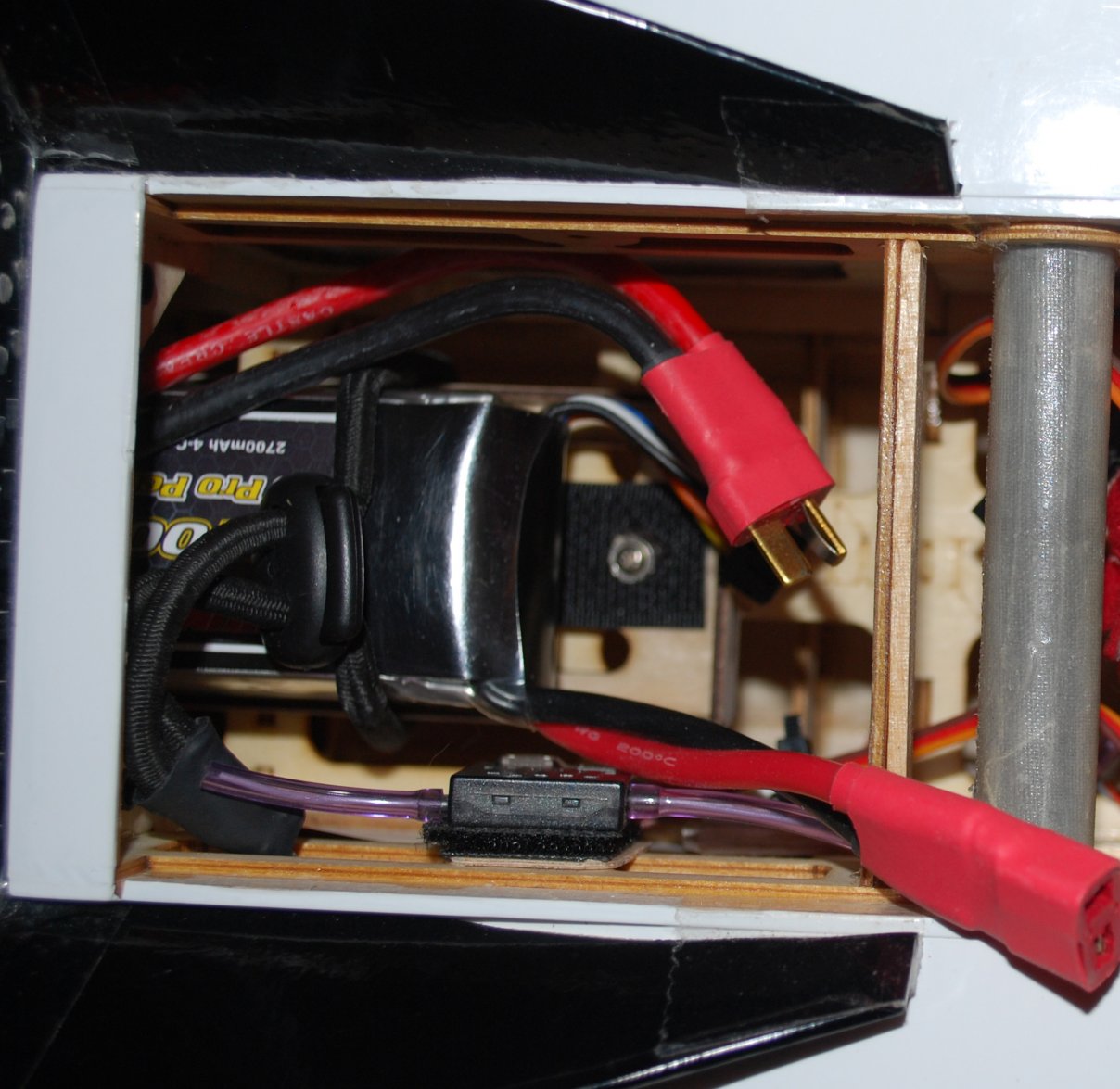

my problems are in getting to the strap, and fastening it around the battery. Dang thing always falls down and then I have to yank the whole battery out again to get to the end of it. Or it gets tucked just so behind the battery plug wire, and I have to pull the battery out. Drives me crazy. It's easy to stick in and position though, I don't have need of the box. Just more room to get the strapping done easier!
SteveT.
Don't use a strap. I found the very best way to fasten in a battery (along with my battery box..:D) is to use shock cord and a cord lock... You just make a loop with the cord and a cord lock. Then to install the battery, slide it in and cinch it down! Works wonderfully
Here is a photo...
