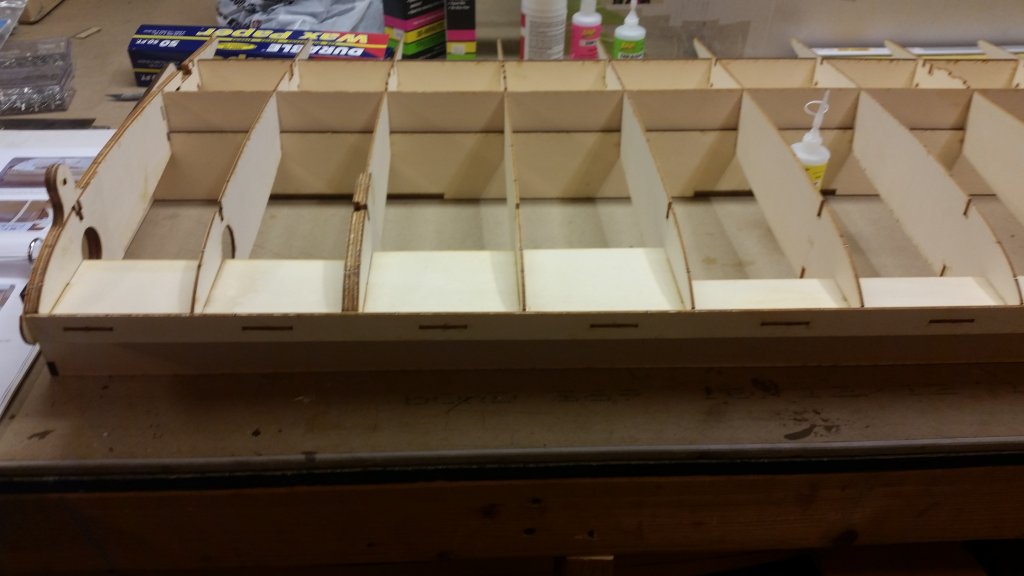

Anyway, yesterday is gone and soon to be forgotten. I went to my Buddy's house and pulled out all of the pieces to build the wing jig. Then I put the jig together.
Then, as you can see I laid out all the ribs. You can also see the ribs I had to double up and add doublers to Rib W3 for the end of the wing tube. The wing jig is nice. The instructions tell you to assemble the jig with all of the part labels facing you and you build the left wing panel upside down in the jig. Then, after the left panel is done, you unscrew the blocks in the corner of the jig, turn the pieces of the jig around so the text is facing away from you. Then you screw the blocks back in the corners then build the right wing panel upside down in the jig. It's a slick little system. The biggest concern I have at this point is getting a little to heavy handed with the CA and accidently gluing the wing to the jig. I am using slow thick CA, so as long as I'm careful, it shouldn't be a problem.

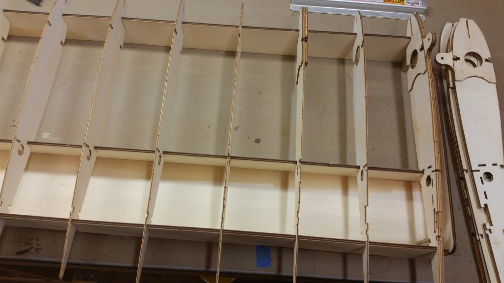

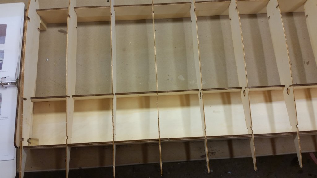

In this picture, you can see the horizontal leading edge piece inserted in grooves in the ribs and pushed all the way back so the front of the piece is even with the front of the ribs. What you cannot see is that I accidently broke the horizontal piece on the right side of the fifth rib from the left in the bottom picture. . . .
. I cannot see that this will cause any problems whatsoever, because, as you can see the vertical leading edge backer interlocks with the horizontal piece between every rib for the full length of the wing.

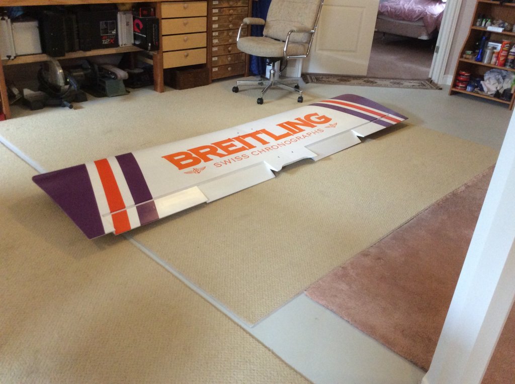

@Snoopy1, thanks for the picture reminder. I like what you did with your ailerons, but that may not possible for me. The ailerons and flaps on the 50cc size are flat stock and not built up. Adding the little piece near the fuselage won't be the problem, but the outboard ends might be.
