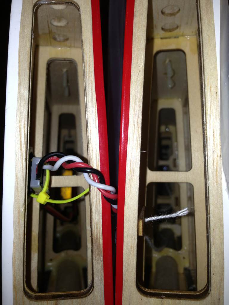

So I purchased a new right wing, and it did arrive quickly and without damage. This was surprising to me, as it was essentially loose in the box with a little brown packing paper.
Unfortunately, I've lost my confidence in the ability of wings to handle my violent pop tops, so I will have to spend some time reinforcing both the surviving left wing, and the new right one, since they look absolutely identical inside. I've heard this is a good idea with this specific airframe, and involves the application of a TON of CA around the receiving tube, followed by a healthy amount of epoxy and an extra piece of wood adjacent to the receiving tube to reinforce the area. I'll post some pics of a before/after.
I also think I'll explore adding a width wise stiffener to the interior of the fuse near the rear anti-rotation pin... can't hurt, right?

I thought in the V2 they reinforced the weak part of the wing? I have a V1 and got cracks inside the wing and had to do the strengthening that you are talking about. It's held up so far, fingers crossed.
I was told my plane was a V1, but I genuinely thought it was a V2 when I got it.

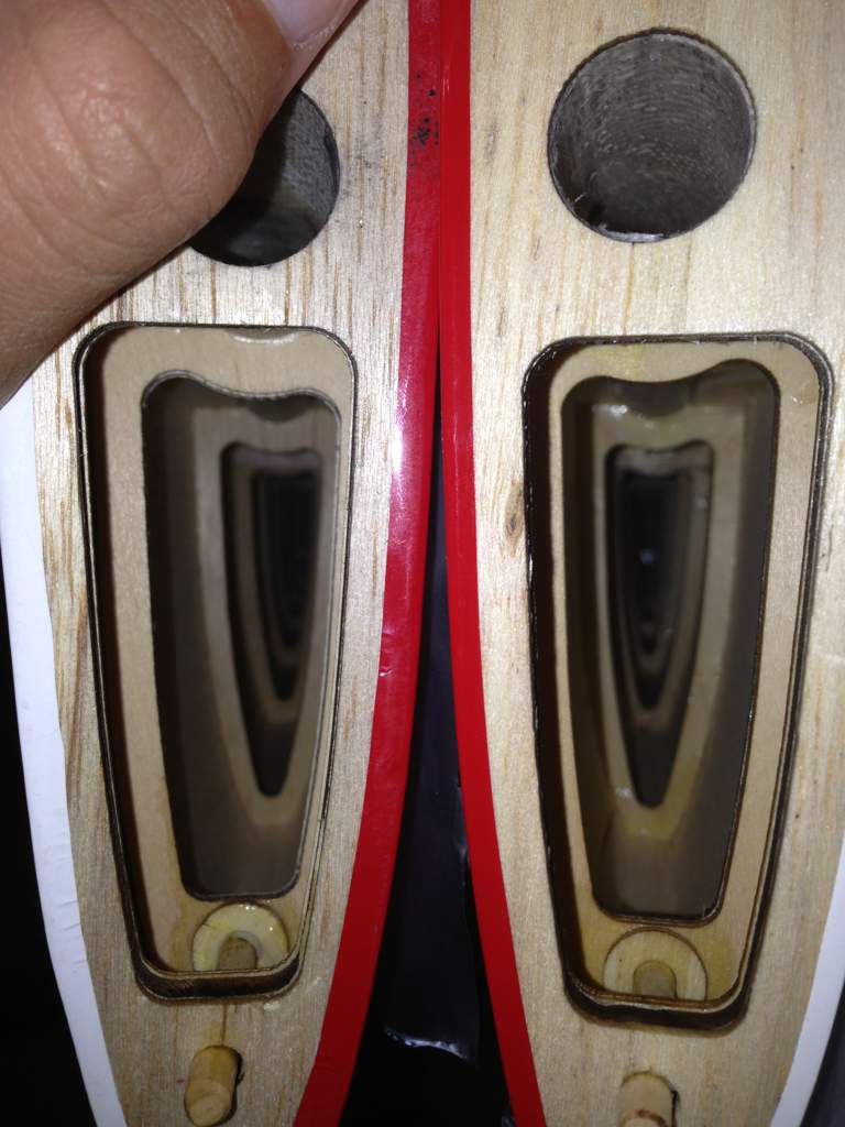

Here are pics of my surviving left wing (on the left) and the new right wing (on the right). The right wing is still in the plastic bag it arrived in.
I've studied them closely, and can't discern any difference.
CHQ28
When in doubt might as well reinforce. It doesn't take to long, plus you can't land a one winged plane everytime!:)
