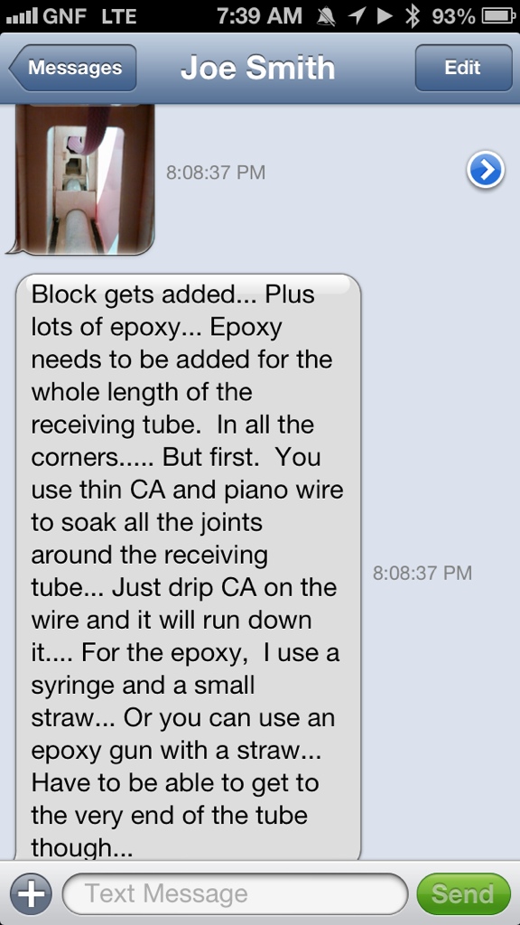

First and foremost with this airplane, reinforce your wings. I learned the hard way they are a known weak point. My wing failed and came off the airplane on it's 18th flight...
After I had to purchase a new wing, Joe Smith sent me some instructions and pics on where he reinforced his so they wouldn't break, I posted it all a few months back.
Please don't hesitate to ask if you need anything else, this plane flies well and you'll surely enjoy it.
I found the text from Joe, here is what he says you should do:
Here is the full image of the inside of his wing:

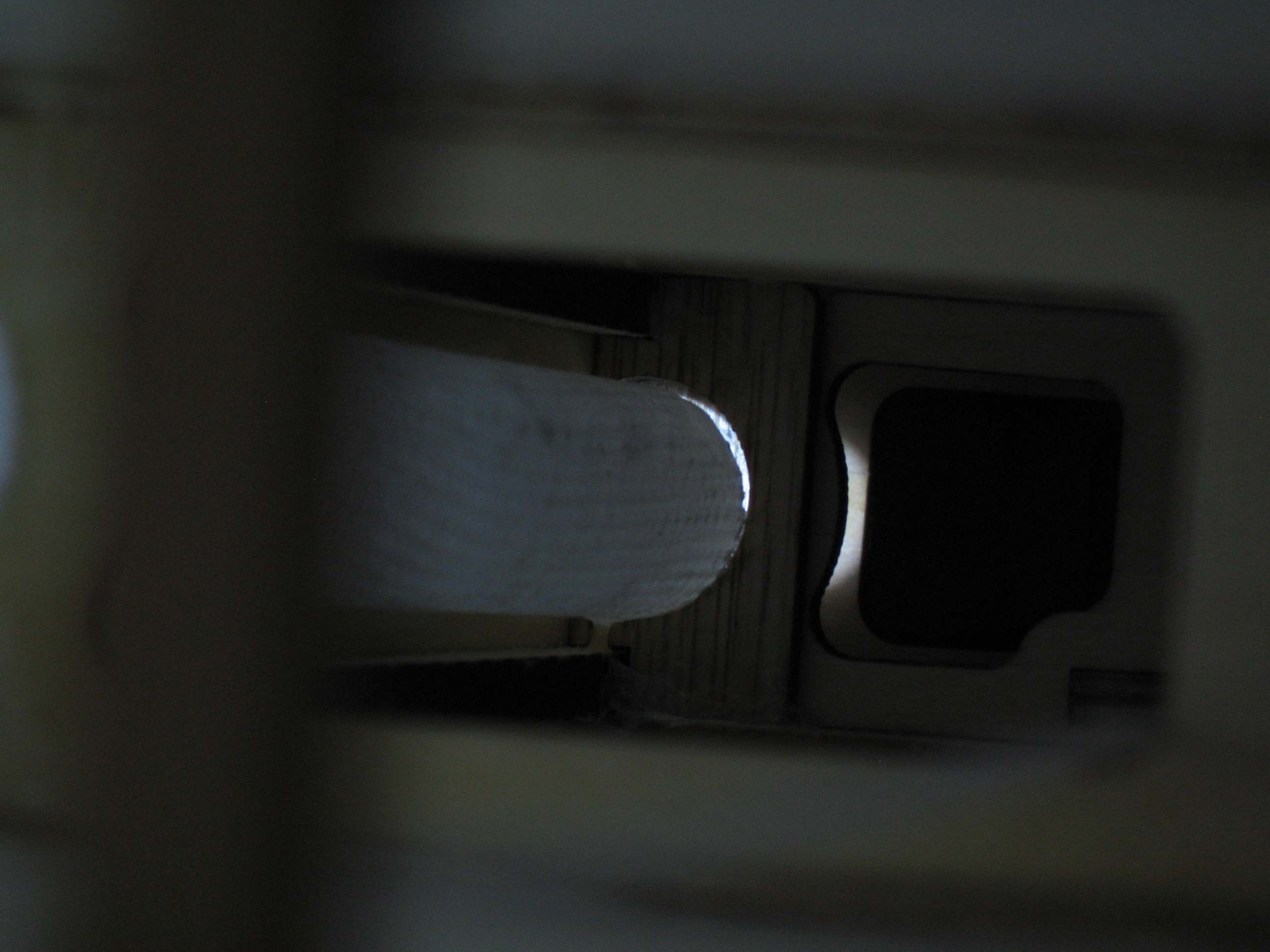

Don't worry I have already reinforced the wings based on these threads! Don't want to take any chances with this baby!! One wing looked ok but I epoxied it anyway but the other wing was really bad. The tube sleeve didn't even reach the third rib even with their added block in the V2 wing! So I made the block and added it. Found if I removed the servo I could get my fingers pretty close to the problem area to position the block. I think I am going to add more epoxy along the whole length of the tube sleeve as per the instructions. Here is a pic of the end of the sleeve before I fixed it. I shone a light down the tube to so you could see the gap
That's simply scary. I honestly can't tell any difference between the v1 and v2 wings. I think it may just be marketing... I don't know.
Glad you didn't fly it that way. When I was messaging with Joe about his, he said his mods make it about as strong as it can get, and that he couldn't break it.
Wish they'd do that at the factory versus letting people figure it out themselves.
Wow Gary... that is putting it nicely. I crafted a response to that three times but couldn't manage to moderate my tone. It makes me angry to see that picture knowing that 3dhs management seems aware of the problems. There are too many other good options around for me to take that kind of risk. I'm not interested in having to make mods on a plane that is supposed to be "... the Best." I'll spare everyone the self-righteous anger rant I typed the first two times. They make their decisions and I make mine and I'm spending my $ elsewhere for now. The new AJ Laser looks promising ;)
