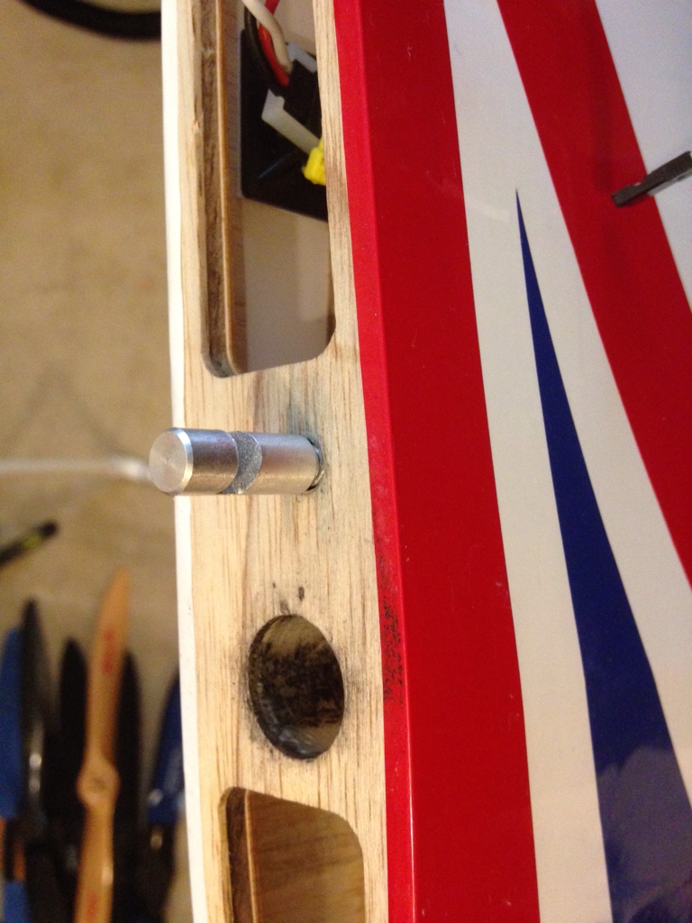

I finally fixed my pain in the arse wing bolt problem! These wing bolts are seriously hard to get to!
Today, I installed some Xion Wing locks from [MENTION=2470]RedwingRC[/MENTION]! All you've gotta do is just figure out the right depth of the bolt,
Loctite in, and glue the grommet to finish. The bolt stays in!

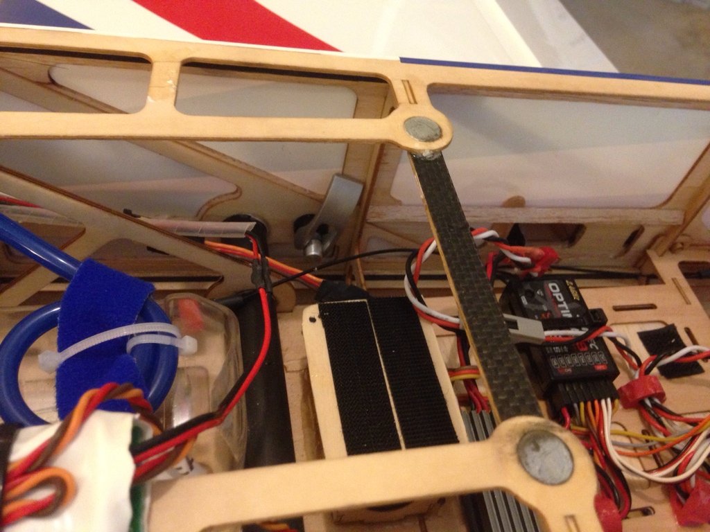

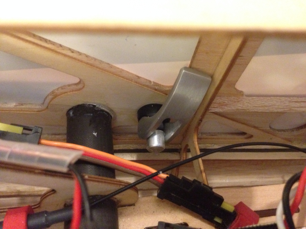

Now I just insert the wings, pop in the cam lever, and flip it over to attach, and go fly.
