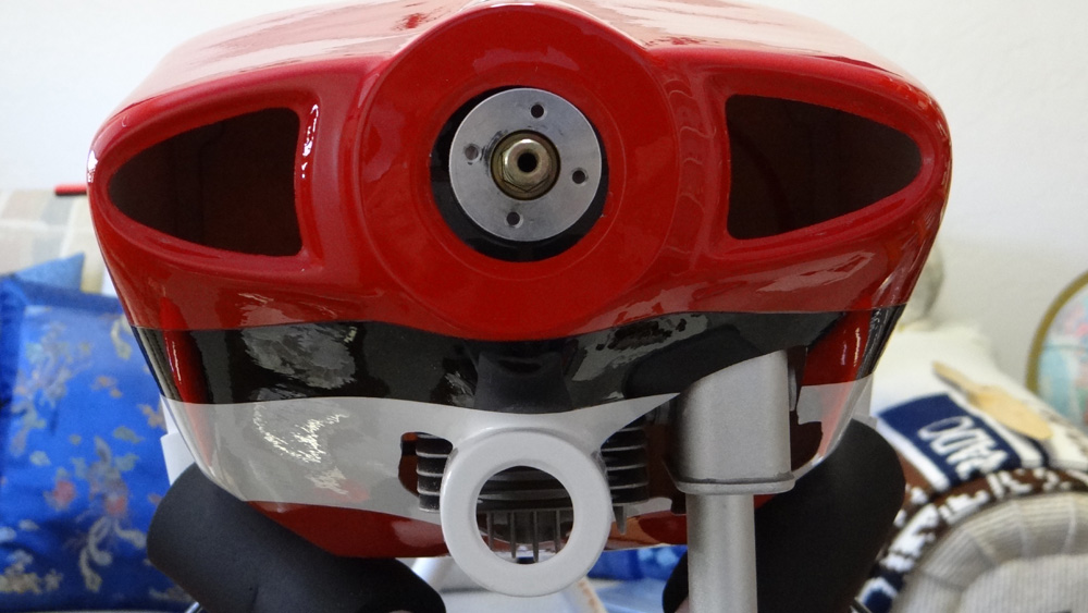

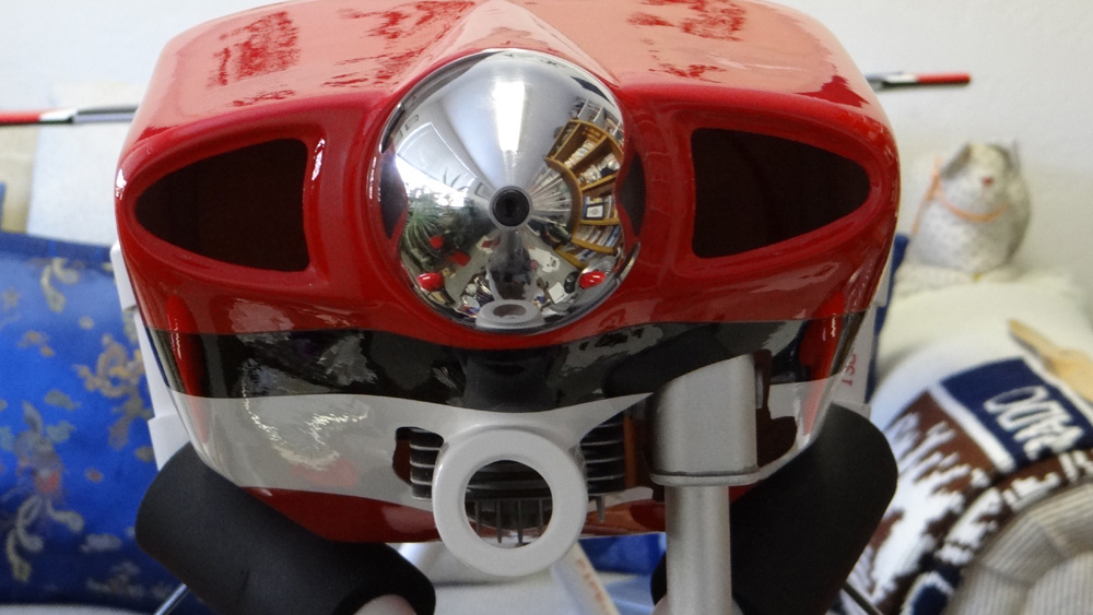

Hey guys. I've got a cowl alignment question. I mounted the DLE-30 using the stand-offs included with the motor and the DLE-30 drill template included with the kit. I also got the cowl cut. When I put the cowl on and align it to the fuselage, the motor isn't centered at the front of the cowl.
I don't think I can shim the cowl or it won't match up with the fuselage. And I don't think I want to shim the motor or it will change the thrust angle. The gap between the spinner and the cowl isn't perfect but I can live with it. Anybody have any suggestions or should I just go with it as is?

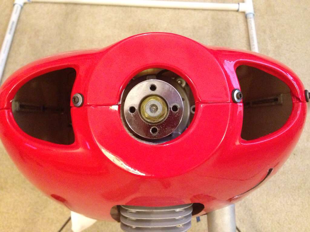

This was the cowl alignment on my 92" edge:
That motor was mounted correctly, the issue was in the cowl ring. I just used a slightly larger spinner and all was ok for me.

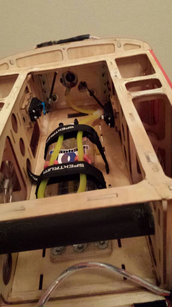

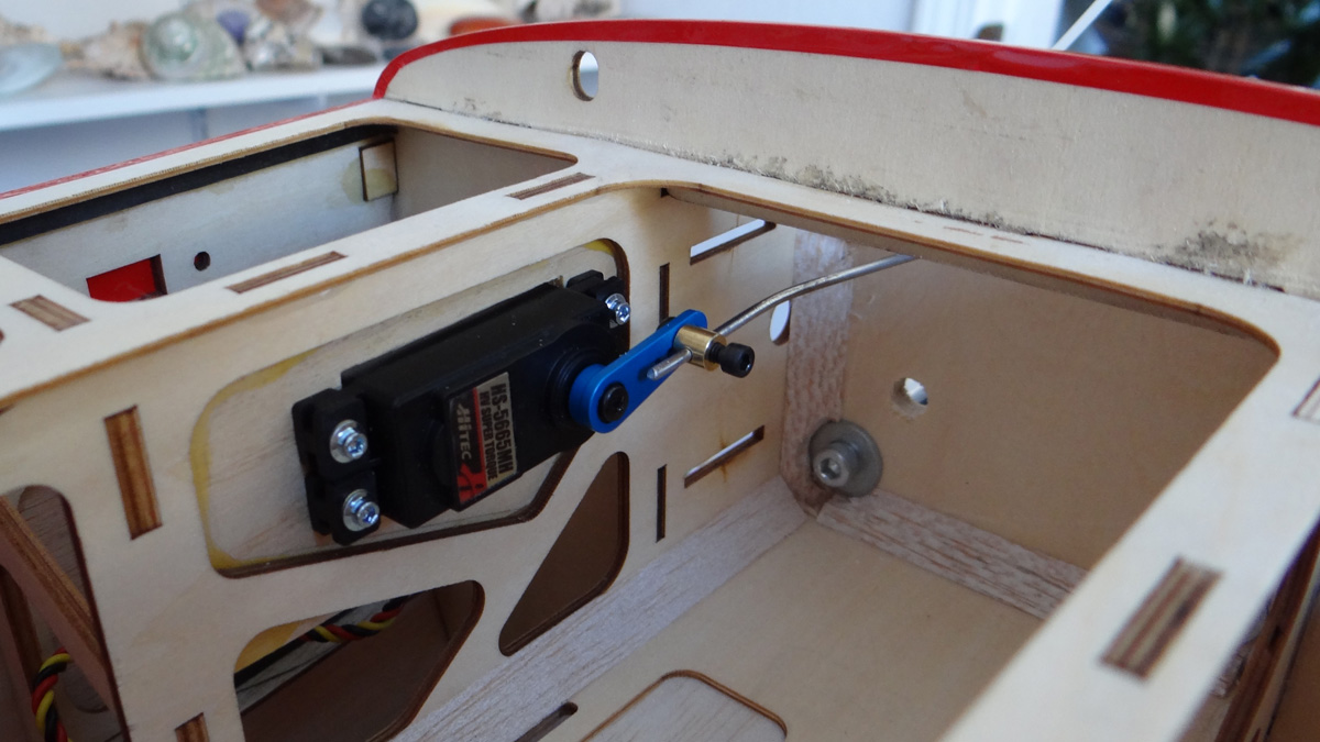

On another note, I was pleased with my throttle servo mounting. It'll be out of the way of the fuel tank and still pretty easy to get to. I haven't seen anyone else mount it this way (maybe there is a reason for that?). But if needed for CG, I can use a flex-cable and move the servo back.

That's how I mounted my choke servo and throttle servo on my 92 and will never mount in any other location again. It's nice cause there out of the way!
