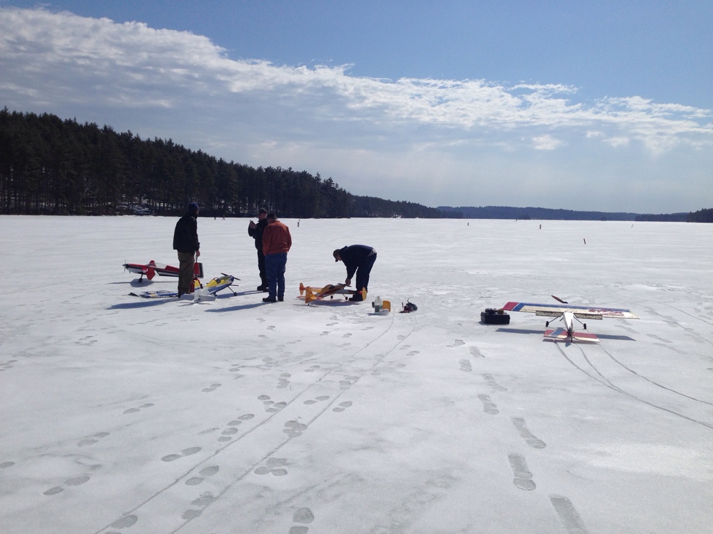

I got 3 flights on mine this Saturday. We had to fly off a frozen lake facing the sun, but that is life in the Shire.
This airplane is so freaking stable, it never scared my out of practice fingers.
I almost tried the 21x10 on her. Just plain ran out of time before work.
