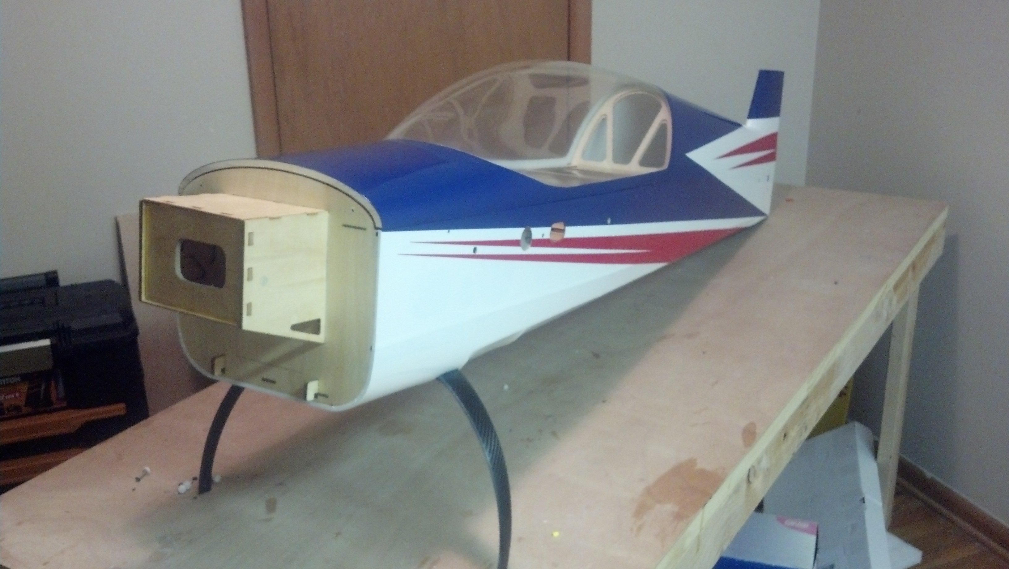

Well I like everything so far, except the cheap Chinese wood smell when I get near or get close to the interior with the canopy off. Hope it fades away!
Can't do a lot to her yet, waiting on DA-60, header, and RE2 pipe, Futaba R7008SB hv receivers, and Futaba BLS177SV's

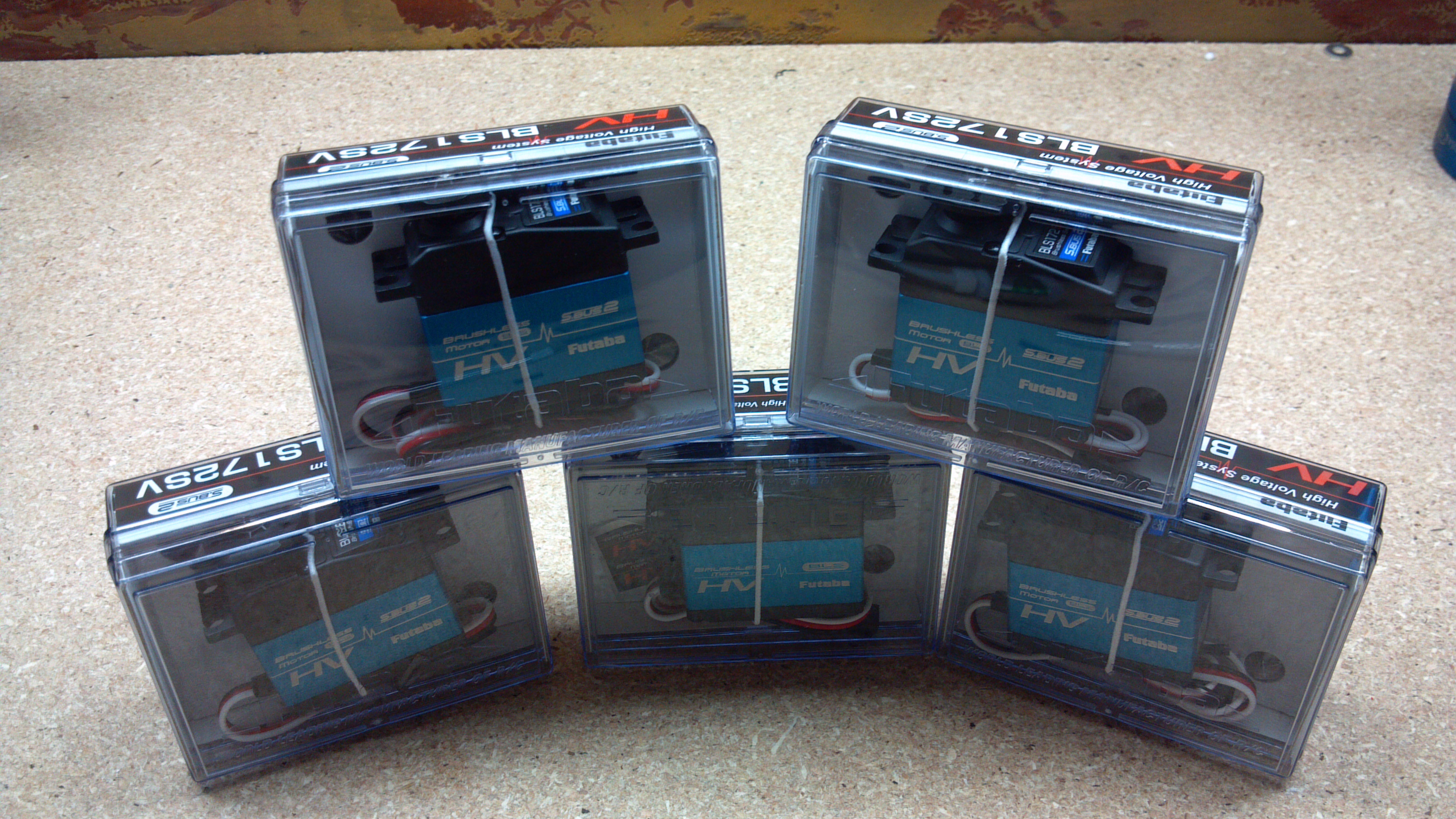

Everything ordered and on its way. 2 - Futaba R7008SB receivers, DA-60, header and RE2 pipe, 5 - BLS172SV servos, 24-9 and 24-10 Falcon props, Fromeco Wolverine Switch, 2 - 2100 7.4 lipos, 4 - SWB 2" half servo arms, 1 - 4" SWB full servo arm, Secraft Fuel Dot V2 - Red, Secraft Easy Couplers - Blue, Secraft Wire Tensioners - Blue, and a 32oz Fourtitude fuel tank. Still needing to order a spinner!
Good time to go over every glue joint with thin CA and fuel proof all the 'cheap Chinese wood". I used clear Krylon, but there are many ways to skin that cat.

I tried that prop and it fit with the Mej 24-10 cutout. It is best to ask Tru-Turn. Also, I put 2-3 socket head servo screws in the firewall on each side of the motor box. I drilled it first and put the screws in with Gorilla glue. Also in this pic, you can see the hardwood blocks added to the cowl mount hooks to spread the load. This has been very durable.
