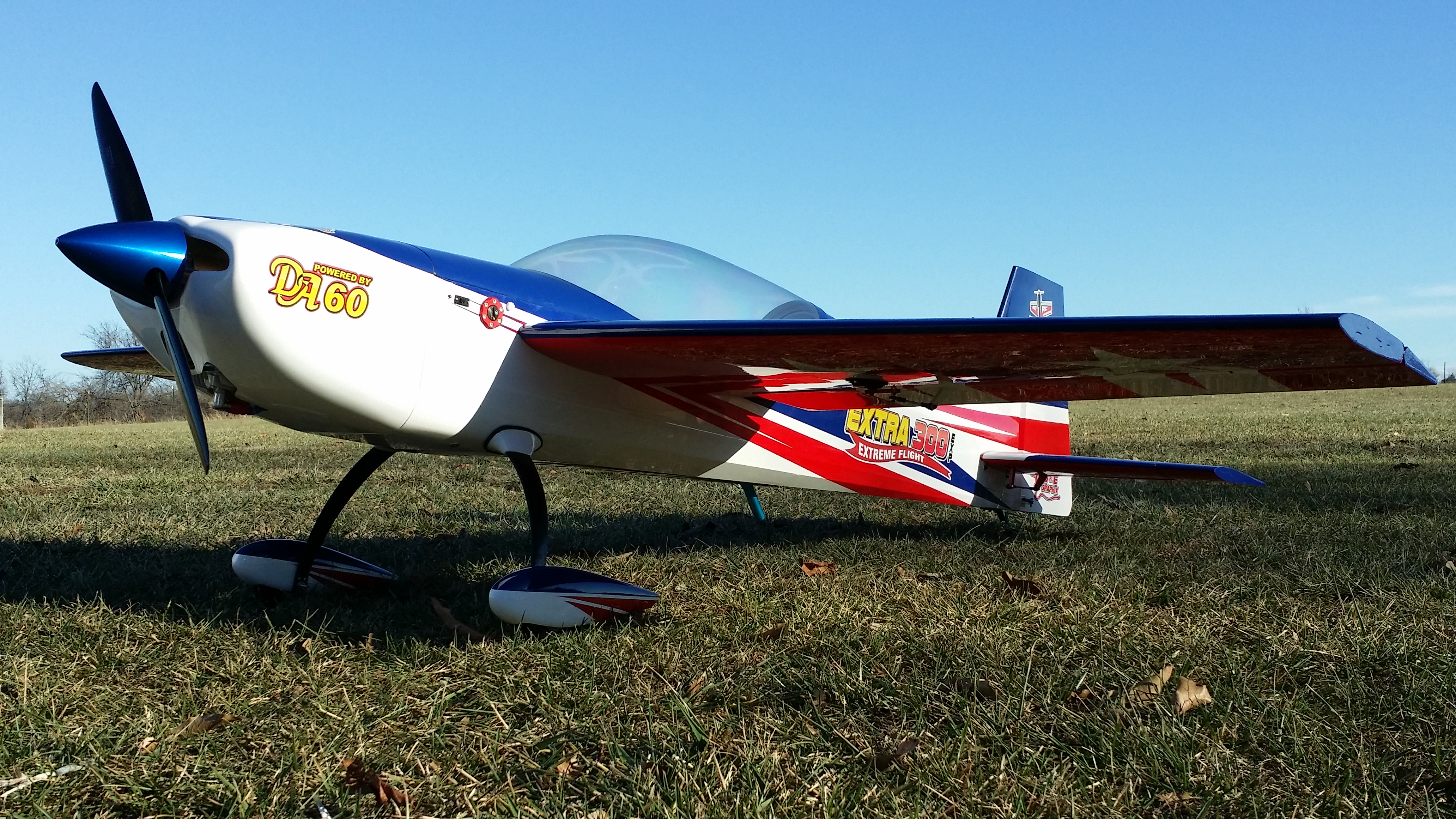

Hi All,
I got really lucky the other day when the 91's were briefly in stock. Got my shipping confirmation yesterday. :grrreat:
I have done a lot of research on the best way outfit the airframe for our flying field.
We have some sensitive Horsie people as neighbours. Noise is an issue that automatically ruled out the DA-70 on mufflers and there doesnt look to be enough room for a pair of cans.
Had a nice long chat with Dave Sullivan (Planebender) and ordered a GP-61 and a Smooth Pipe.
Blazing Star mount
Found an MTW header that was made for the GP-61. (Thunderbolt RC up here in Canada)
Falcon 24X10 carbon prop
An AR9110 with an extra satellite receiver is on the way
Hitec 5565MH on the throttle
100 strand heavy duty extensions. 20 AWG for the elevators and 22 for all others
Going with the recommender SWB servo arms and some blingy secraft adjusters for the pull pull
And here is the plan that isn't set in stone...
Savox 1270TG's for all surfaces
Tech Aero IBEC for the ignition
True Turn ultimate style spinner
32 oz 4titude tank
Fromeco Relions if they need to be in the motor box (CG) or Lipo's if they can be in the fuse.
Maybe a Vess balance ring.
The thing that has me most confused is the brushless vs coreless servo question. Is it worth an extra $25 per servo to get the efficiency of the brushless 2270's?
Thank you in advance for your feedback.
