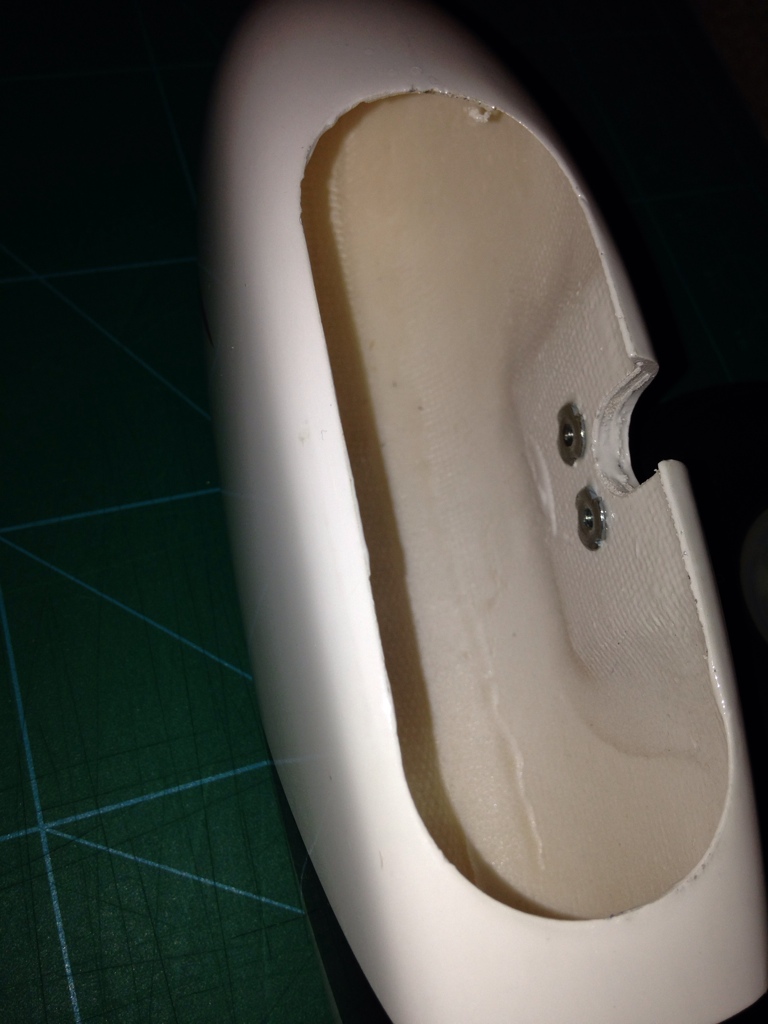

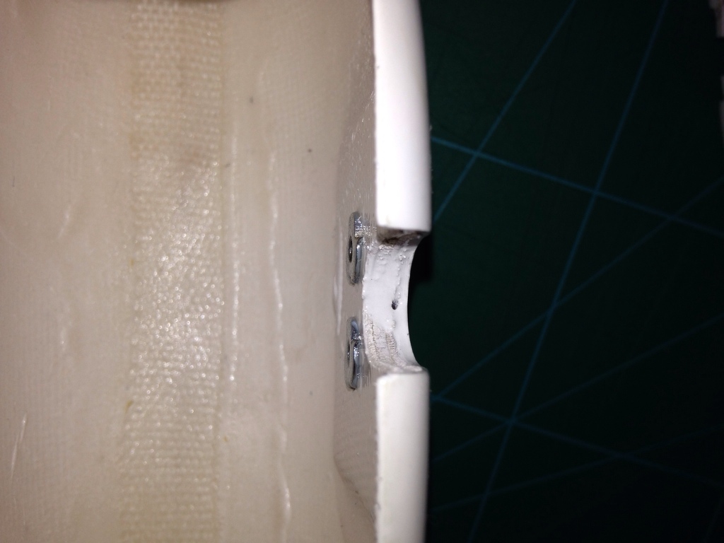

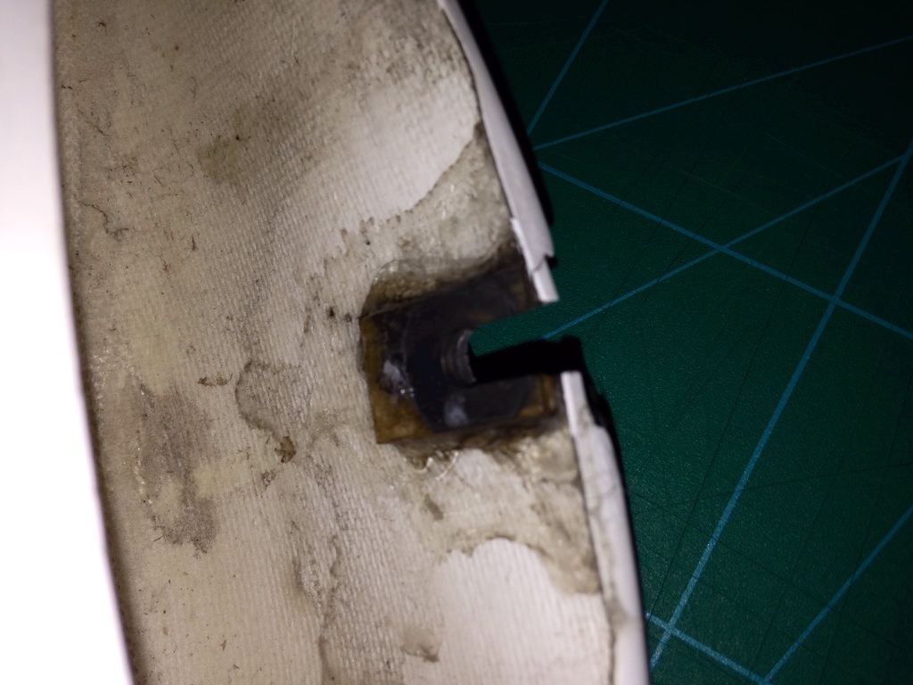

Decided to tackle the wheel pants first. I really like the preinstalled blind nuts in the pants, I think these hold up much better than the big wood screws many other vendors use.

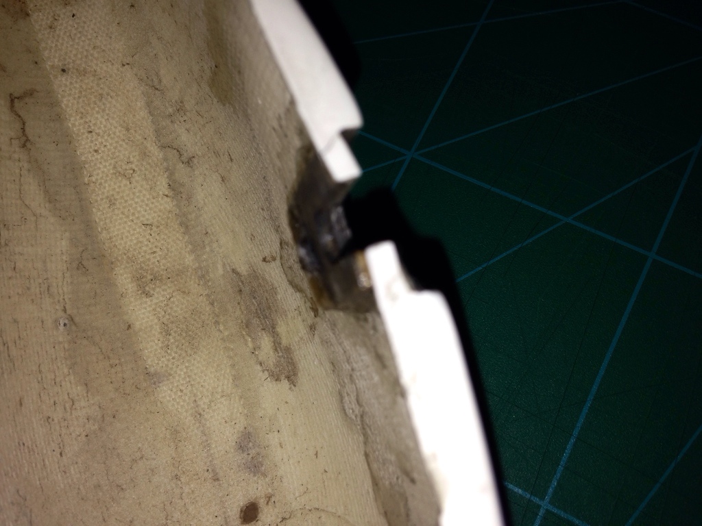

Upon close inspection, these pants are beefy! This makes me happy, as I'm constantly forced to replace the thin wheel pants on some of my other brand airplanes because they aren't made strong enough.

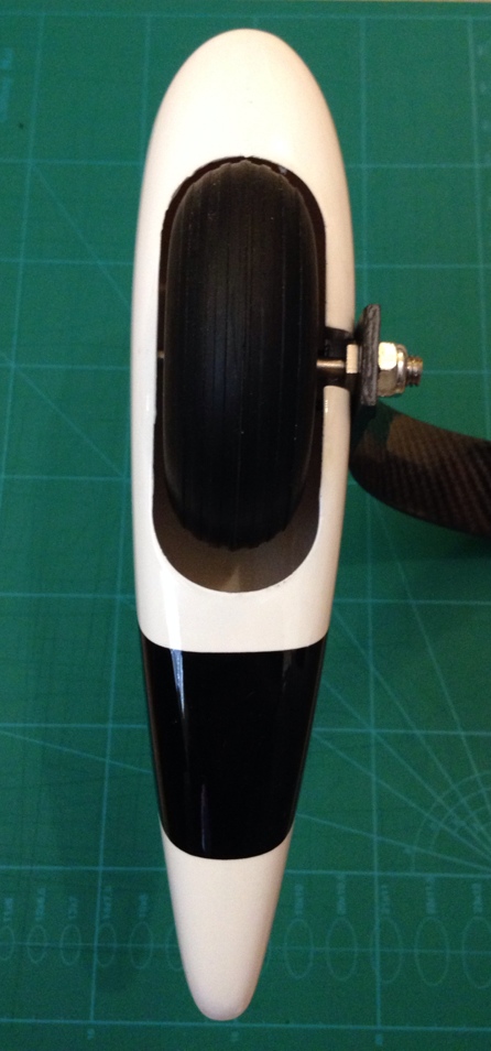

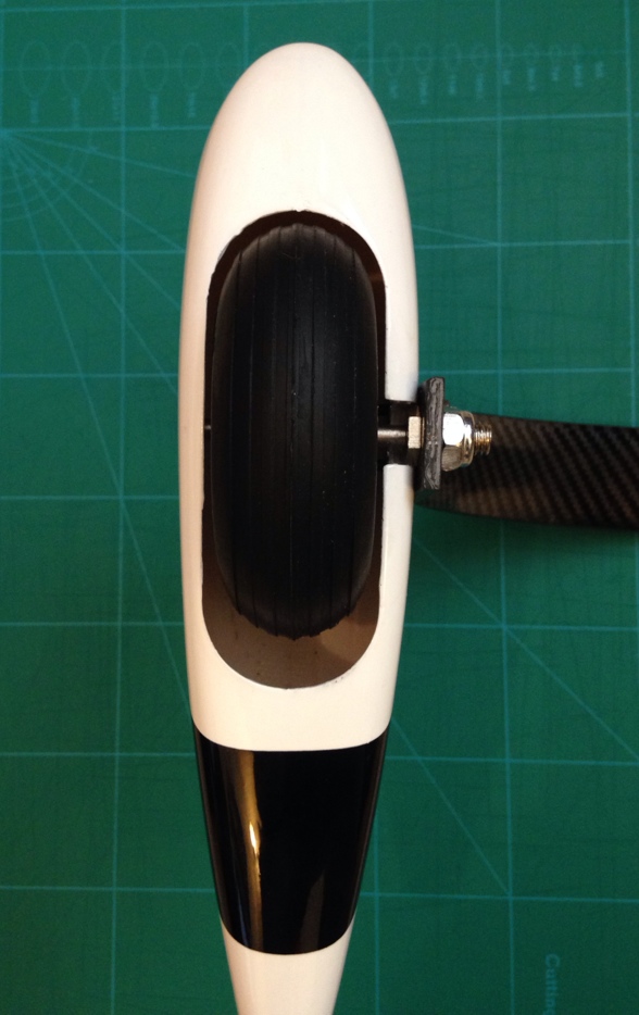

Here are some comparison photos where you can see the extra thickness in the Aerobeez pant at the mounting spot, as well as the better and thicker fiberglass installation.

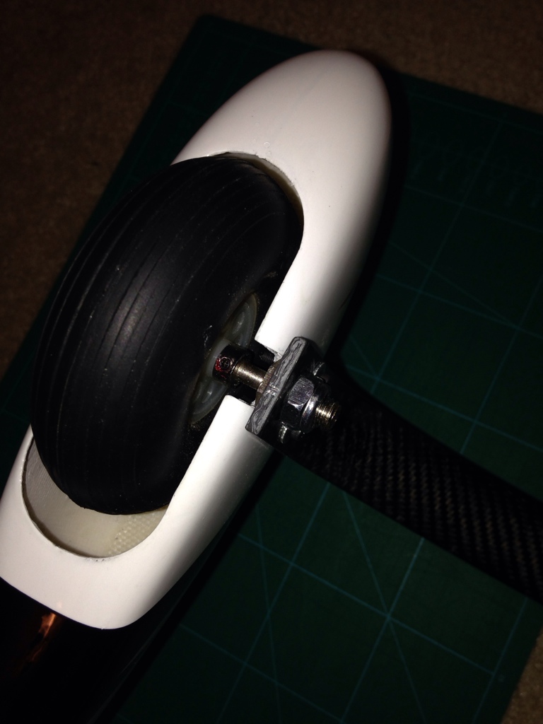

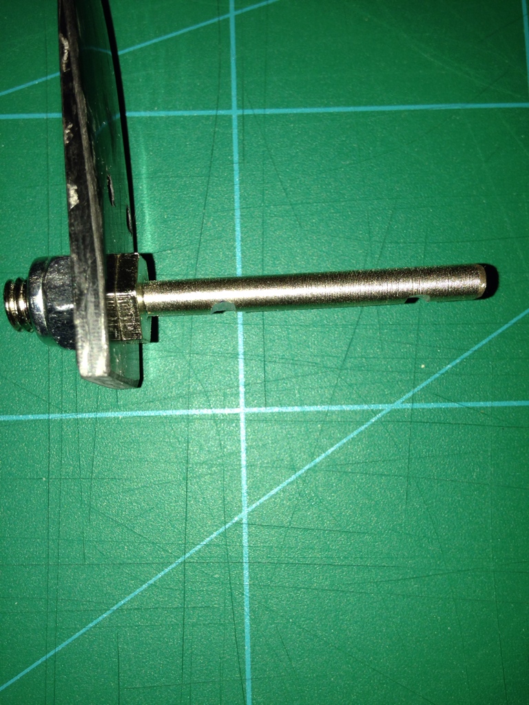

Ok, so first off, I installed the axles on the gear, and then test fit everything.

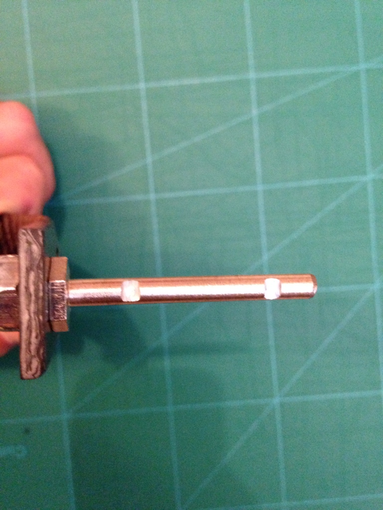

As you can see, everything is nicely fit so there are no big gaps. So I decided to mark the spots on the axle for the wheel collars so I can grind some flat spots.
Off to fetch the dremmel and cutoff wheel. I ground a fair sized flat spot for the set screw to actually recess into.

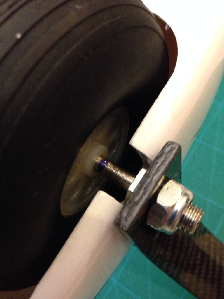

Then I mounted everything up. I used a small dab of red loctite on the screws holding the pants on, and the inner collars of the axles, and I used blue loctite on the outer collars.
All done with the main gear
