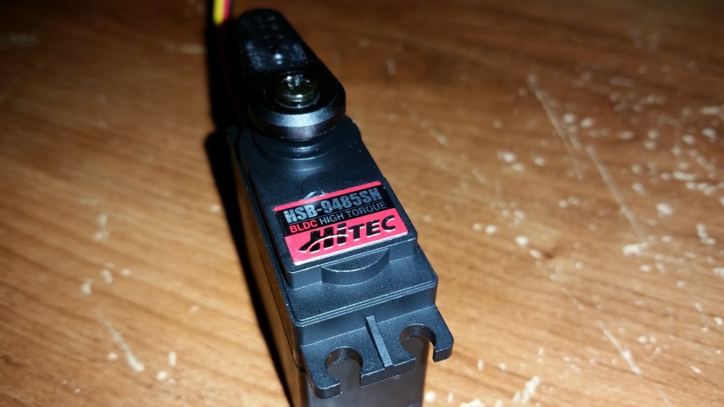

The servos I opted to go with for this airplane are the Hitec HSB-9485SH servos (9465 on the throttle).
These are our more budget friendly, steel gear equipped brushless servos that still feature a constant torque output, lower current draw, and an extremely linear and consistent speed throughout. The 9485 has 361oz/in of torque at either 6.0v or 7.4v, so what voltage you opt to run (be it LiFe, LiPo, or even a 5 cell nickel battery) doesn't matter, you still get the full torque output of the servo. The only changing variable for any of the Hitec brushless servos is the speed of the servo. At 7.4v, the 9485 is 0.15 which is still plenty quick for mostly any type of 3D flying.
Current draw is approximately 1/3-1/5 that of a conventional digital coreless equivalent, and when the servo stalls, it doesn't spike the current through the roof. The circuit is intelligent enough to identify when the motor inside stalls and can adjust the current flow accordingly. Some of the other guys that have been using them have been reporting extremely low current draw and are seeing MORE flights on a single charge- lets me run smaller flight batteries (the Thunder Power 2S 1900 RX packs are what I am using, should still be plenty for a day of fun) and save on flying weight. I'm looking forward to putting them into one of my own personal airplanes for long term use and experience.
FYI, the equivalent conventional digital coreless to the HSB-9485SH in our Hitec lineup is the HS-7954SH. With the 9485's constant torque output, it'll be able to push the surfaces just as well out at the limits of the servos throw. So if you're already running 7954's (or even 7955's) then you can very easily swap to the 9485 and see the same performance, if not better, all the while reducing your current draw.

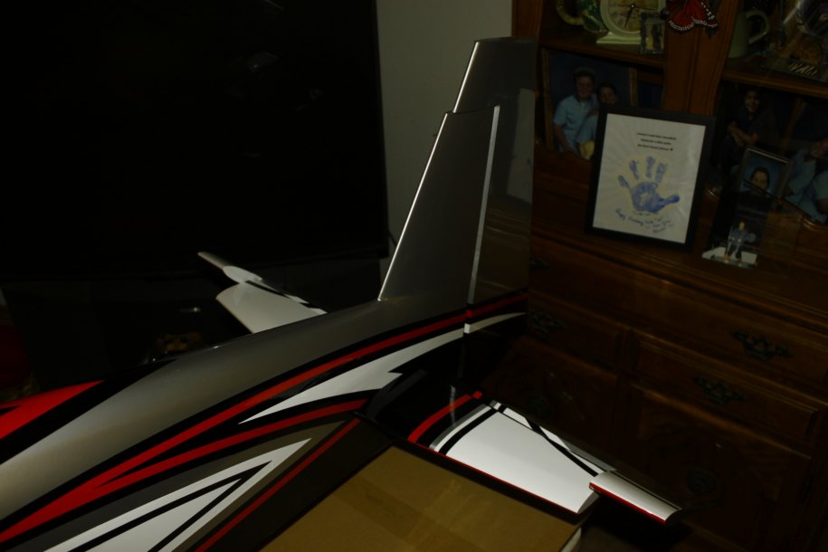

Back to some more assembly. I've sofar done all of the easy steps :D:rolleyes:

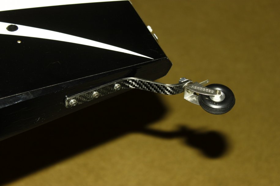

Today consisted of bolting the tail wheel in place- you will have to poke through the covering for all of the bolt holes, but the blind nuts are already installed inside.

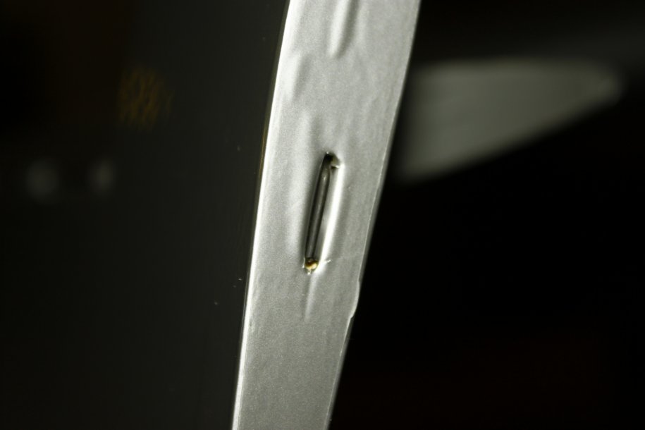

Poke a hole in the top of the rudder for the rudder wire and slide it on through to hinge the rudder to the airplane. Took all of 10 seconds.

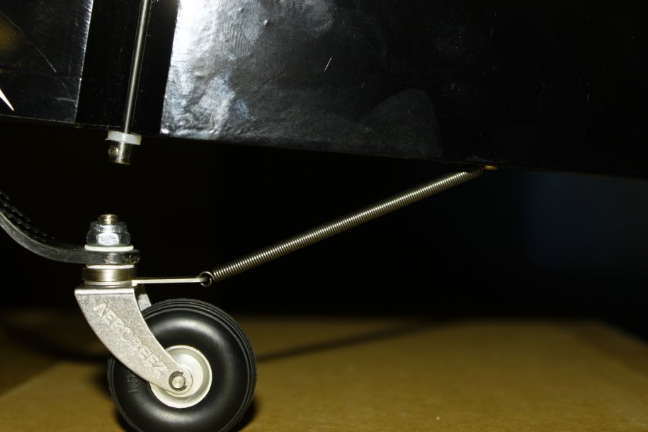

Lastly, I fitted the tailwheel tiller spring to complete the rear gear assembly:
You can also see the retaining collar that keeps the rudder hinge wire in place.
Later on I'll start to epoxy the hinges in for the ailerons and elevator.

Well I spent most of my day trying to tidy up my workshop (it's still a disaster) but at least I got the elevators hinged up and sealed.
Nothing out of the ordinary here. I always dry fit the hinges first and make sure they are ready to go in. Had to trim about 1/16" off of a few of the hinges to get them to seat inside of the horizontal stab properly but once I got that squared away I mixed up a giant mess of epoxy, slathered it on, wiped away the excess, and let it cure.
I used the provided sheets of spare covering to seal the hinges since it matched already.
They fit glovely!!!!!
Up next is the ailerons, then it's just a matter of getting all of the equipment fitted. It's like most of the hard work has been done for you ;)
