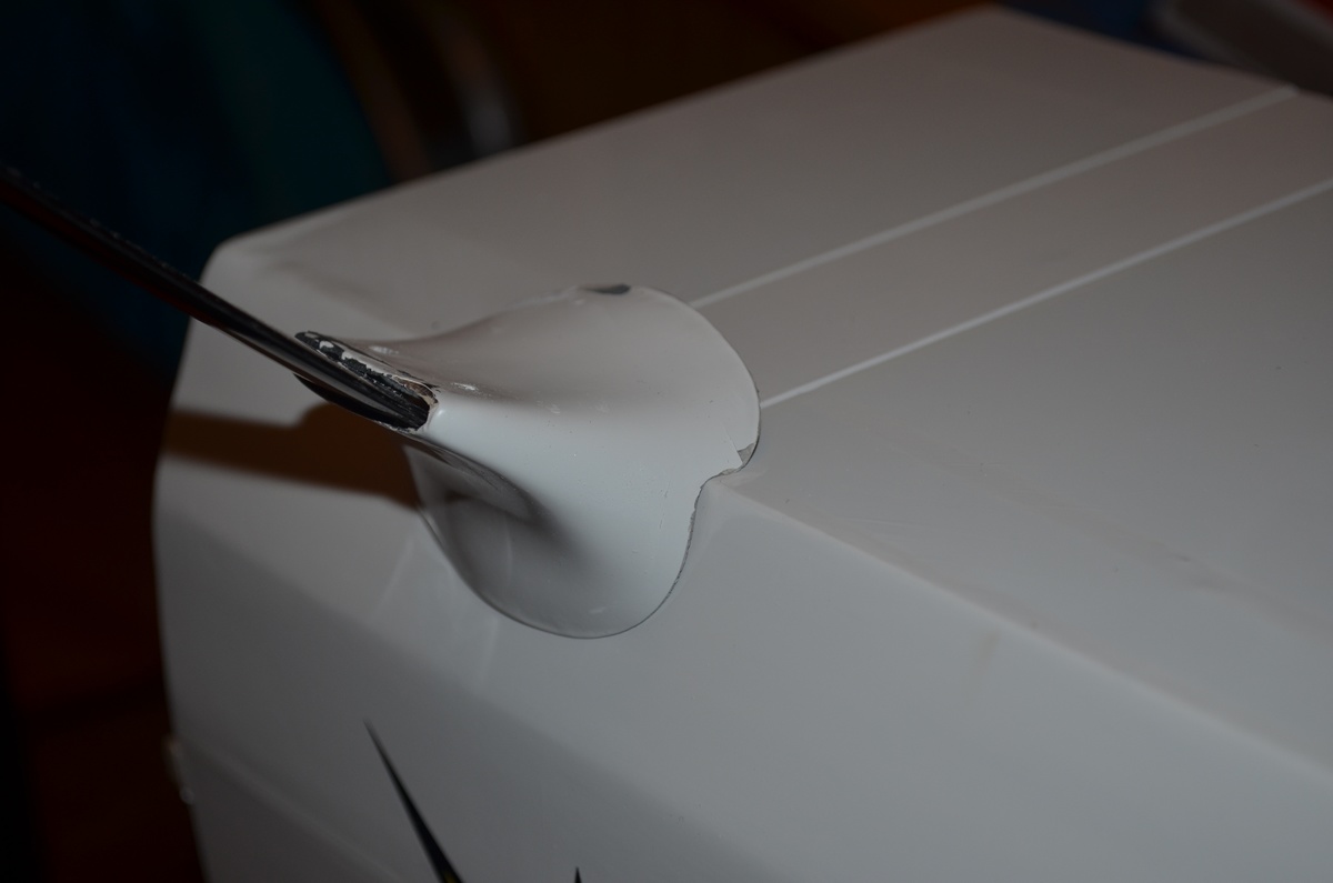

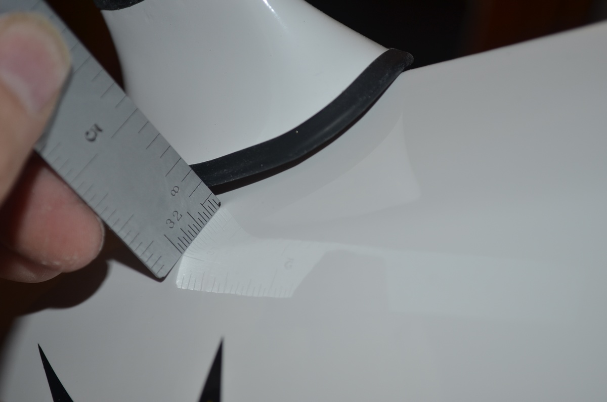

Has anyone tried to make the landing gear cover fit any better?
I cut a notch and reshaped the top edge. I'm still not sure I like them.
I'm considering splitting the side and reshaping the bottom edge too.
Any idea?
AKNick
I haven't installed the gear yet. If you get it too close I'd imagine the flexing of the gear might crack the fairing. Too bad it doesn't fit flush...
I haven't installed the gear yet. If you get it too close I'd imaghine the flexing of the gear might crack the fairing. Too bad it doesn't fit flush...
I think you're right the flexing might cause a problem. The fit bother's me. They just might end up in the junk box.
