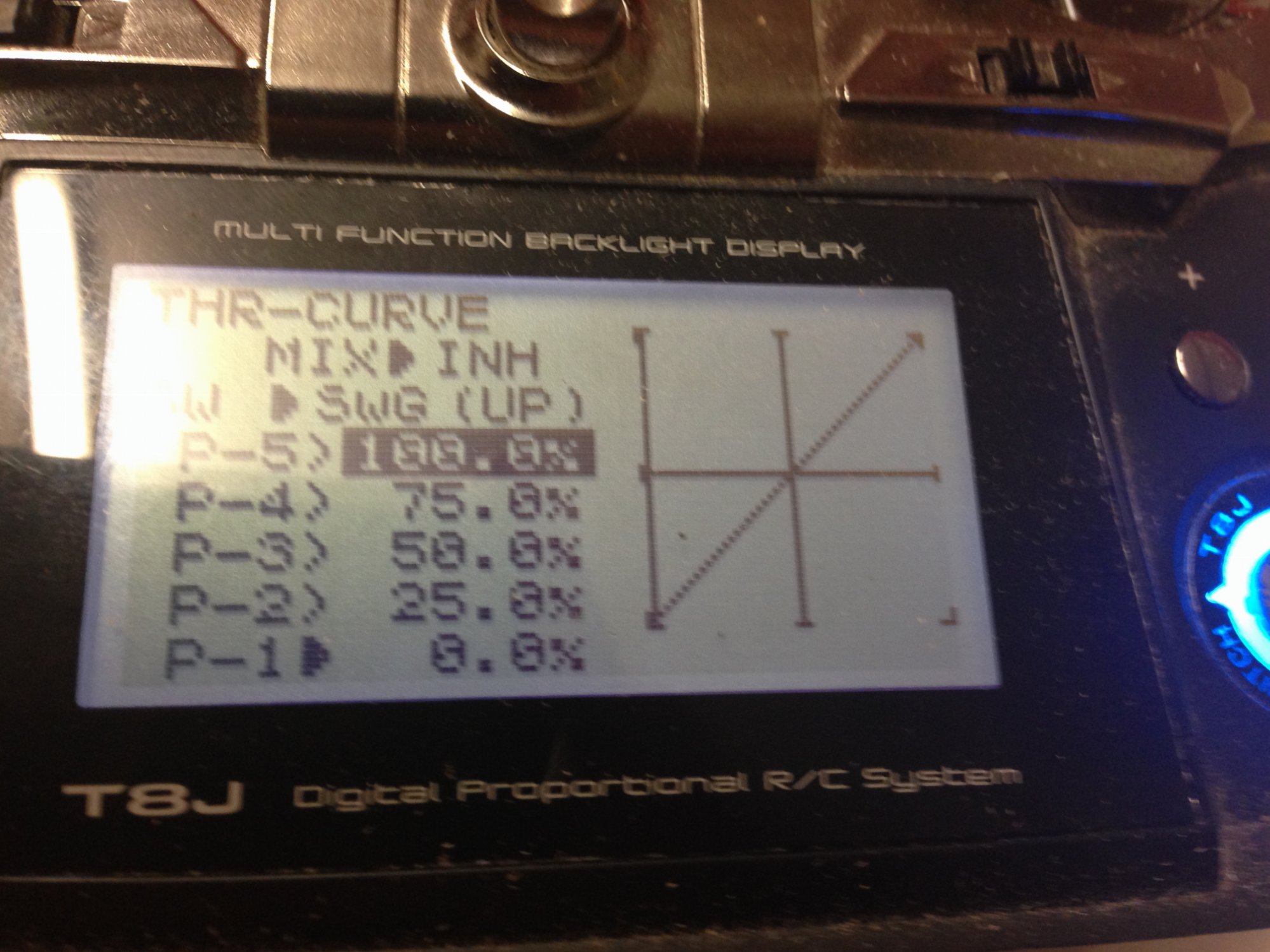

Hope this makes since here. First pic is the throttle curve screen on one of my foamies. As you can see it's not even activated but it's what the screen looks like before you start playing with the curve.

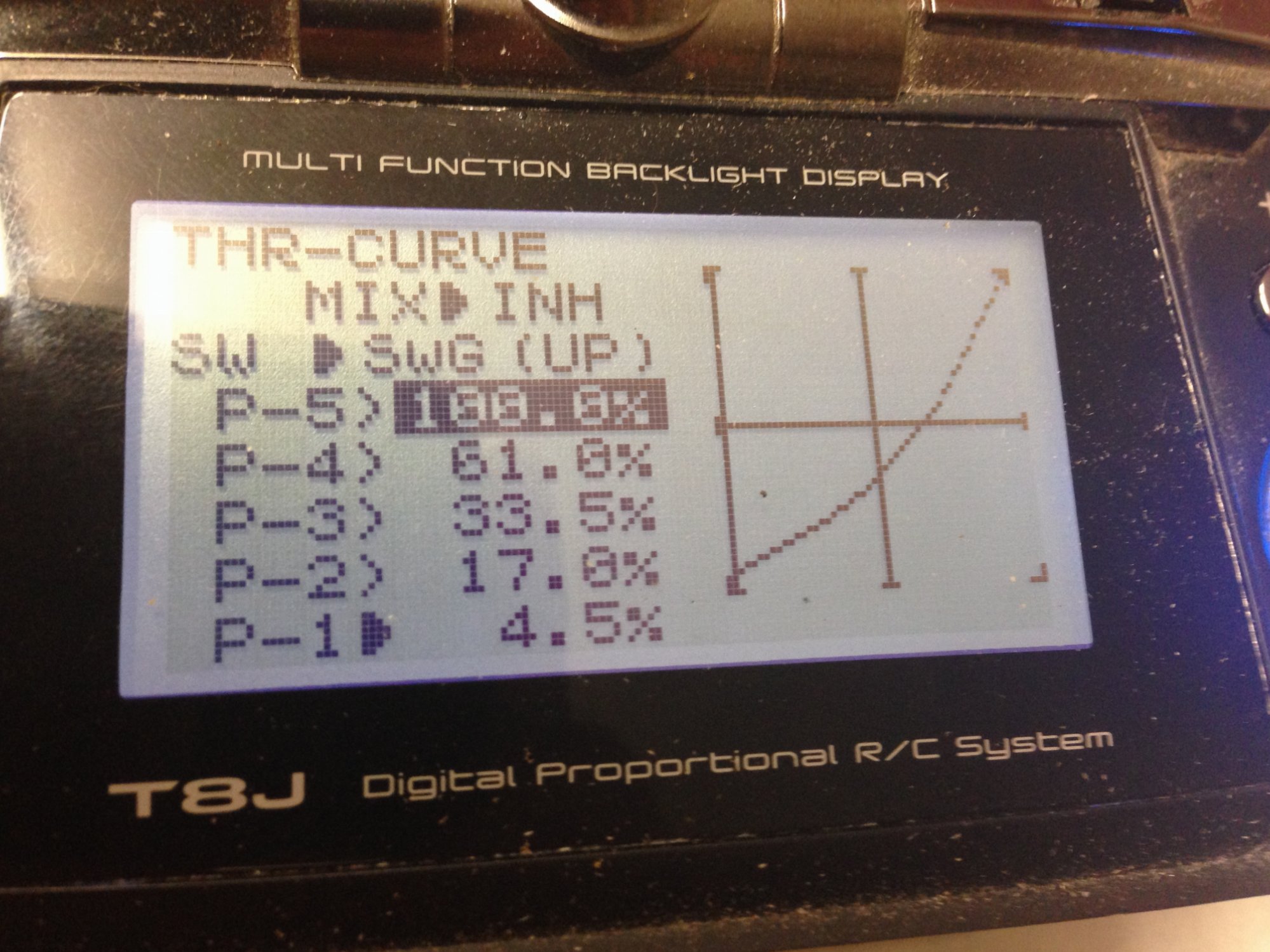

Second screen is from my 30% Carden Cap with a DLE 55 on the nose. Like I said the idea is to get what feels linear to you while flying. Mind you I only have a handful of flights on this plane so I'm still dialing it in but it's a start. As you can see in the left it pass P-1 being idle up to P5 being WOT. If you look at P3 I have it only set at 33.5% meening if you looked at the butterfly in the carb when my throttle stick is at half throttle you would only see the carb as being roughly a 1/3 of the way open.
Hopefully that explains it a little better being able to see what I'm referring too.
