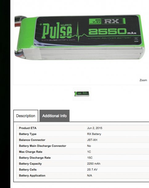

FYI the pulse reciever packs are rated for 6 Chttp://www.pulsebattery.com/batteries/pulse-ultra/plurx-25502-pulse-lipo-2550mah-7-4v-rx-ultra-power-series.html according to the note.
On my 3.1M H9 Sukhoi running a JR power bus reciever I would record up to a 1.5v drop in volage during a snap. Fromeco LiIons were a little higher.

The packs I am using are rated at 1C charge and 15C discharge. See the attached image I just snagged off the pulse site.

That is the link I provided. The 6C receiver pack may be for battery charger discharge only but on the first few flights on a fresh charge I could tell a slight difference in snaps only. Once the initial peak voltage wore off it was even throughout the flight. In fact the lowest recorded voltage seemed to hold steady also. The voltage drop really was not linear.
