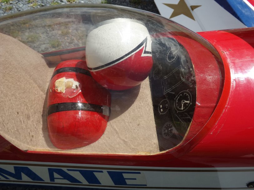

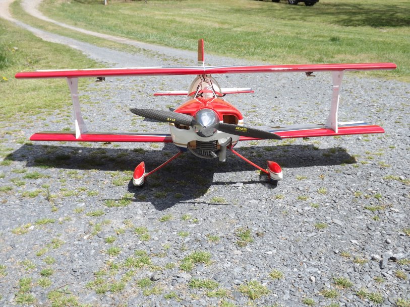

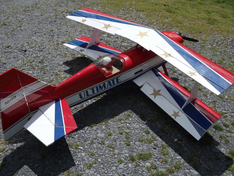

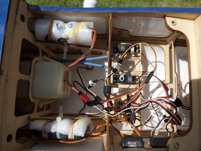

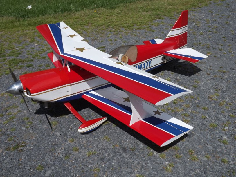

Just look what followed me home, another Bi plane. DLE 55 8- ds821's and 2 standard on throttle an choke servo(ditch choke servo). I'm gonna change it all to the gear from original Bertha, switch out the landing gear which is a MUST, different wheels (whatever I have in shop) and got to get into canopy some how, the little nascar pilot got his neck broke. Switch out prop, 21x8 mejzlick????? on a 55

Seriously on the canopy issue I did the 4 screws and the red pin striping around the edges. Matched perfectly and can be pealed off and reapplied if access is ever needed to the flight deck. In my humble opinion it also finished the canopy off real well. Let me know and you can have some of the striping. (I have enough to do a 100 canopy's!) :LOL_gif:

Canopy shouldn't be to bad. I think he used canopy glue 590. It fogged up when I was cleaning her up a bit, so its not glued down completely,gonna see what my Pit Bitch thinks, if all else fails I'll use the one off original Bertha, its screwed on like your's. You know Snoopy got to get back in the cockpit.
