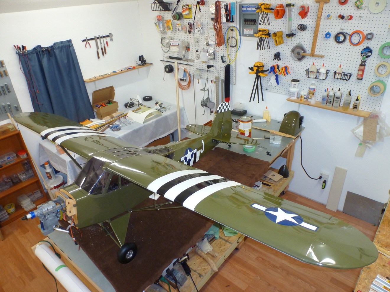

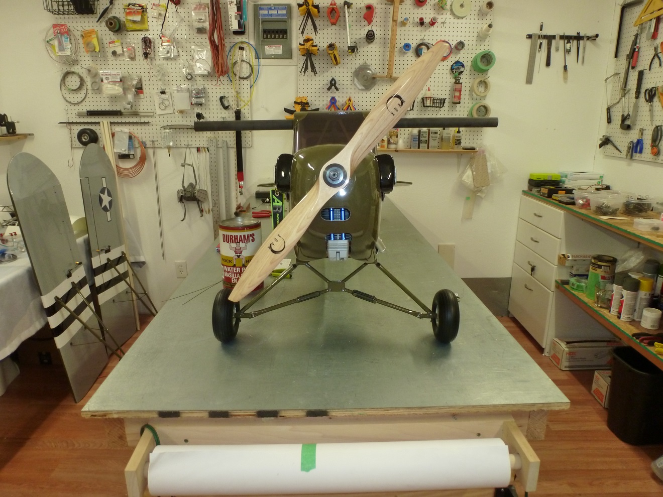

This morning it dawned on me, regular clevises won't work because of rotation. I have plenty of ball links sooooo, all surfaces are hooked up and adjusted. Carb is hooked up via a pull cable, first time for me for this method but a rod was not feasible. If the rudders offset servo arm and fuel tank shows up tomorrow it will get finished by end of the day.

Looking good that did not take long. You are almost ready for the next one.
Thanks Snoop! Only two days of work Wednesday and today, not bad, but also a tribute to the simplicity of the kit. Next up is going back, being I am still waiting to hear from EMHW regarding the new gear, it is back to the stripped Challenger and finish it up.

Looking at the pictures closely it looks like you have nice little four stroke hanging of the front. Put a plane together a little while back for a friend and installed a Gaui 50 cc four stroke just a beautiful engine started it up for him and set it up really like the engine. But that is all I know he flew it once and I have never seen it again. Looked at the OS 40cc four stroke but had the misfortune of a fellow that had one and asked me to help him with it could not get it run right. He eventually sold it.
acerc
Yep, it is a NGH 38cc. Have not run it yet but from research they seem to be good engines.

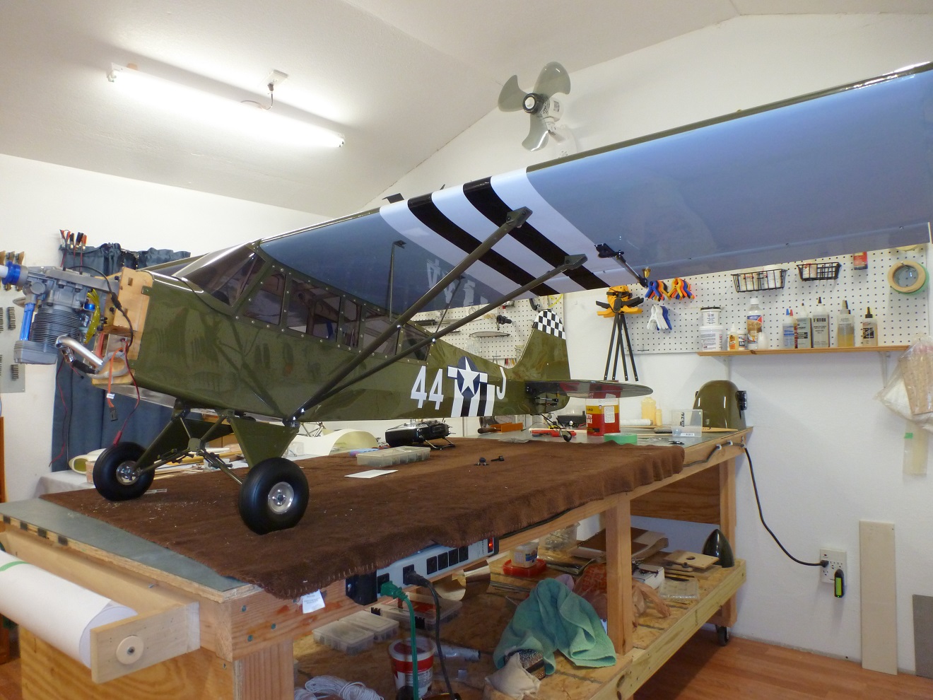

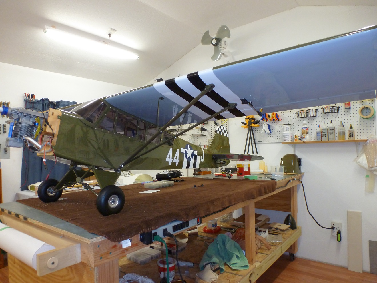

Nothing to do because of rain so I went ahead and attached the tail wire brackets will connect the wires when the clevises get here. Also fitted the cowl, it need's a little bit of cleaning up but otherwise it is done. I am going to see if I can find one of those silicon extensions for the exhaust pipe as it is real close to the side of the cowl and will make a mess down the side of the fuse.
