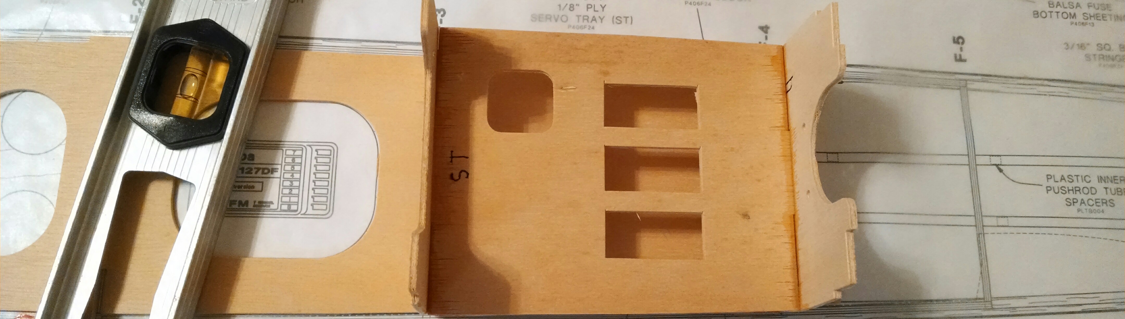

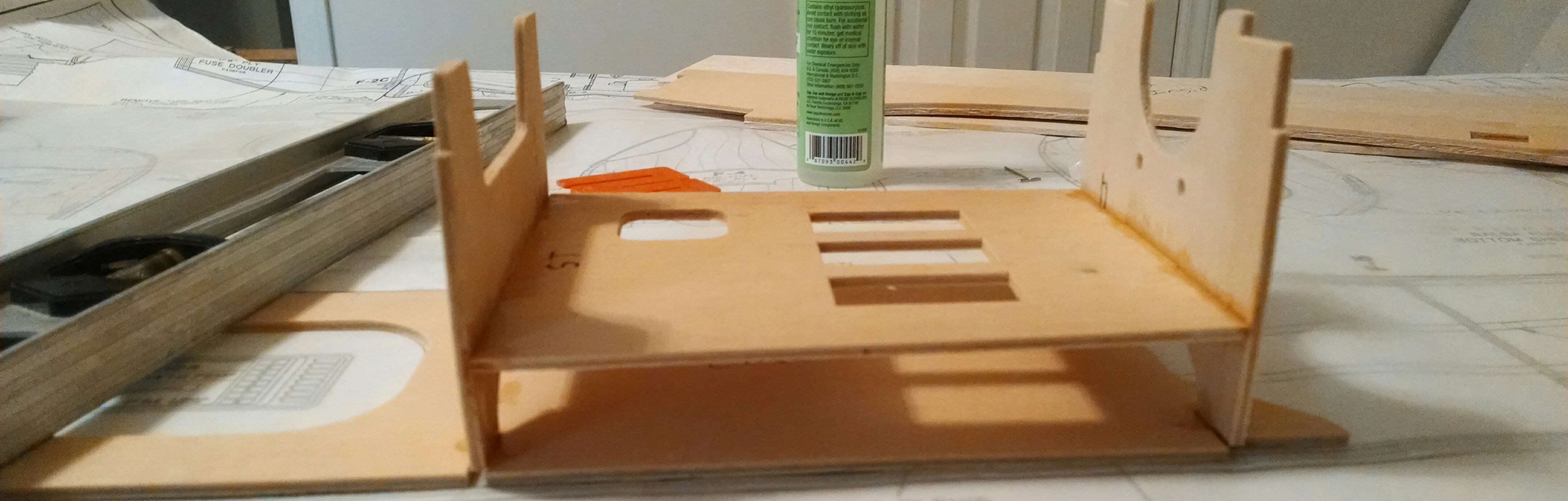

rcdude07
Man is it though to get 2 plywood formers perpendicular and plywood servo tray glued together on the base when your toddler is being antsy. But I managed to do it, albeit with the help of ca kicker (which I don't like doing).

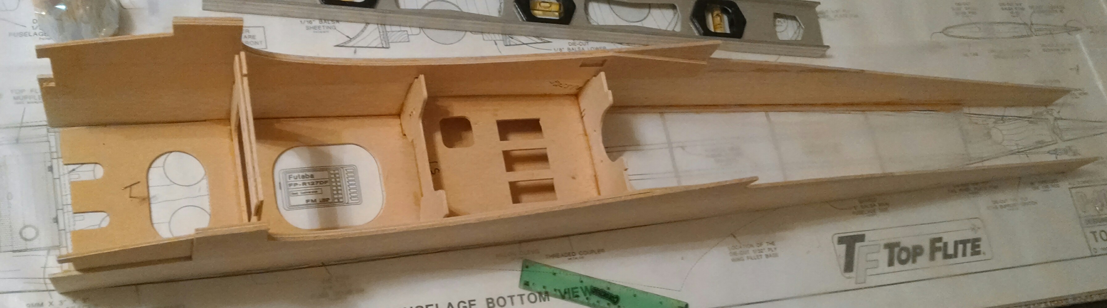

rcdude07
Former 2, former 2 doubler glued in. Fuse sides tacked on. Done stringers on the back of the fuse too.
