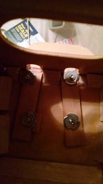

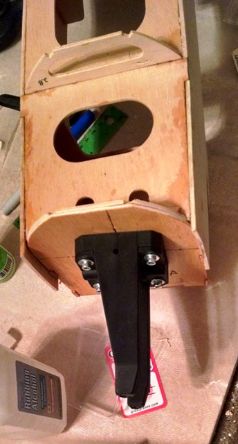

Got the motor mount mounted this morning before everyone was up and having to go to the office. I had to open up the top die cut holes a little bit to allow the blind nut to fit as well as glue in some smaller pieces of extra ply where a few blind nuts weren't going to bite the plywood reinforcement pieces.

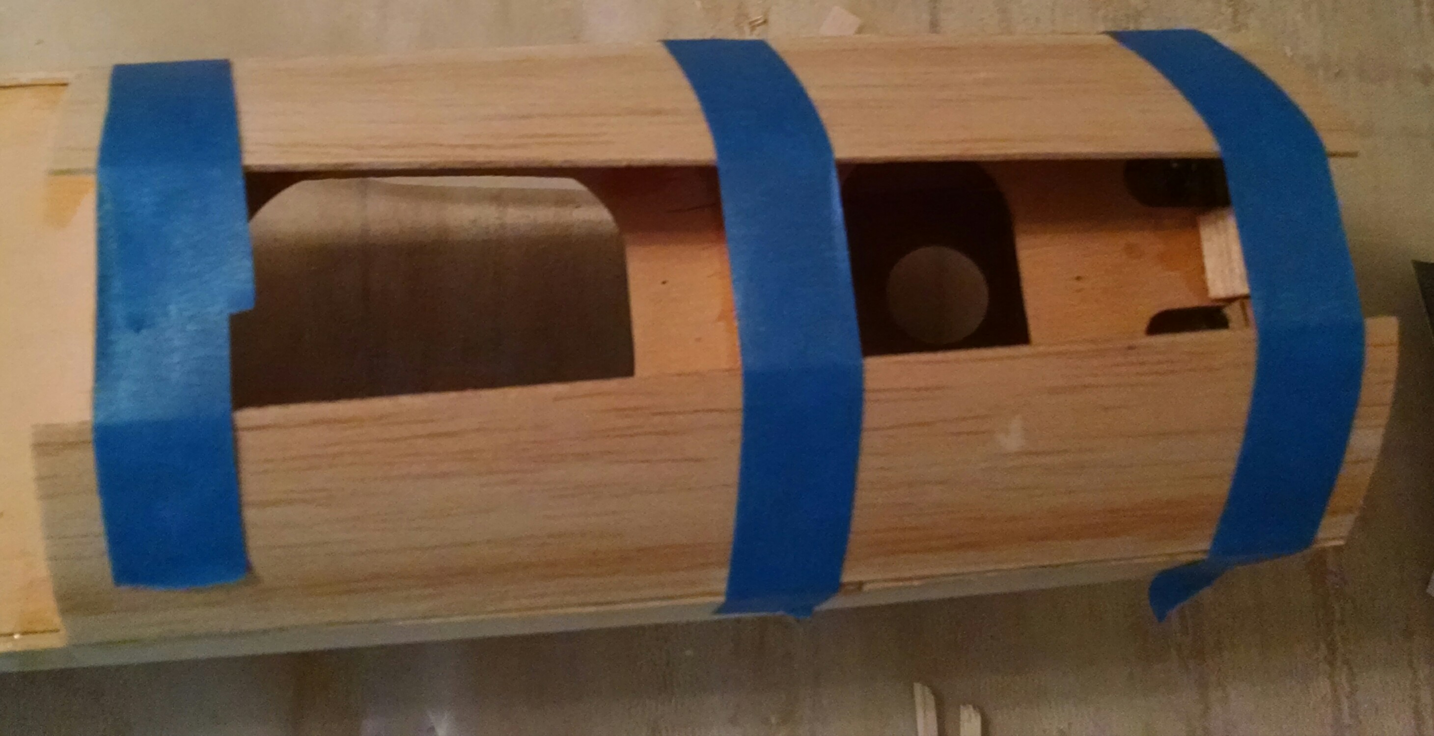

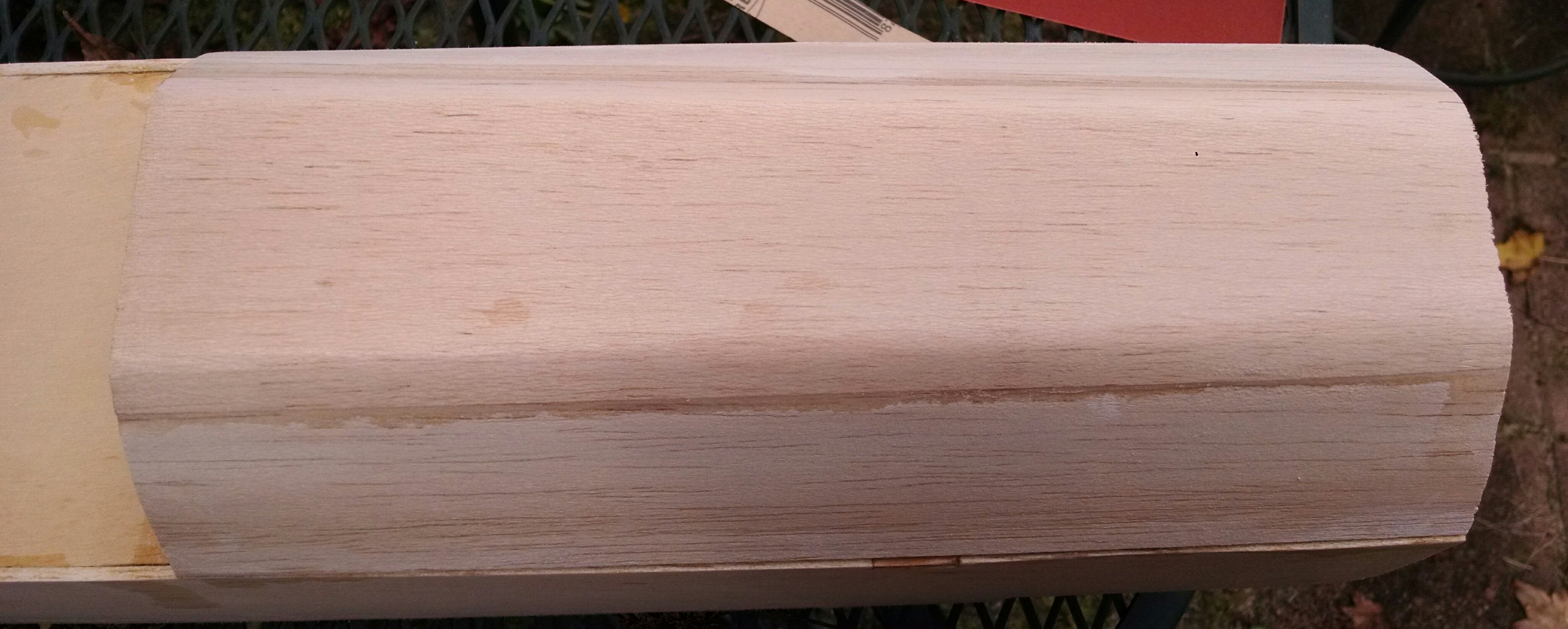

Finally was able to get a reqlly good chunk of uninterrupted time today to work on the next steps of the P-40. I was working with sheeting and curving the sheeting, so I had to wet it, hold it in place at sections at a time to allow the glue to set. Once set and the wood dried enough I had a fair amount of sanding to do. Next up is to roughly shape the top deck, which transitions from relatively flat at the canopy to almost completely round at the firewall.

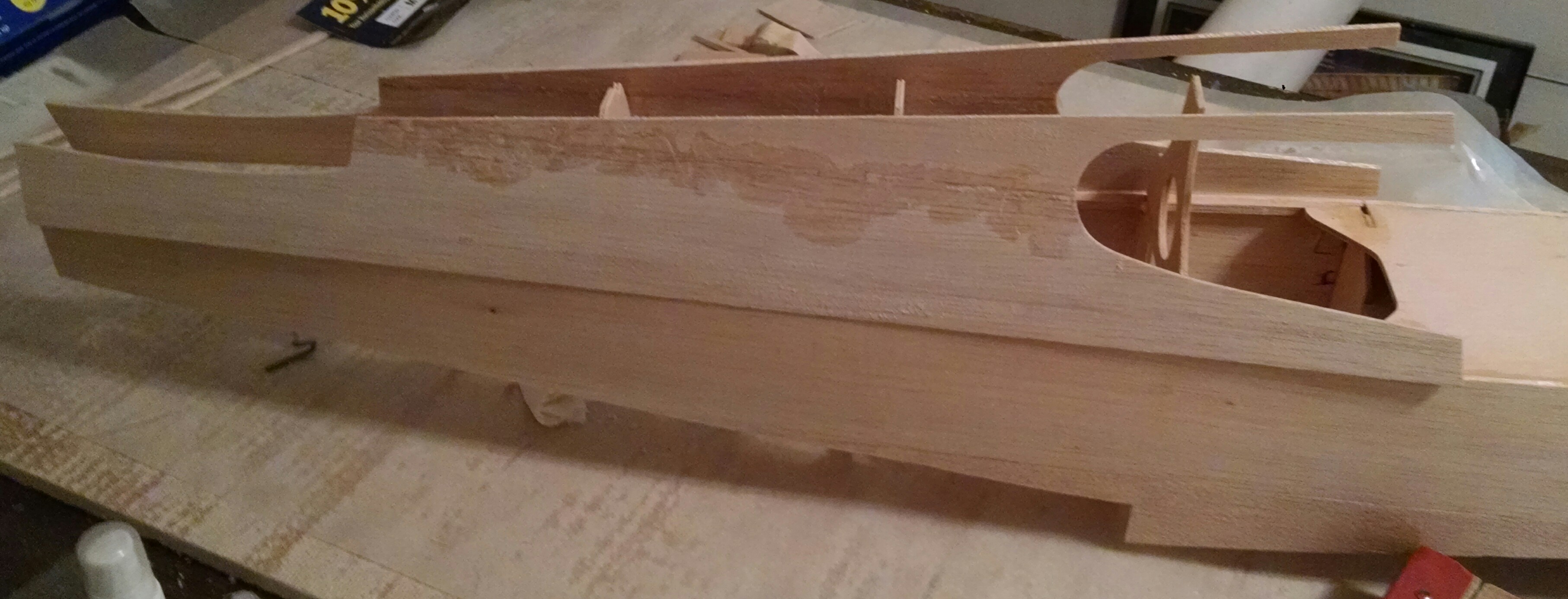

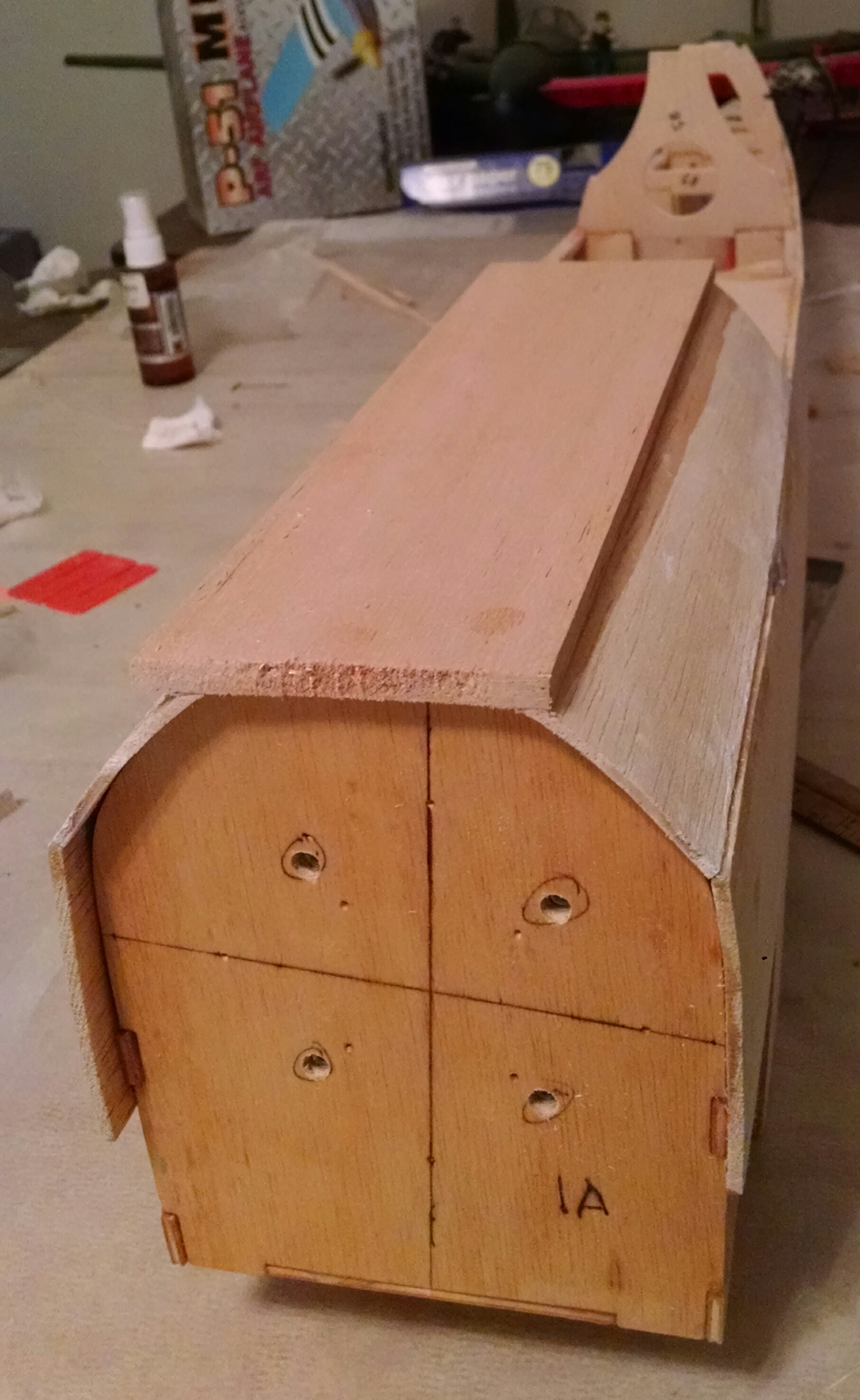

Top deck sanded and roughly shaped as well as the top aft fuse sides glued together. In the pic below they are just loosely sitting in place for effect.
