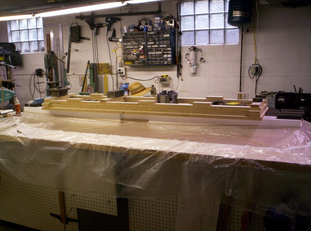

I'm using two 36" wide solid wood doors, 3' x13'. The surface is leveled on a steel frame bolted to the basement floor. It might not be perfect but it is surly close enough. The attached photo is an eight foot one piece wing in the vacuum bag with room to spare.
