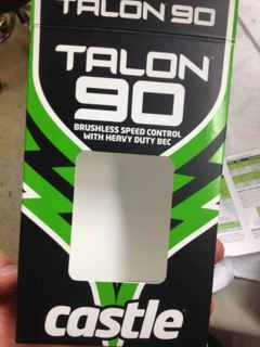

Here is Castle's answer to the one servo wire.
