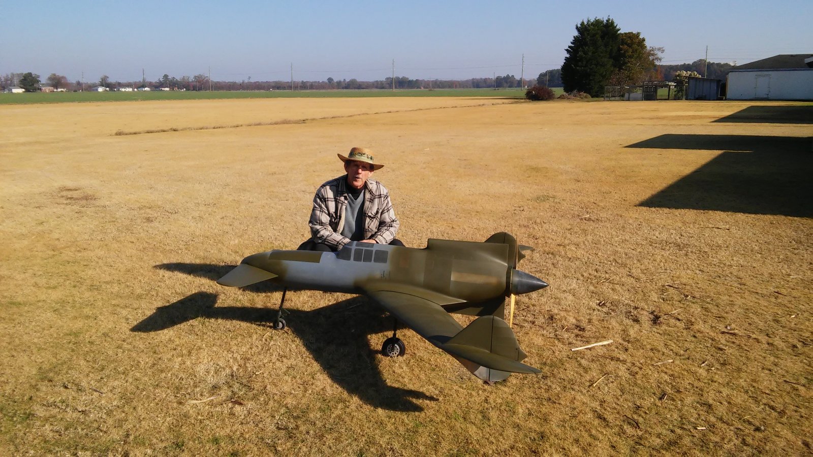

Well today was flight #4 and it was an exciting one! We did get a good video of the flight and the lucky landing. I moved the CG back just a bit, the spinner back plate and some paint were added this flight but boy did it seem to make a difference. The elevator was really sensitive and the model would not find a happy trim for level flight. I ended up chasing the thing around the pattern trying to get it on the ground in one piece.
I think it's time to set a new low rate for the elevator and move the RX battery back up into the nose.

Finally got the landing video posted of flight #4 on You Tube, man that was a handful of airplane. I know it looks like I am really being "ham fisted" on the elevator but Abe said I was just touching the elevator.
I am moving the CG forward just a bit and installing a Futaba single axis gyro for the next flight.

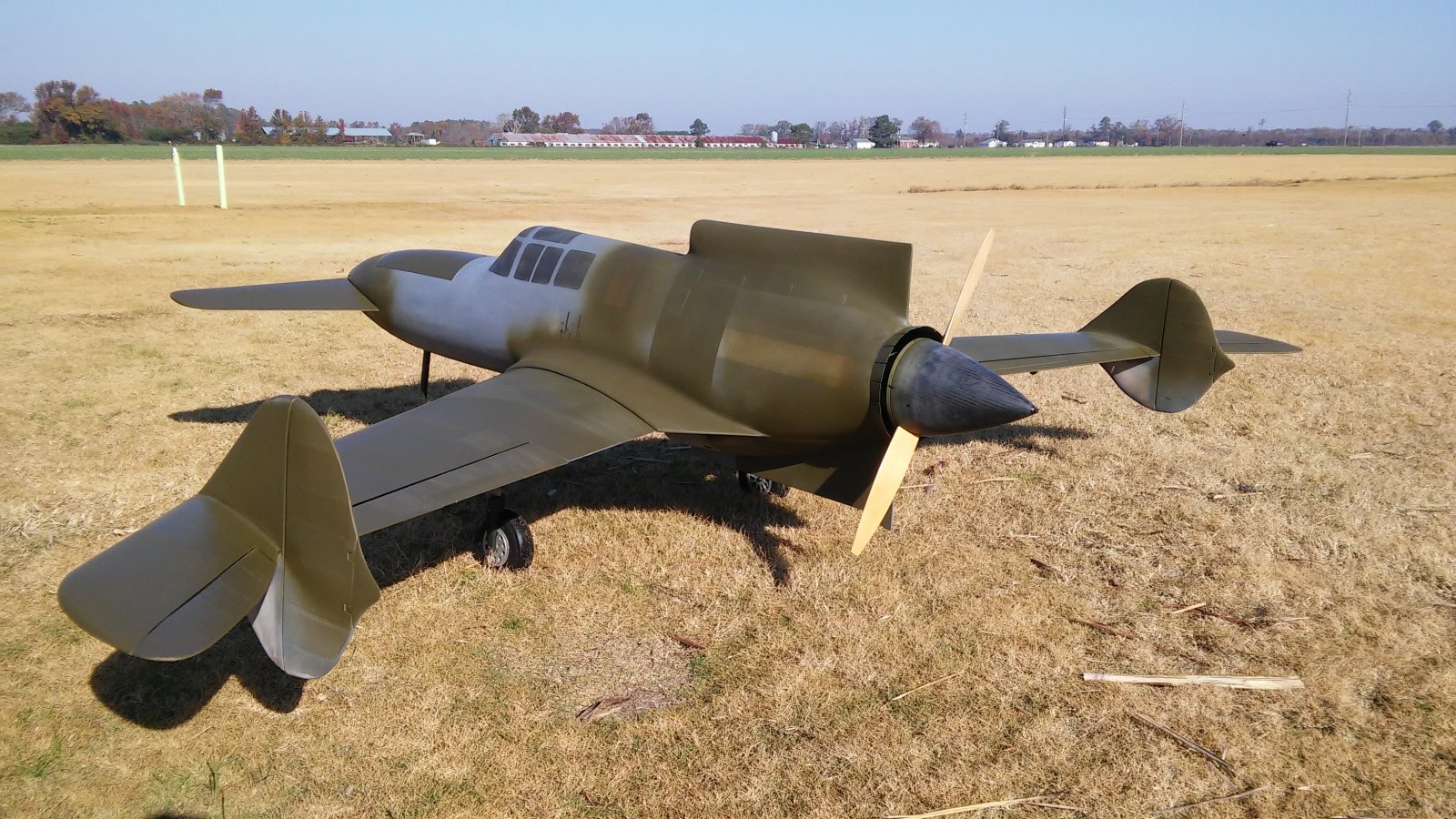

Yes! Flight #5 was the best one yet. I moved the CG forward just a bit, installed the nose gear doors, and most importantly installed a Futaba GYA 430 single axis gyro for the elevator.
It was like a whole new airplane, NO crazy pitch tendencies. I am still thinking I might move the CG aft just a touch because it still seems to be taking quite a bit of canard throw for a normal pitch response which tells me it might be just a little nose heavy still.
My friend Bobby took a video on his phone which I'll ask my wife to up-load on YouTube in a few days. When you compare flight #4 to #5 it looks like a different model, gyro's are a wonderful thing!
Now I guess it may be time to actually finish the thing, or maybe I'll get one more test flight on it just to make sure that it was not a fluke.
