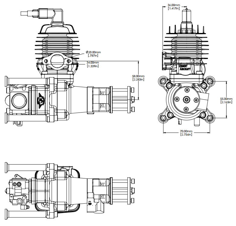

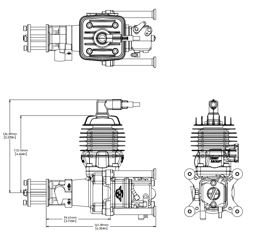

Does anyone know the distance between firewall and prop adapter including the mounting studs ( or whatever they're called) on a DA 35. Trying to see how big a job it's gonna be for me to convert over. I'm currently at 6 and 1/8 inches from firewall to back prop plate.

Here you go Blewis
