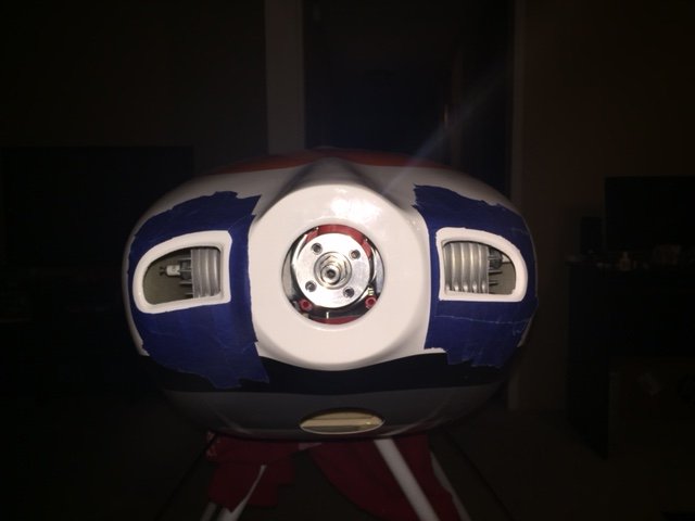

Started on the next 70 install need a little advise, This is a 3DHS 89 Slick V1 that I rebuilt, the openings on the v2 cowl that I am using are smaller than the V1, I am slightly worried about cooling issues, I marked this on off to cut it to match the old cowl, It has to be split and painted so not worried with how the cuts will look, This will be baffled and my question is dose any one think I need to open the front or does this look like it will allow proper air flow?
I would open it up only about half of what you outlined with tape. Make some decent side baffles as well as lower to get the air directed on to the cylinder. Not starting a war here but I personally have found that an exit opening about equal to the inlet area works fine as long as a "drag lip" is installed in front of the exit opening. Since you are doing work to the cowl might want to try a couple of those pre fab louvers that vvrc sells. I am going to put a couple on the top of my 330sc.
Success to you and your rebuilt Slick ;).
emtp275
I did not end up opening the cowl and it seems to be doing good with baffles and plenty of exit space, but that being said in have also been flying in 40deg temps.
