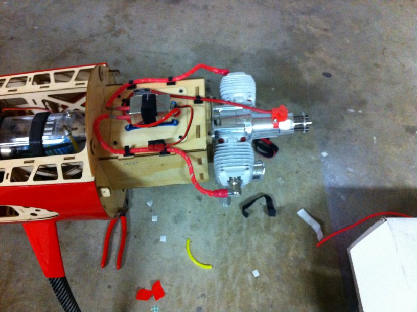

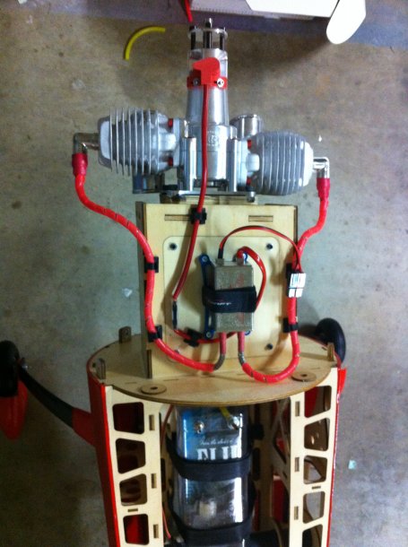

Ok Ohio, here it is.
I have one of these bad boys in my EF 91" yak.
this is what i did:
the power pole connector has another end and that hooks up to the power supply via whatever (kills switch/ignition battery/IBEC/Optical/spark-switch, etc...).
what I did was obtain a JR type plug and used a crimper and made my own connection. This plugs into my IBEC and it works great.
I do not know if it would void your warranty, but in general, anything that may one day end up going back to them or if you want to sell, it is best if you leave it in the stock condition.
