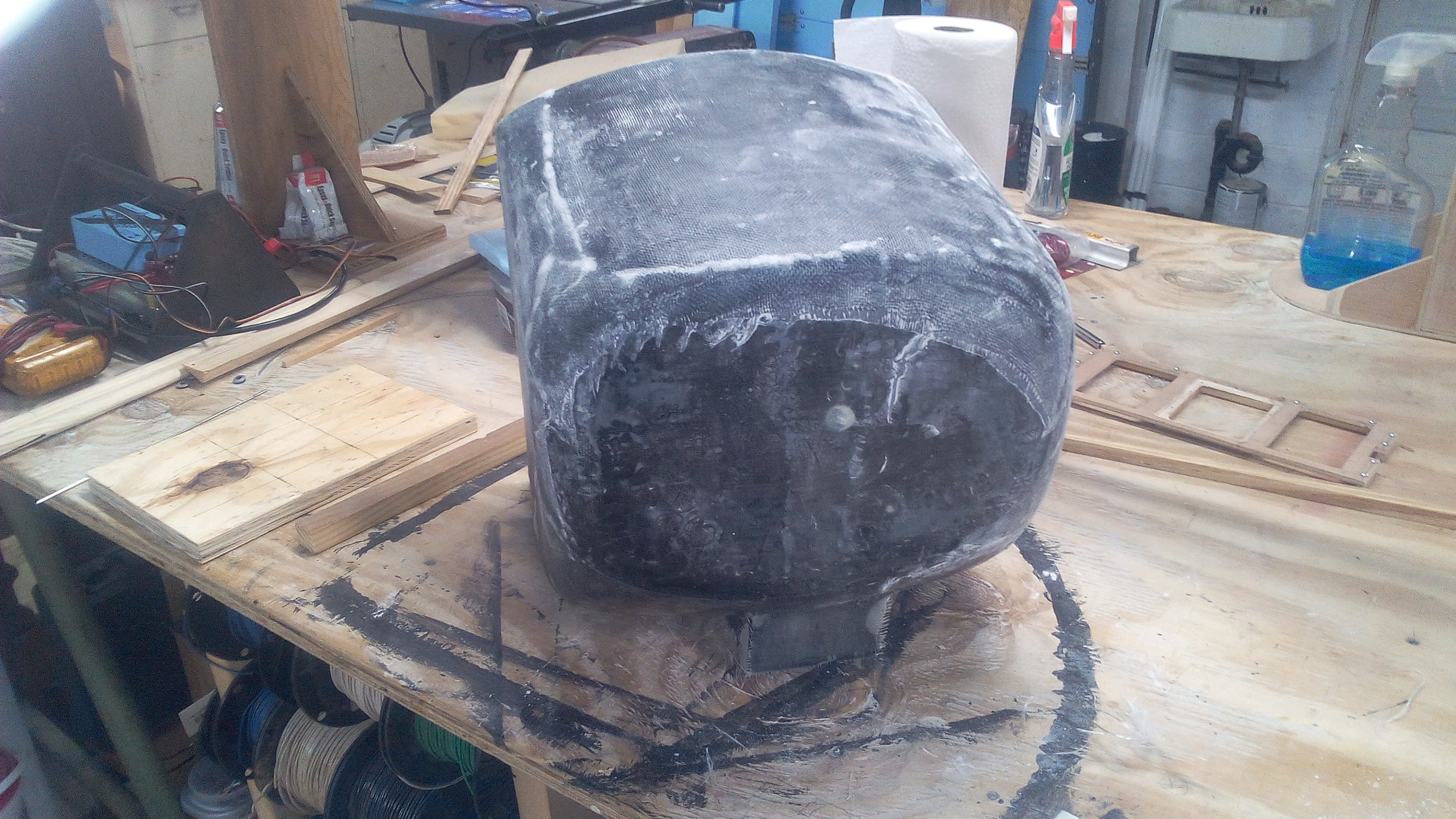

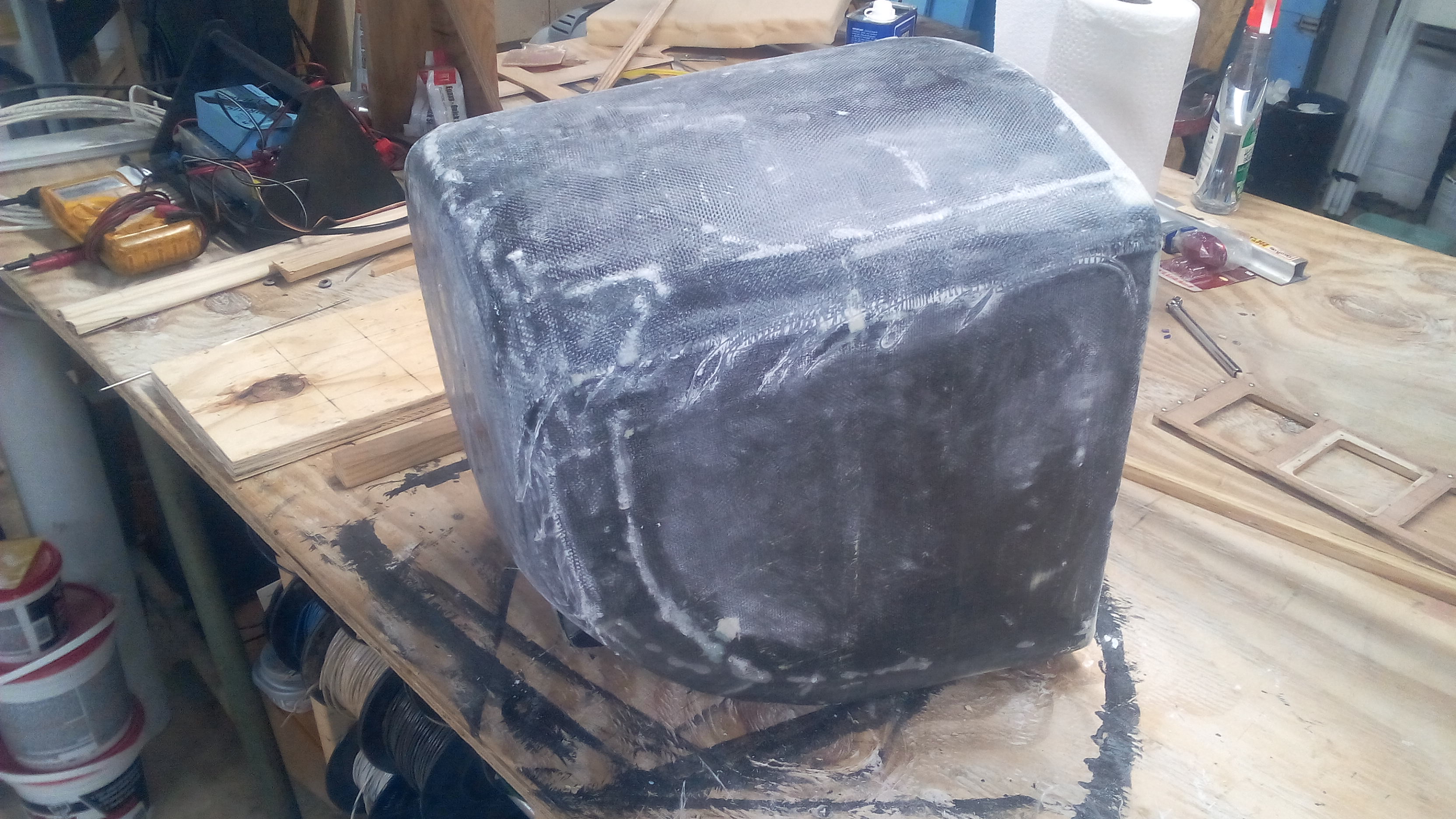

Cowl ready to be taken off the plug, once I have removed it I will glass the inside with 6oz cloth. Out side will then be filled and sanded,more filling and more sanding

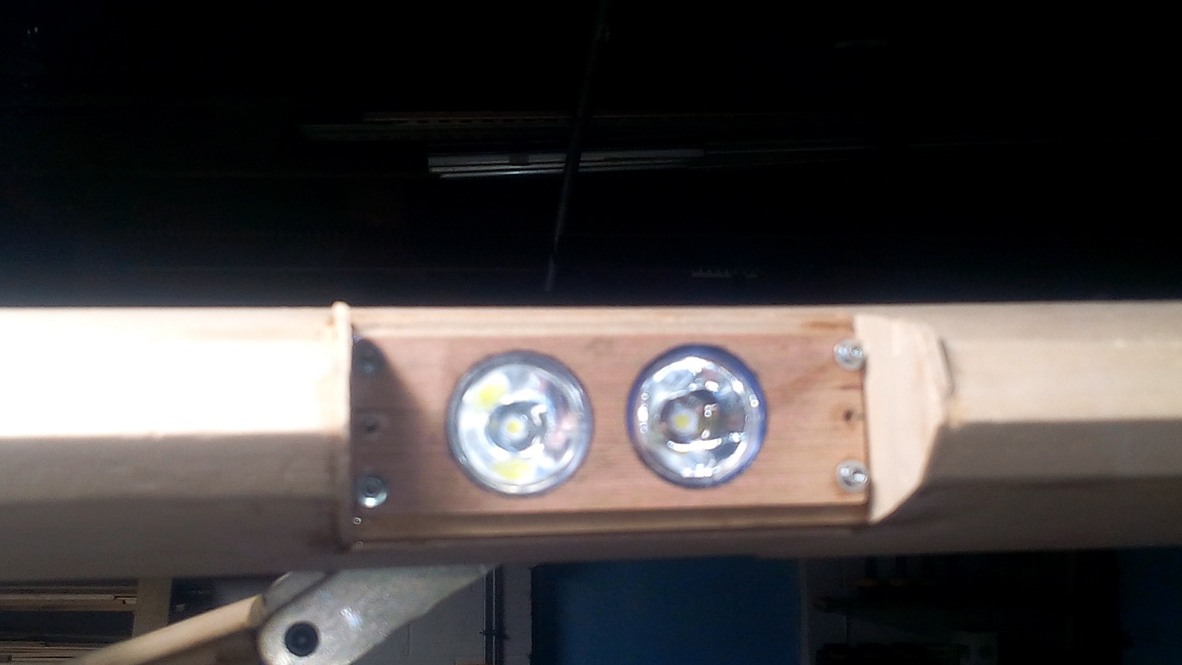

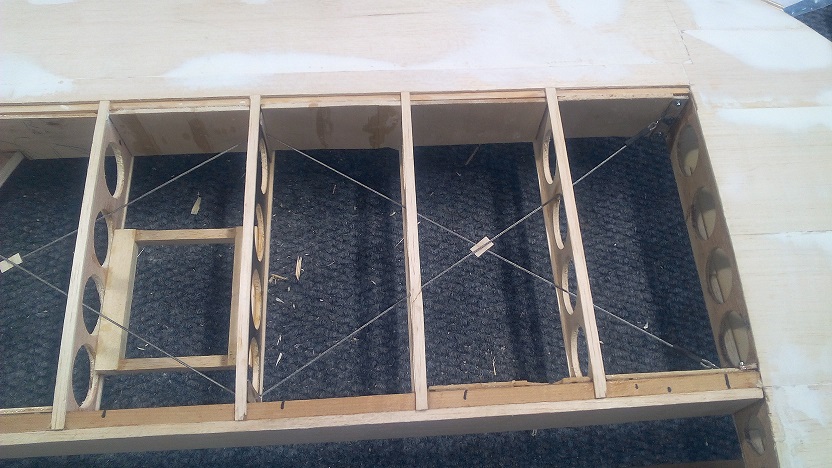

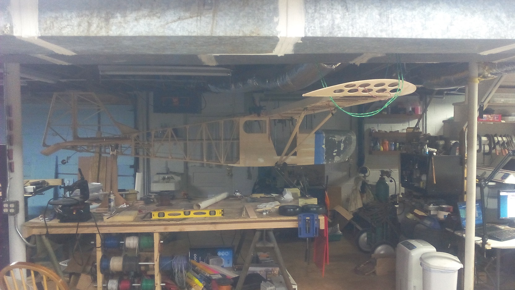

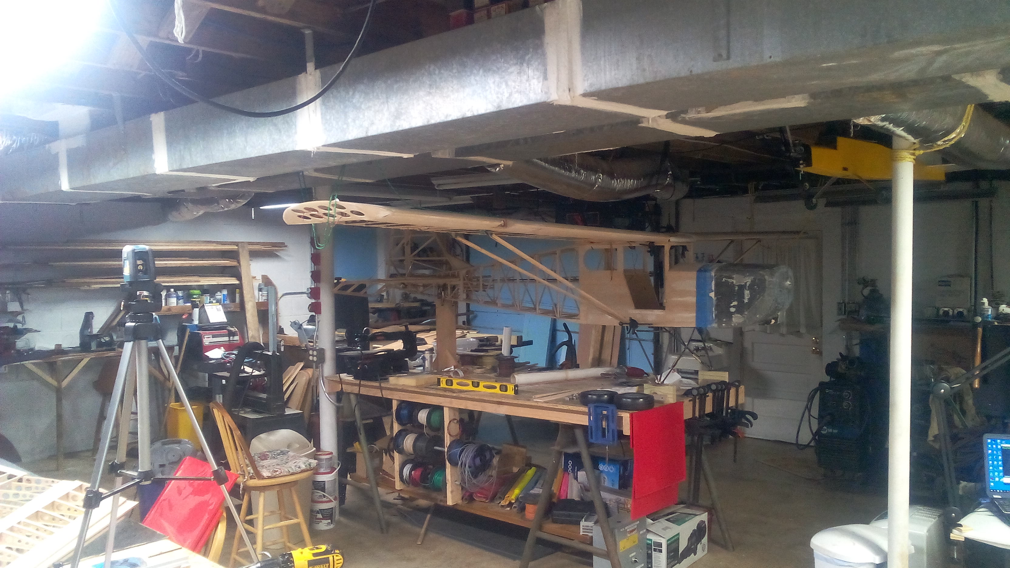

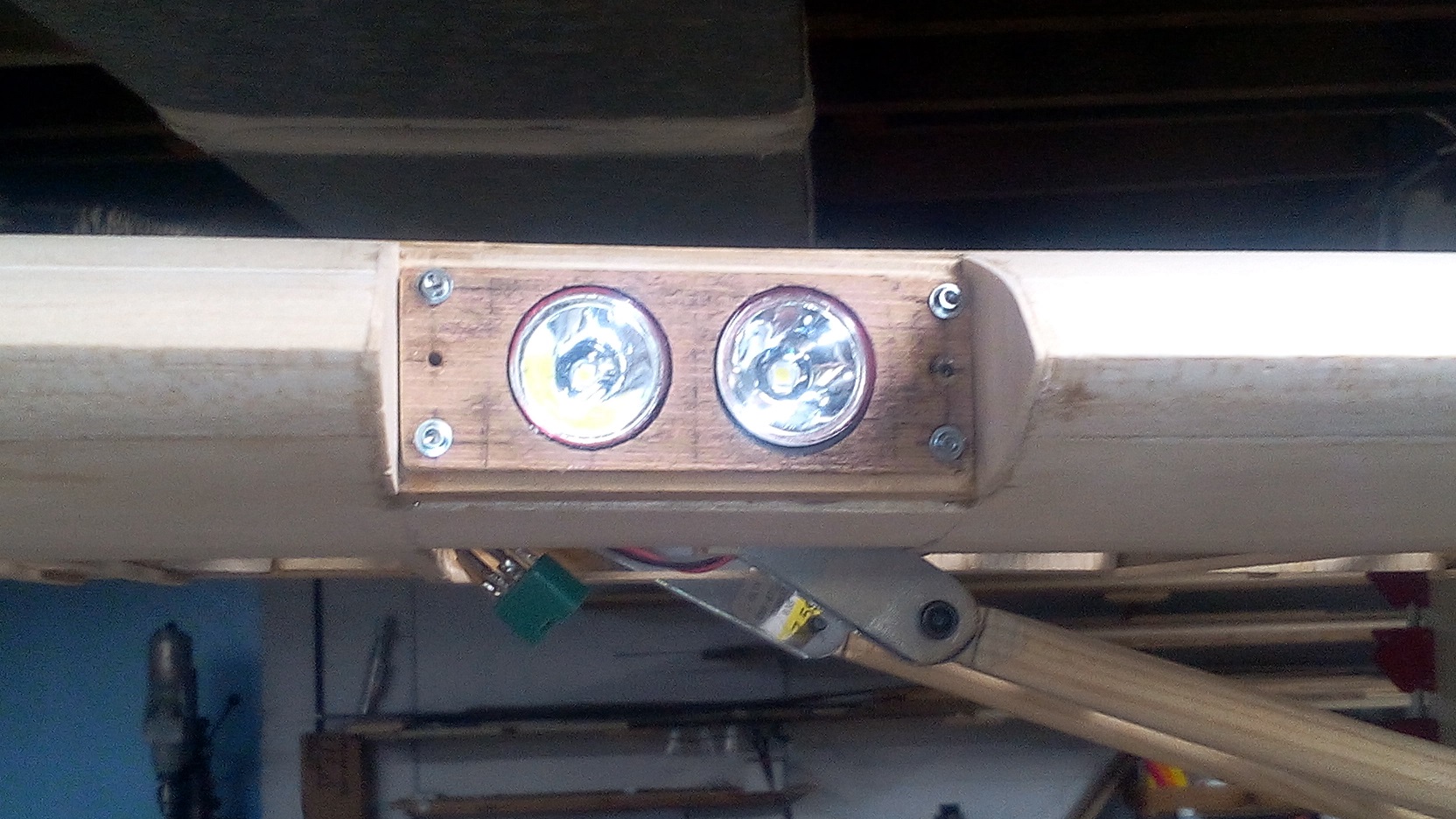

Well it's been a while, work has got in the way again. finally have the wings fitted to the fuse, been working on the LED wing lighting,

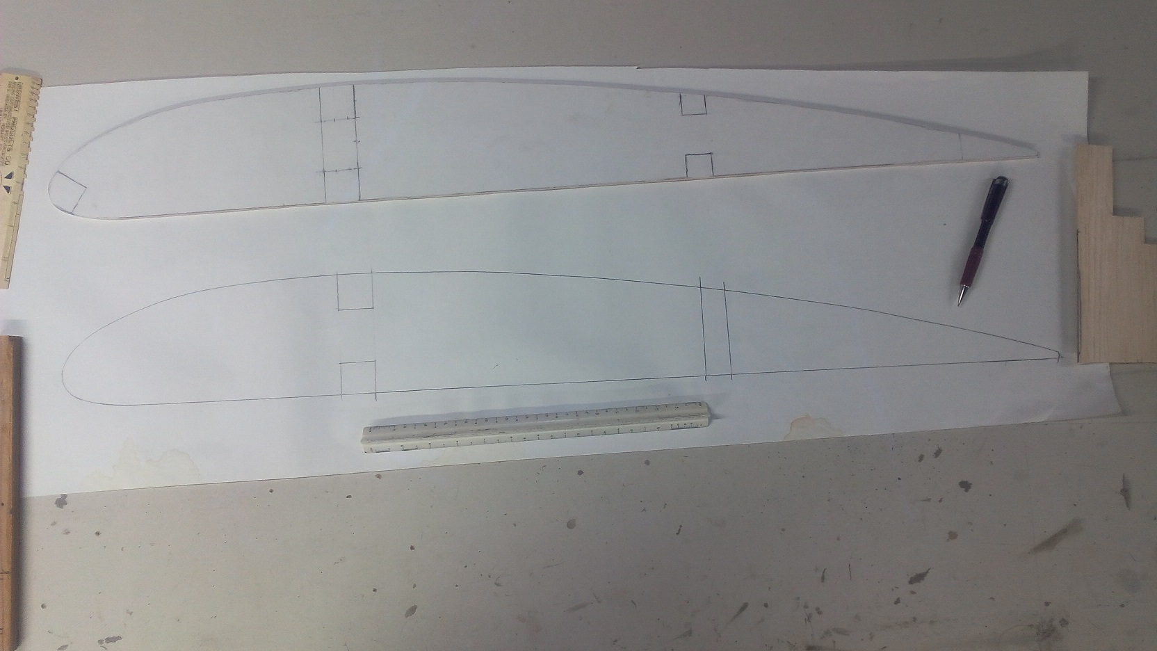

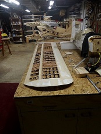

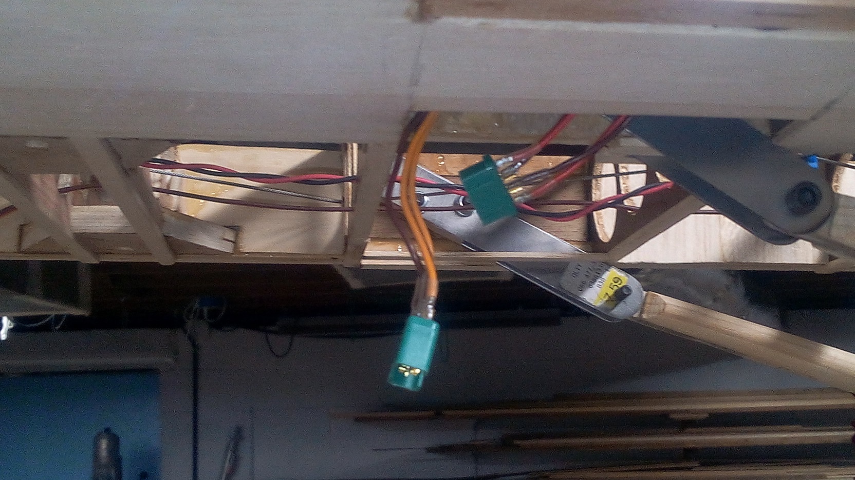

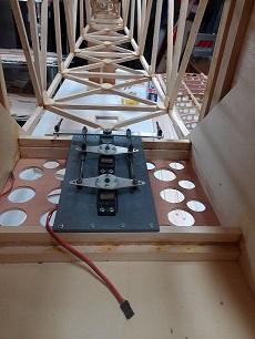

These are the Dubro 8" threaded lightweight wheels. I tried the 7" sullivan Large skylite wheels that I had on my scaled up Weeks Solution X they look a little small on this one. Wing rib for the next fall project. hopefully after the design stage. I am getting ready to start installing radio gear and wiring in the wings.
