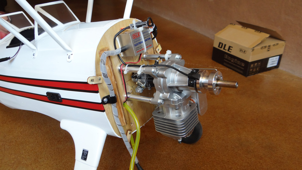

I'm having trouble with my DLE 30 and 35 but believe the issue is with the way I have them tuned. Both run great, fine idle good mid-range with just a bit of burble. I can run them inverted IF I keep the throttle at 3/4 or higher. I run into problems when I try lower throttle settings on BOTH motors.
Do I need to richen up the low end a bit on both??
It may just need tuning. But a couple days ago I was BS'ing with the guys at the field and we discovered that all 3 of us had to replace the carburetor on our DLE engines to get them to run properly. One was a DLE-20 and two were DLE-30's. All three of us bought exact replacement DLE carbs. As the original poster of this thread, I now have about 14 gallons of fuel through my DLE-30 and not one single dead stick since I replaced the carb. YMMV, but that's my story.
