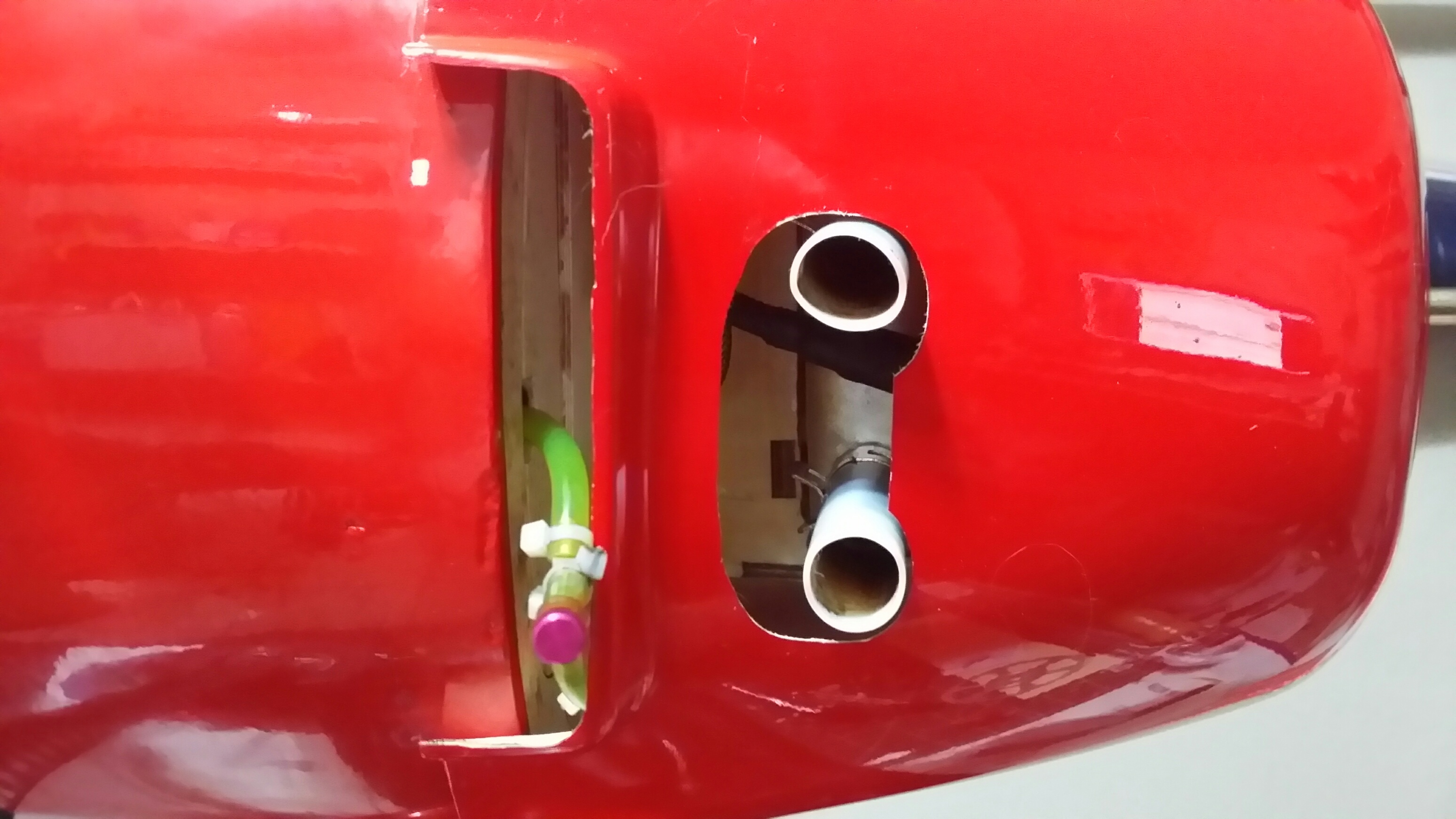

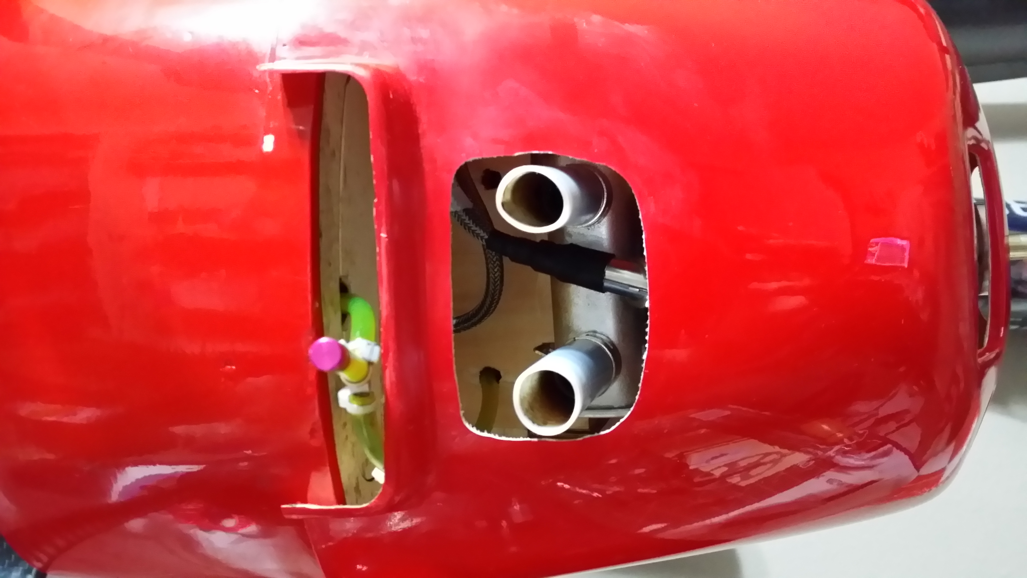

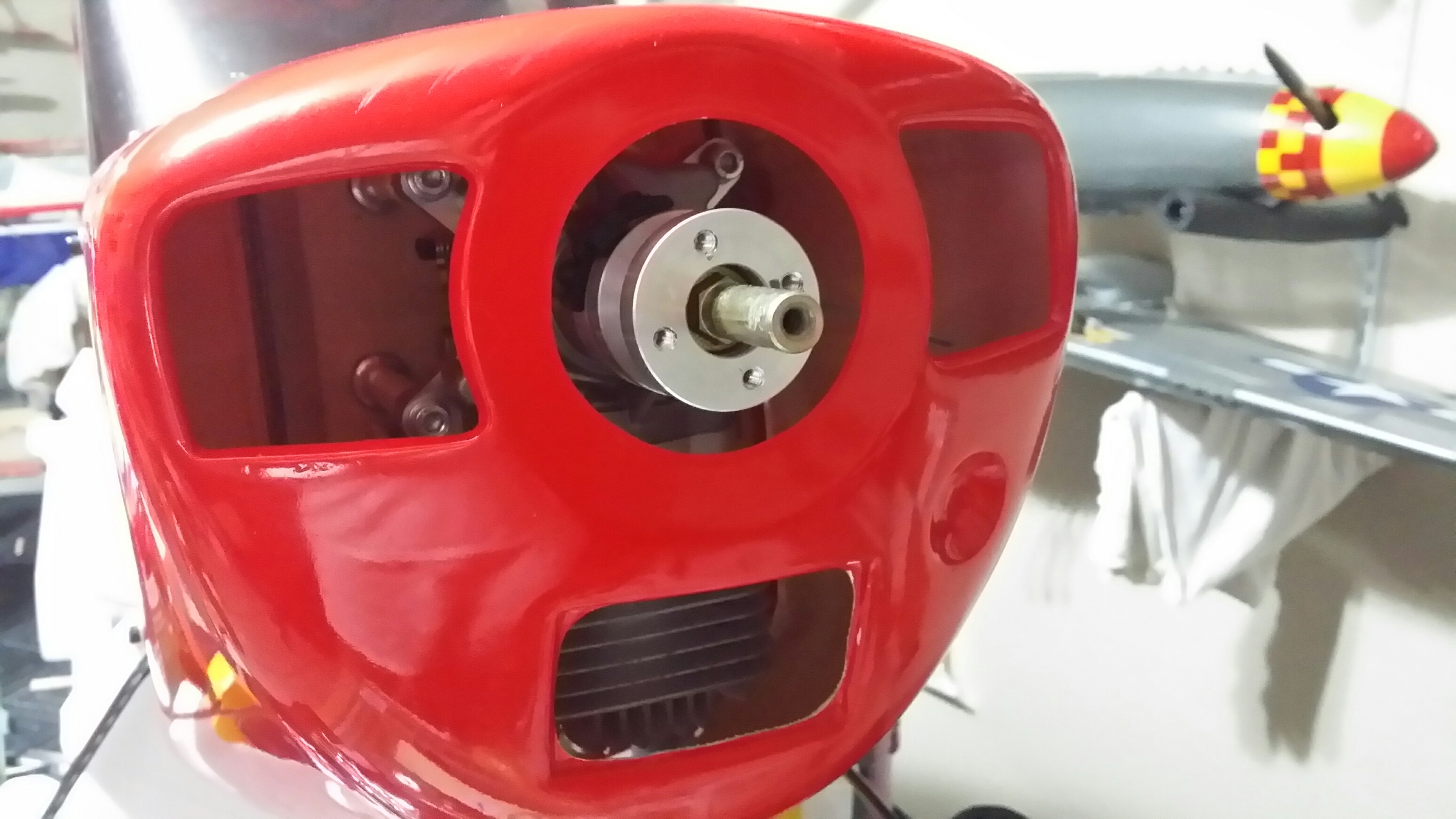

It is back together. I used the rtv on the threads this time and I installed lock washers. Now, I said I would upload a photo of the cowl too so that is attached. I think you can make it out in the photo that there is an airdam to create the low pressure to help suck air out of the cowl. Should I open the are around the exhaust tubes more or do you think it is adequate? Cowl.jpg
AKNick
I would personally say that the outlet is too small in comparison to the openings. Will it work as is... probably. If you wanted to you could blank off the two cowling ears to help with the ratio.
You should be able to fly the plane for a flight, put your finger on the nose of the crankcase (the part that doesn't rotate just behind the prop), you should be able to keep it there without burning your finger, if you do... it's getting too hot/lean.
Just my opinion! See what others think.
3dNater
3DRCF Regional Ambassador
I agree. That cowl has a ton of open space in the front. Like [MENTION=3929]AKNick[/MENTION] said, you could blank out one or both of the ears in the cowl. Blank them both unless you need one open to access the choke. Even then I would expand the size of the opening around the pipes. I was going to say double it, but would probably not want to if it were me for looks.
wfahey415
3DRCF Moderator
Thanks guys. I am going to open it up in front of the down tubes in hopes of getting more air over the cylinder head and out of the cowl. I do access the choke rod through one of the cowl ears but have thought about putting in foam baffles to direct the airflow. I will open the bottom first and see how that works. Baffles if necessary.
