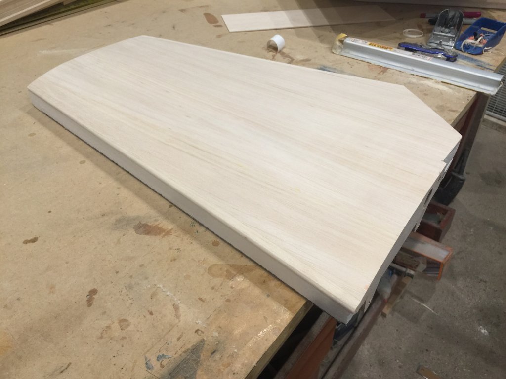

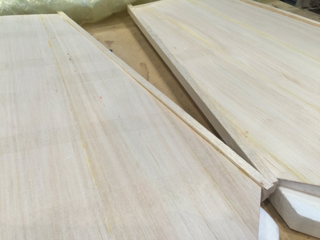

This morning, I sanded down the LE and TE of the wings and the stabs.
then I began to glue on the LE and TE for the stabs.

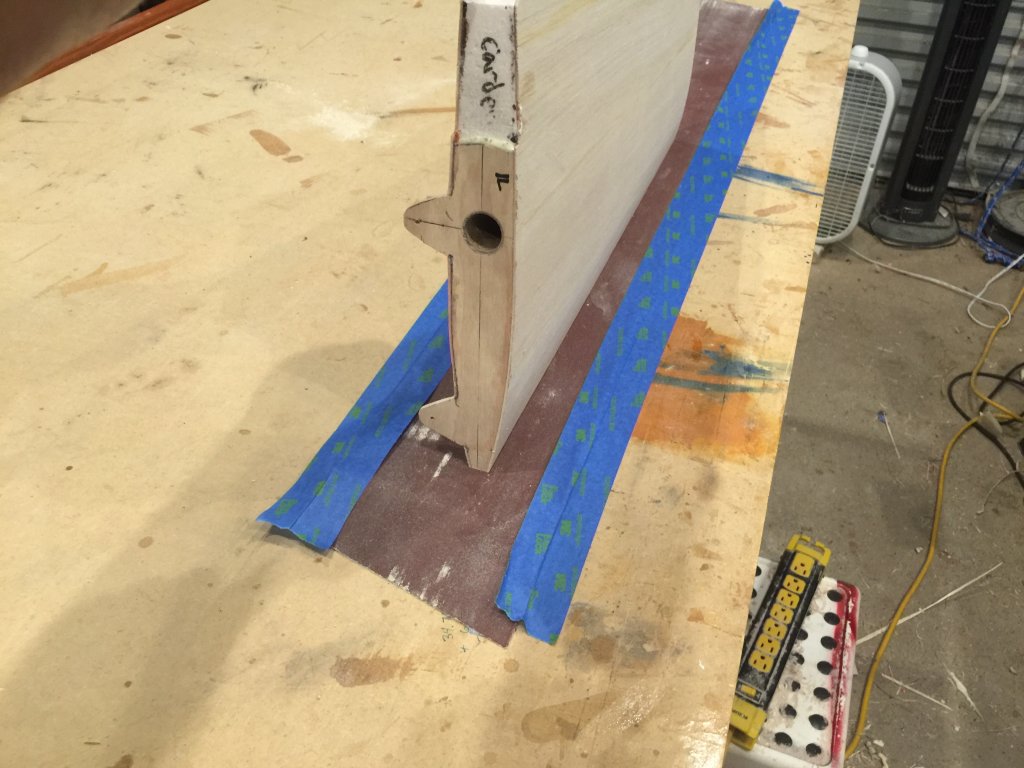

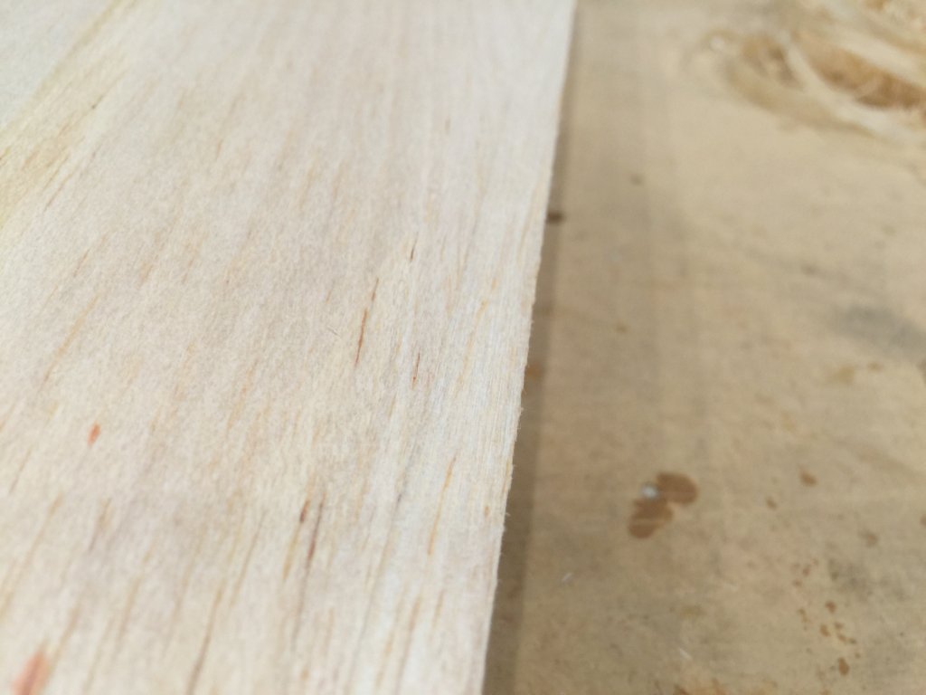

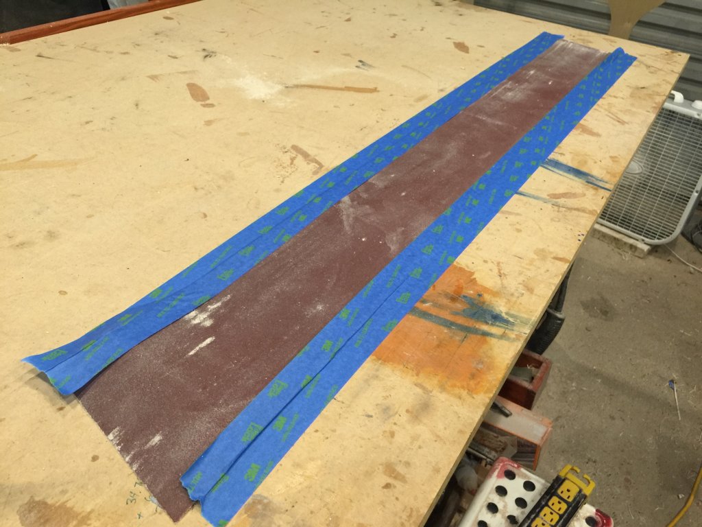

Being that my table is flat. I placed a sanding belt, flat on the table, and then pushed the wing and stab over it, in a smooth and controlled stroke, only in one direction, and making sure the wing and stab were perpendicular to the table.

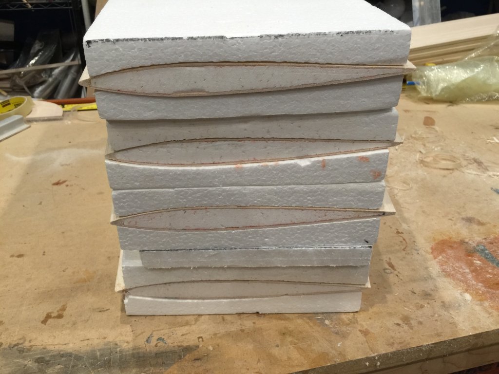

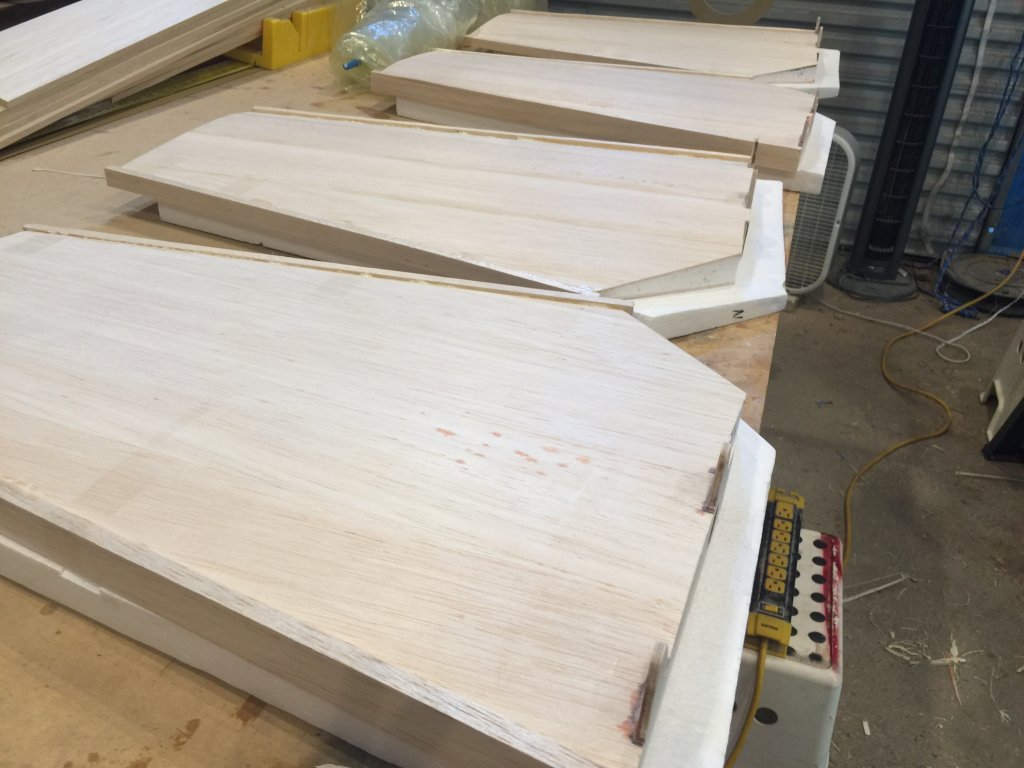

I was able to place the stabs in the bag, and use vacuum to glue on the LE and TE to the stabs. My plan worked! It really makes it so there are no gaps between the LE/TE and the foam/sheeted area. The important aspect is to assure that the LE and TE of the sheeted foam is true and straight.
Now, time for the hard part!! Which is shaving and then sanding these down. The TE is easy. The LE takes more work.

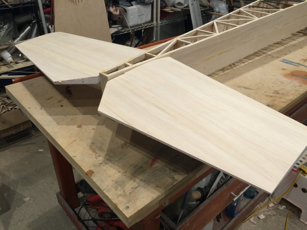

I also have to glue on the LE and TE to the wings, and then, I can set the incidence!
Was able to finish the LE and TE of the stabs.

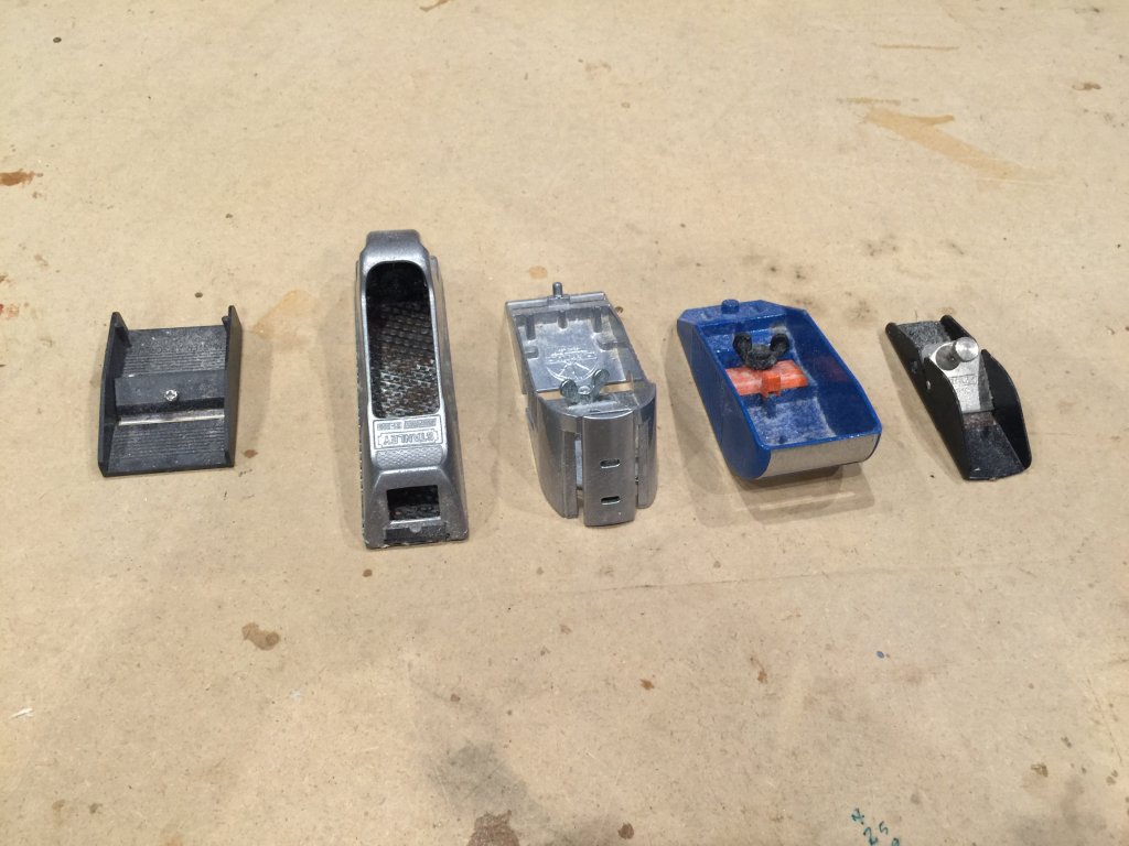

These are some of the tools i have accumulated over the years, ask me which one works best??
I am happy with them...

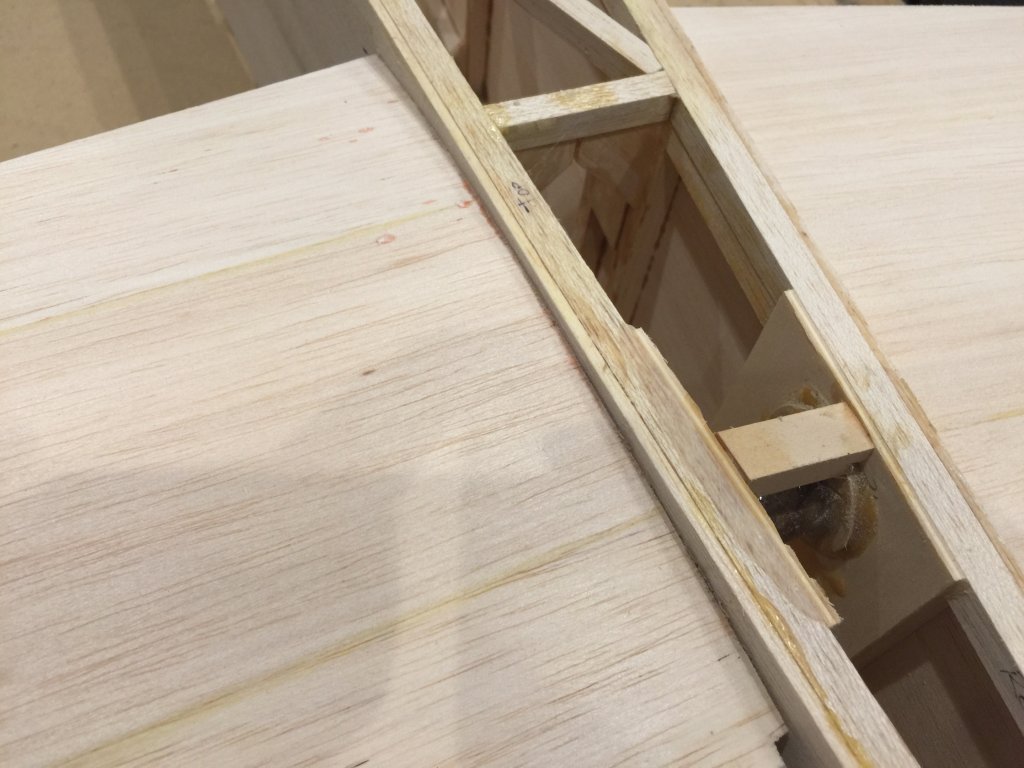

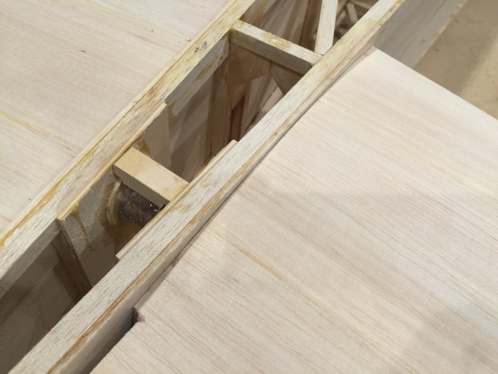

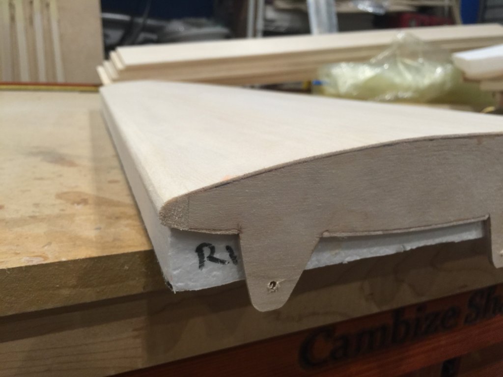

Here is a picture of the LE:
here is the TE...

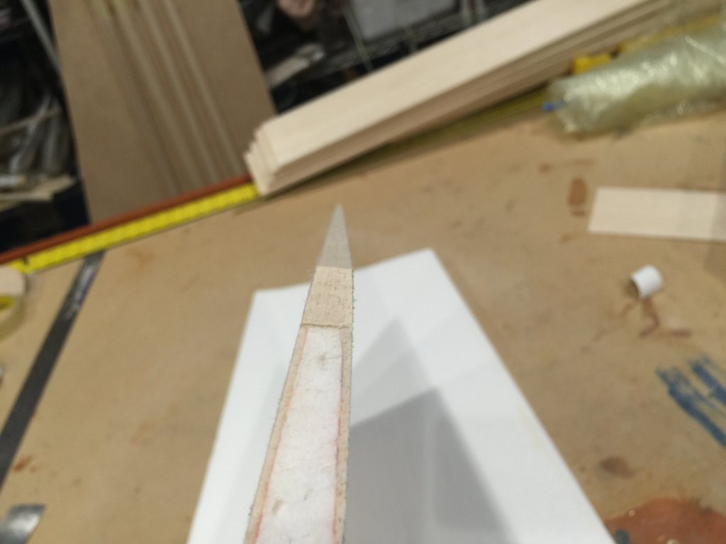

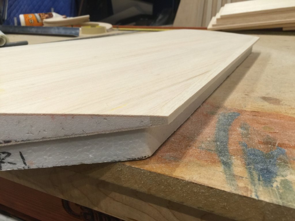

this is to demonstrate the great joint between the LE and the balsa sheeted foam. Also, I had learned of using the white glue from Gorilla brand glues, and it sands easiest. and, it is clear too!
