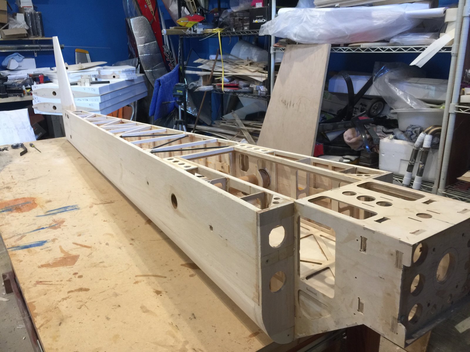

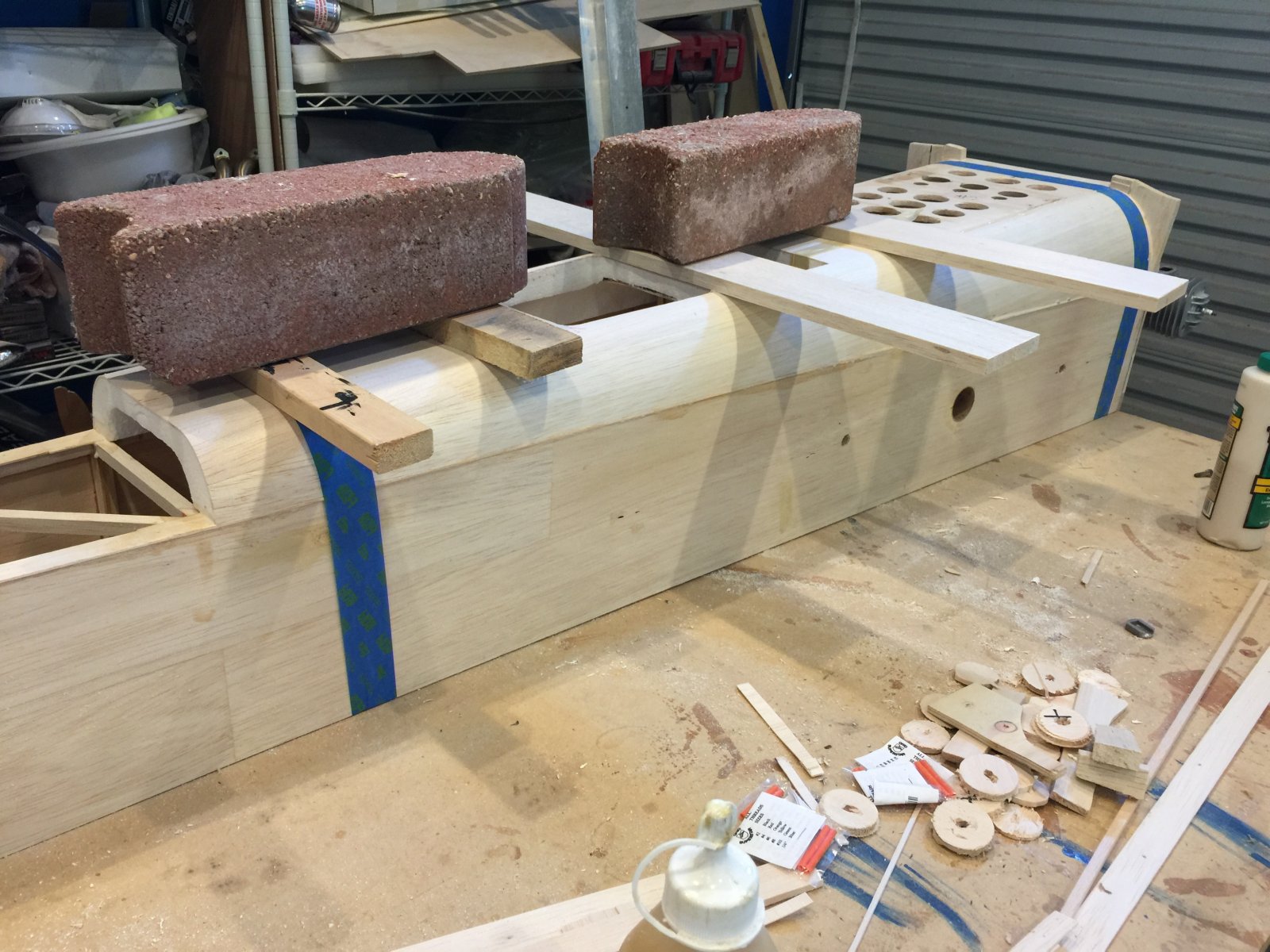

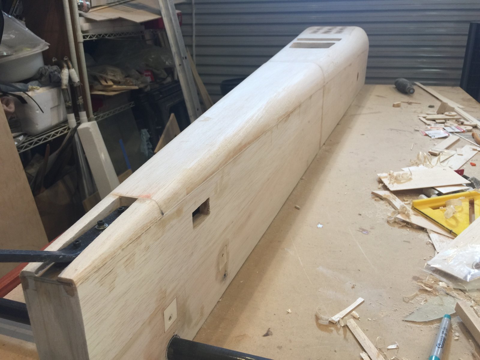

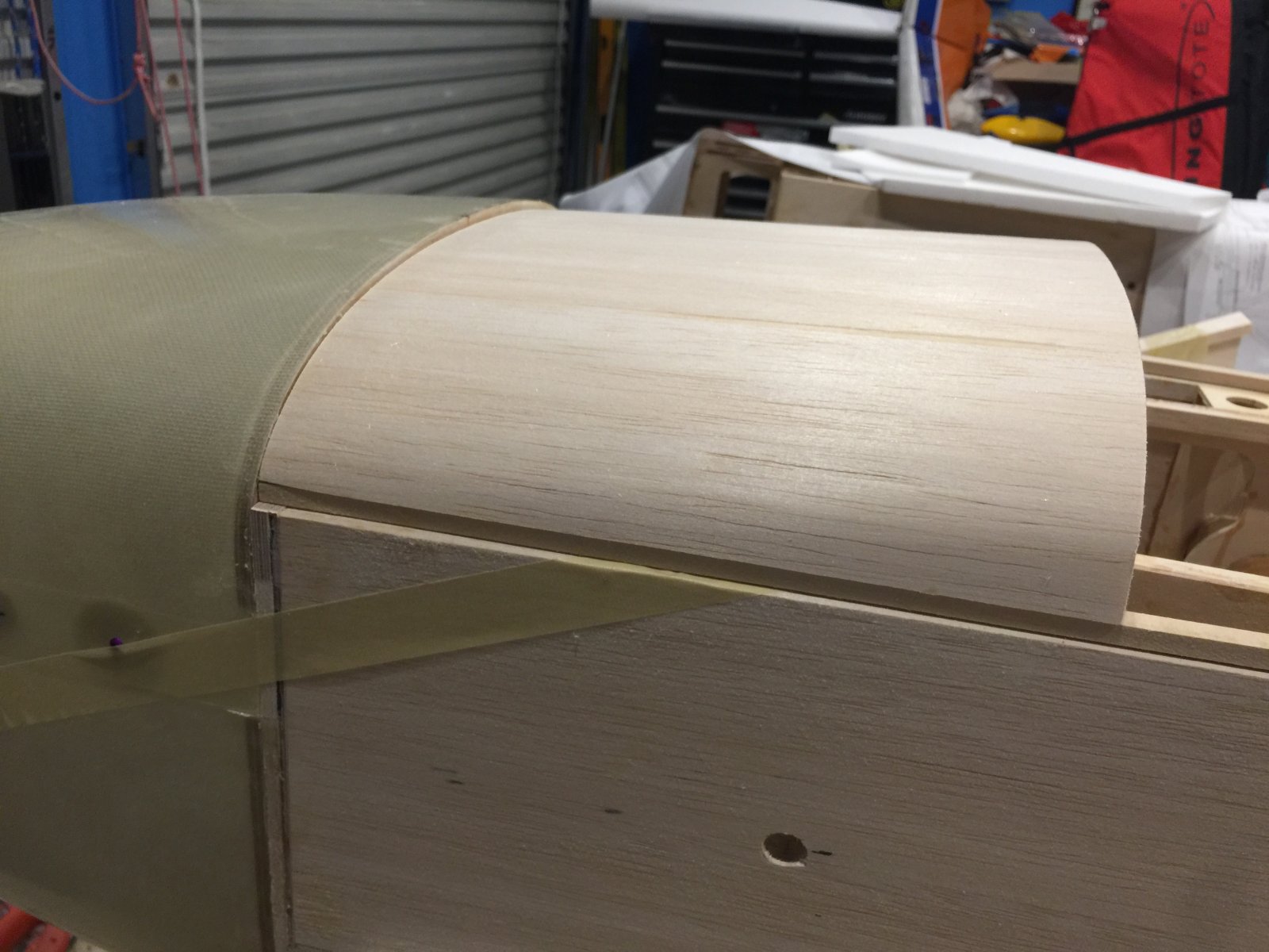

The tunnel is sheeted. Now, to glue on the front bottom deck.

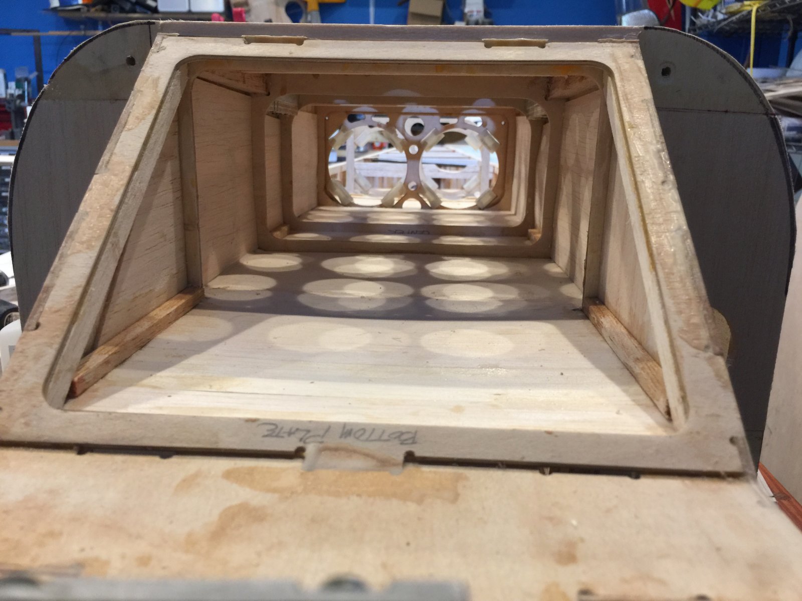

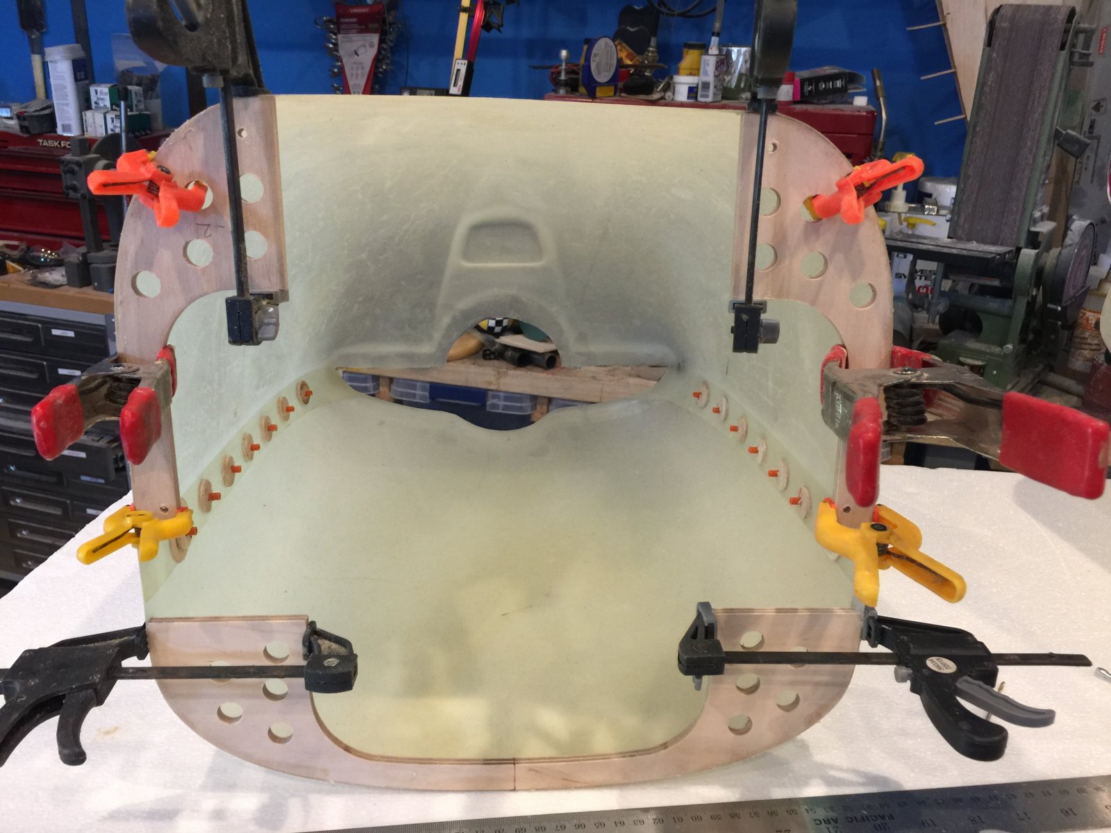

I finally have glued on the bottom front deck. And then, the cowl, should be cured in 24 hours or so.
After this cures, I will glue on the rear bottom deck, and then, I can add the fin and the turtle deck.

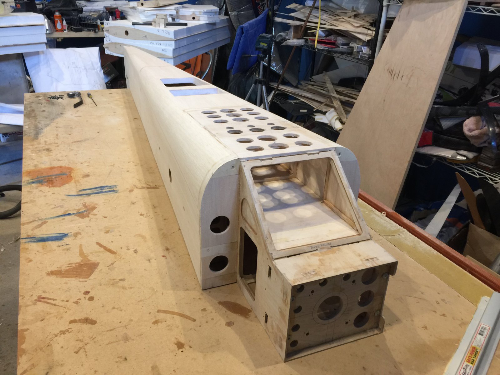

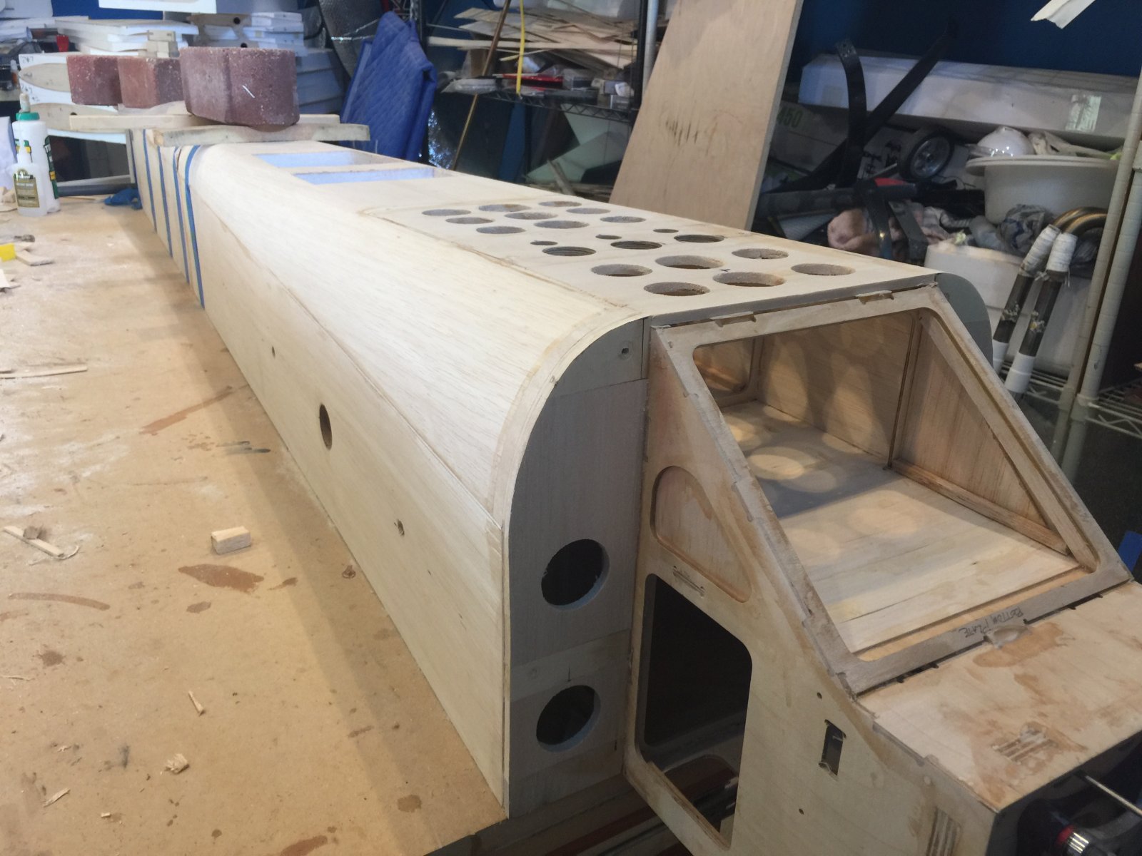

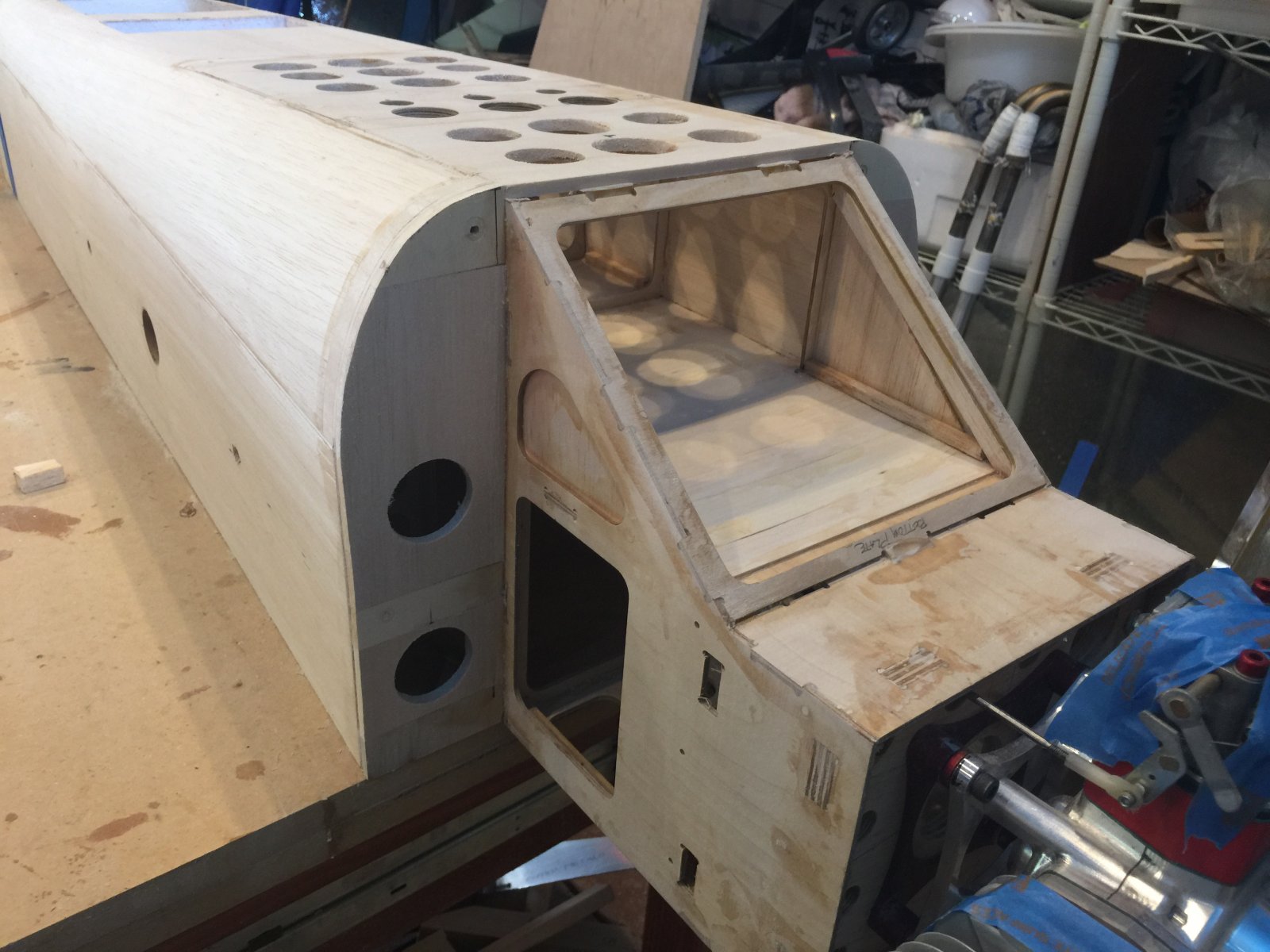

Here is a sneak peek at the bottom of the fuselage. Still need to do more sanding.

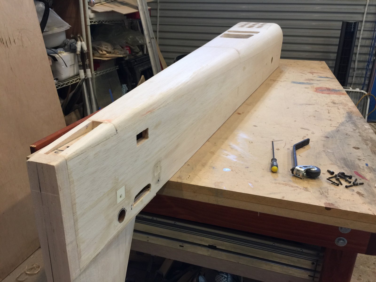

Next step, is to cut out the rudder/fin, and glue that on the rear, then add a conduit tube from back to middle, and then install the turtle deck. Imagine, once I do this, then repeat on Fuselage #1!

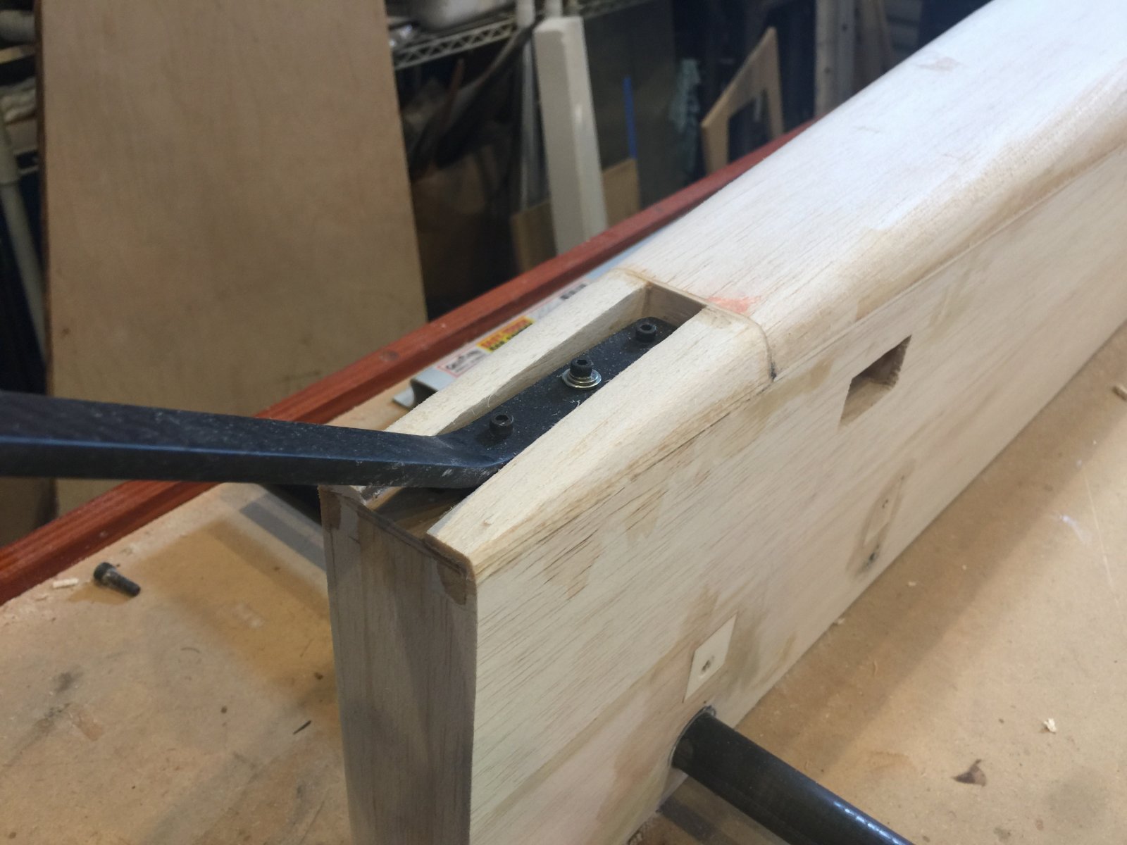

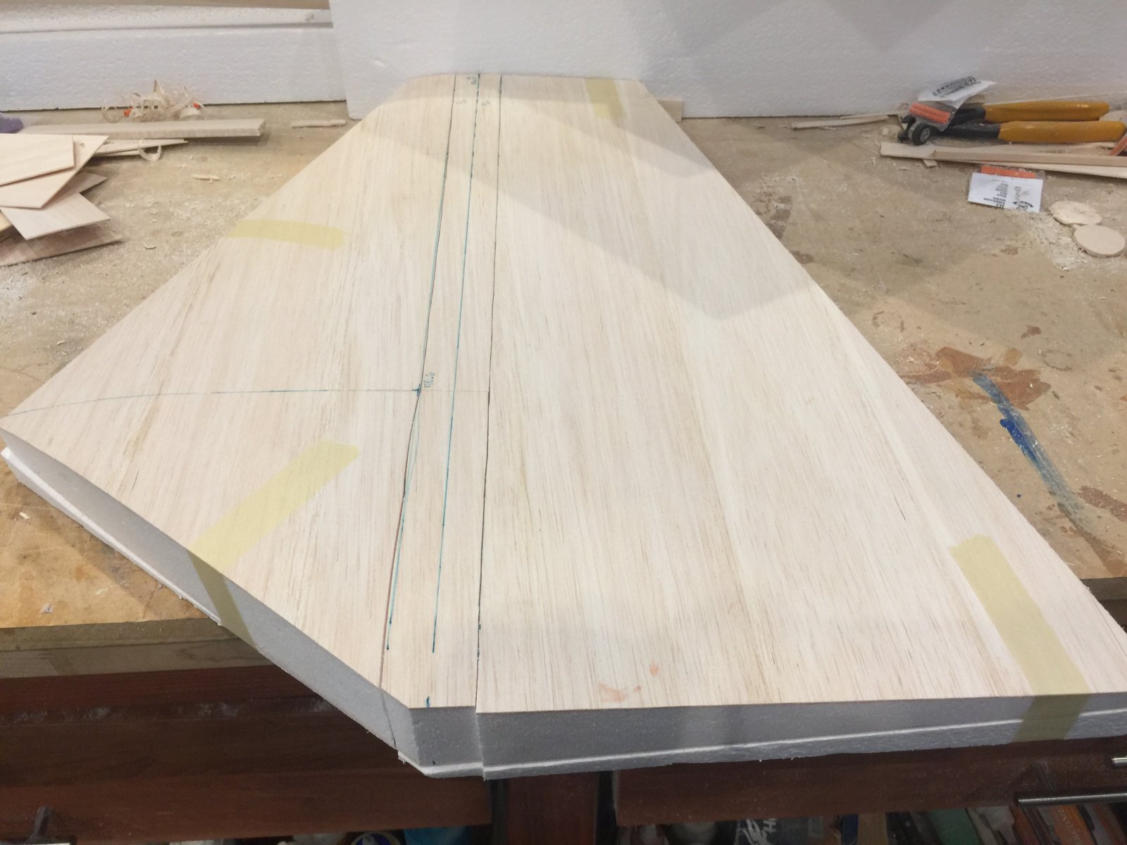

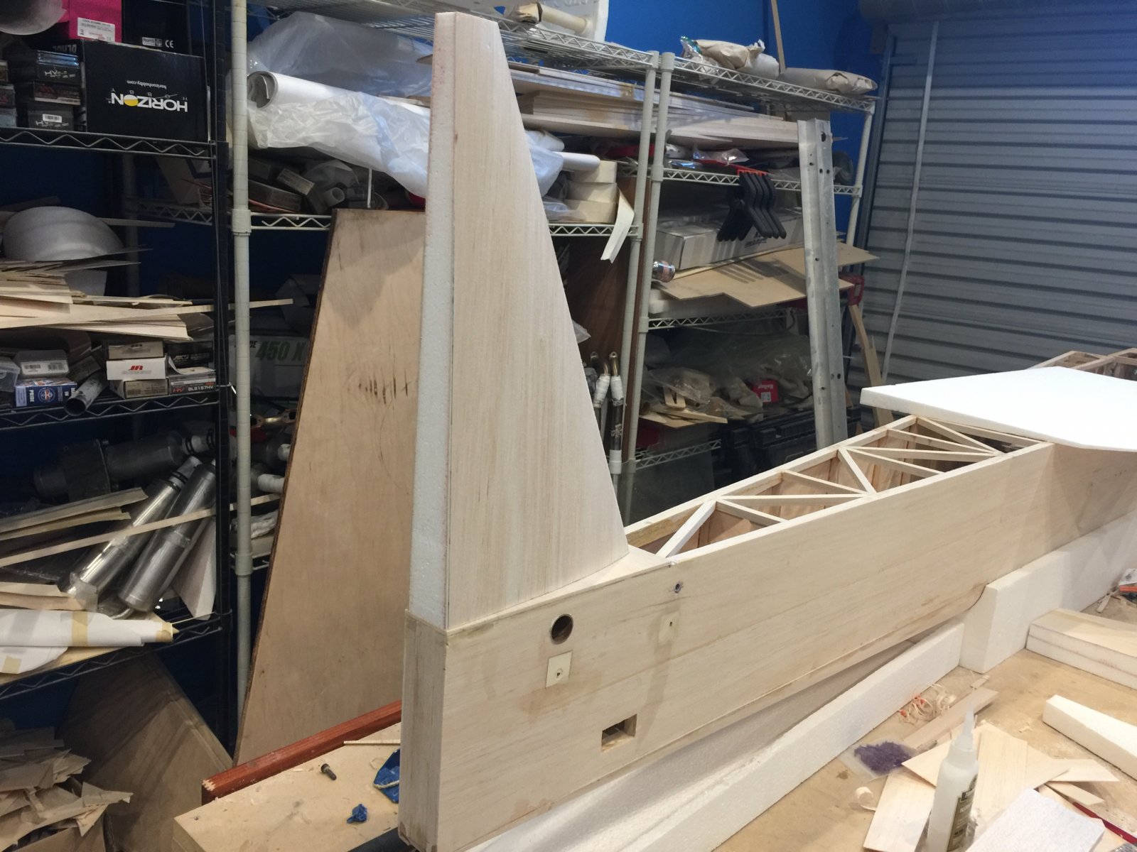

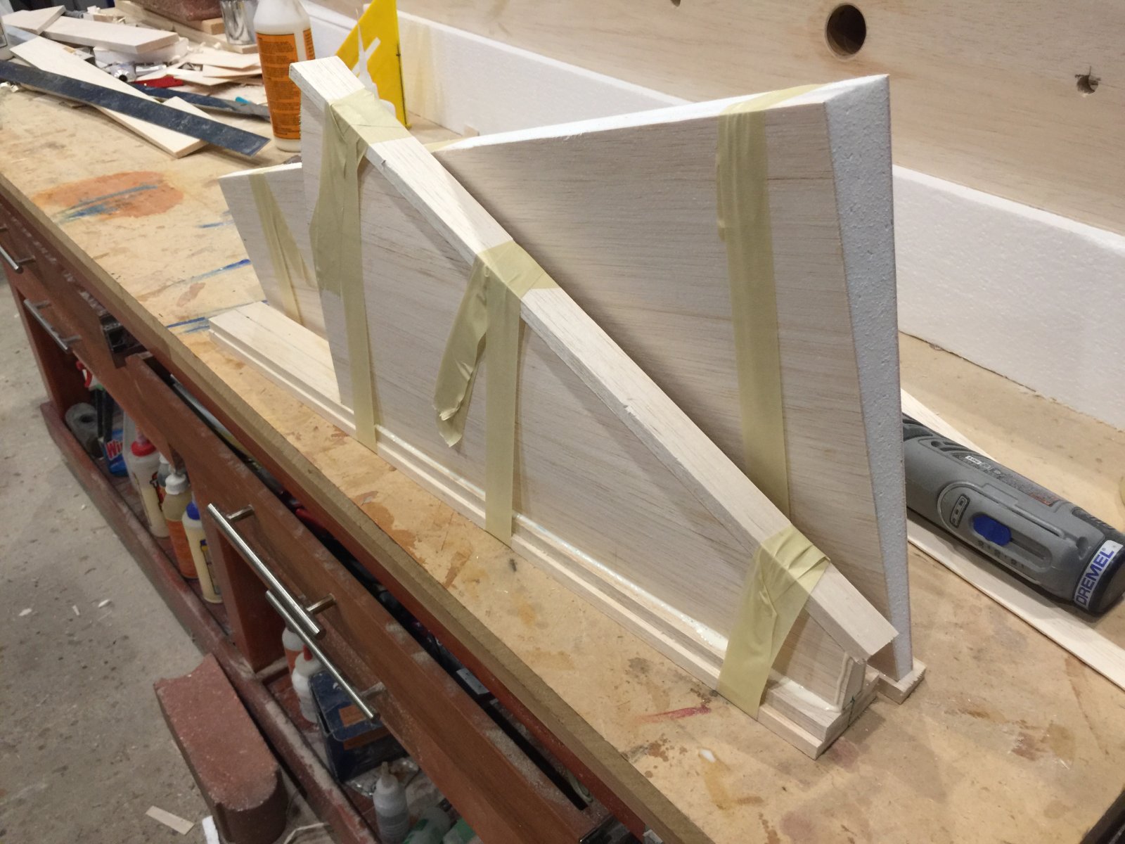

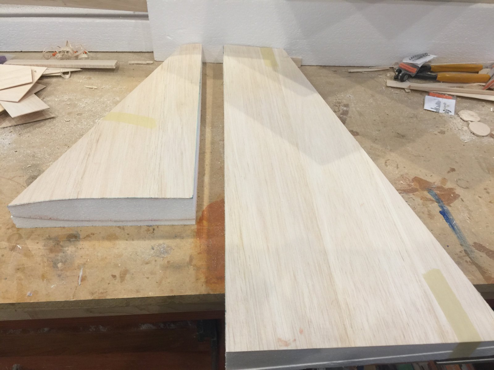

Rudder was cut out, per plans. Without a counter balance, it will make this step way easier. the hinge gap requires me to us two 3/8" balsa stock, on the LE and on the TE of the rudder hinge. SO, it will be 3/4" on one side, and 3/4" on the other side.

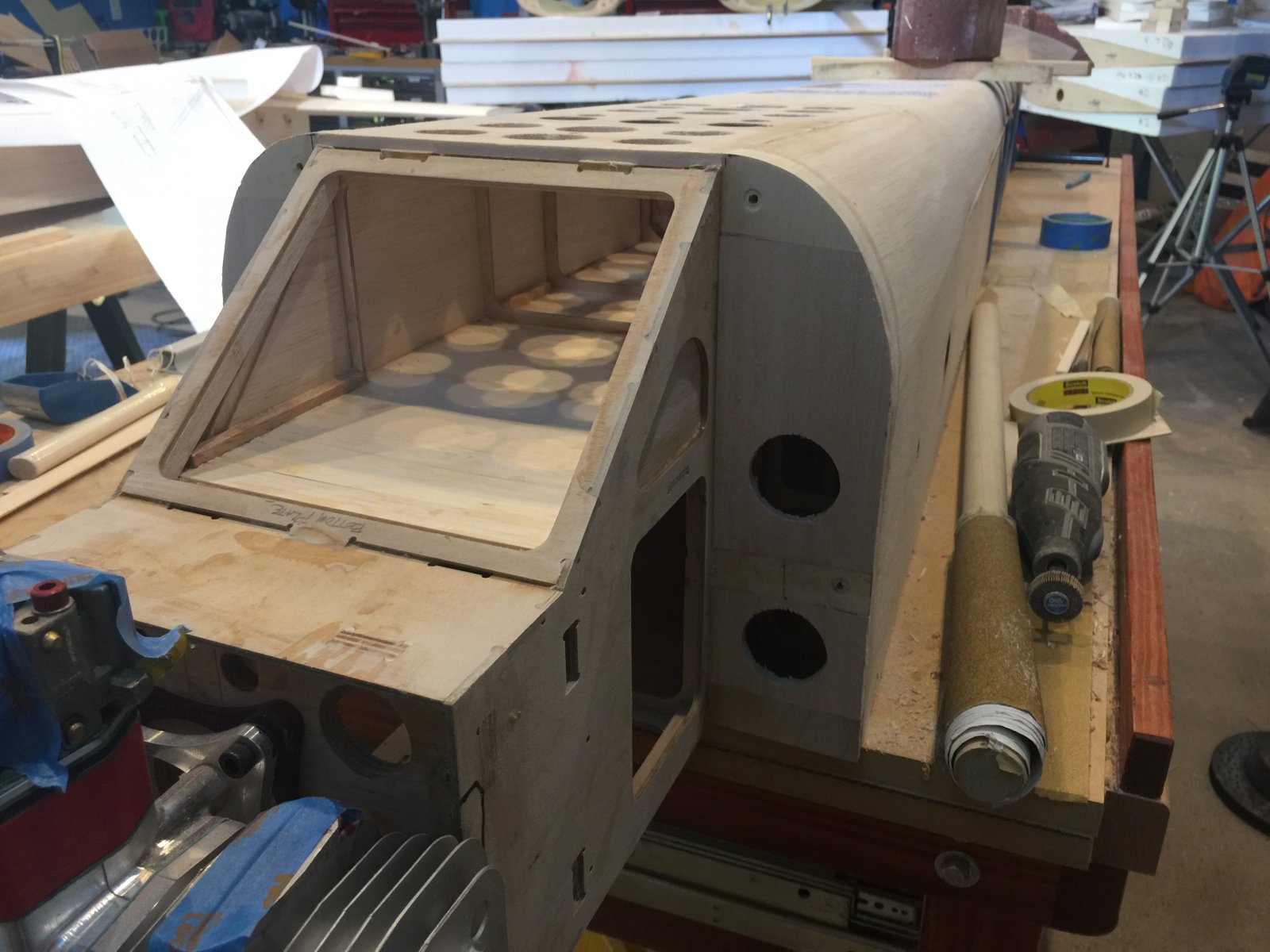

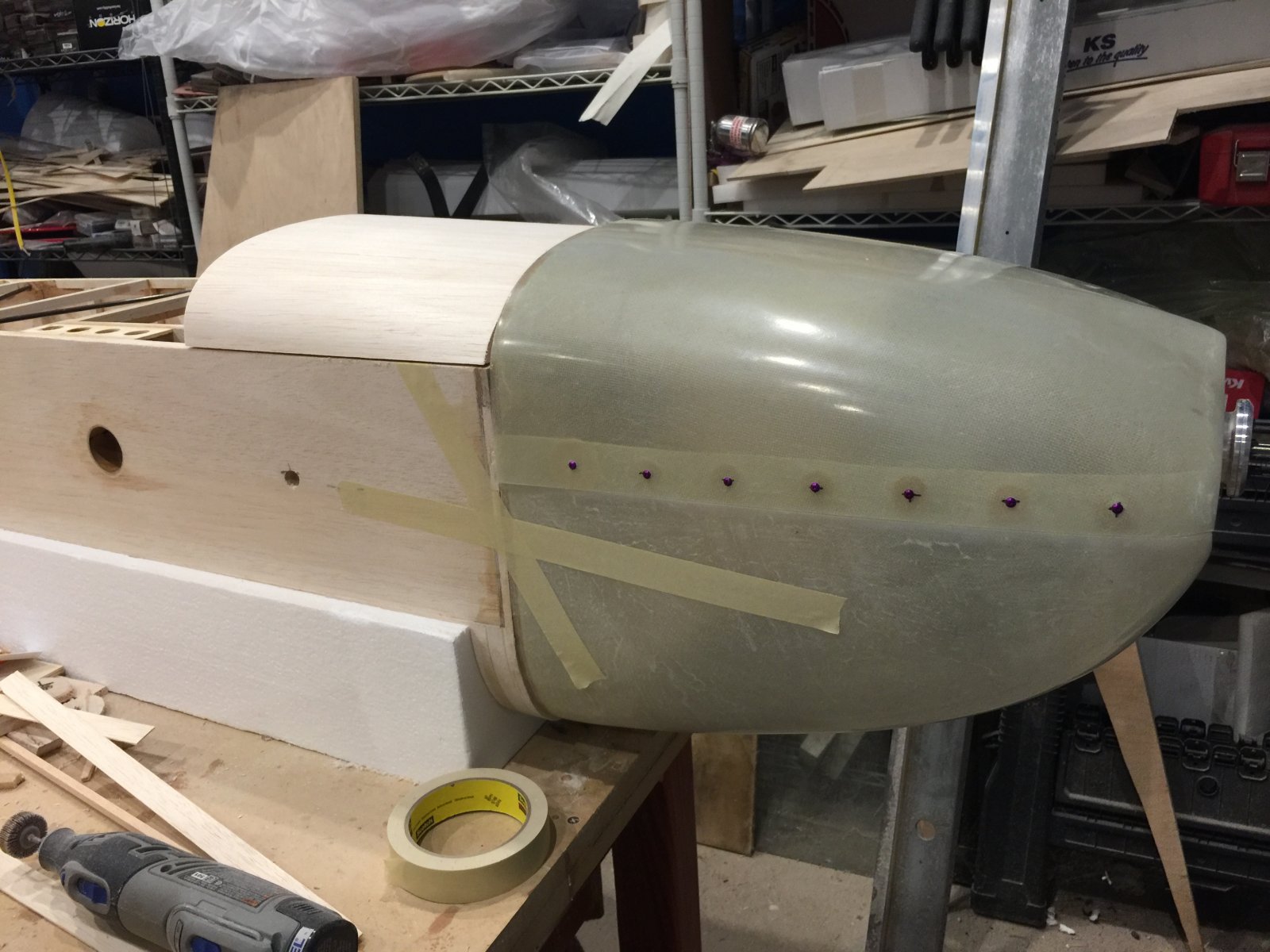

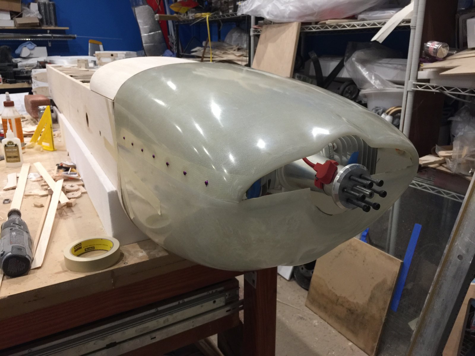

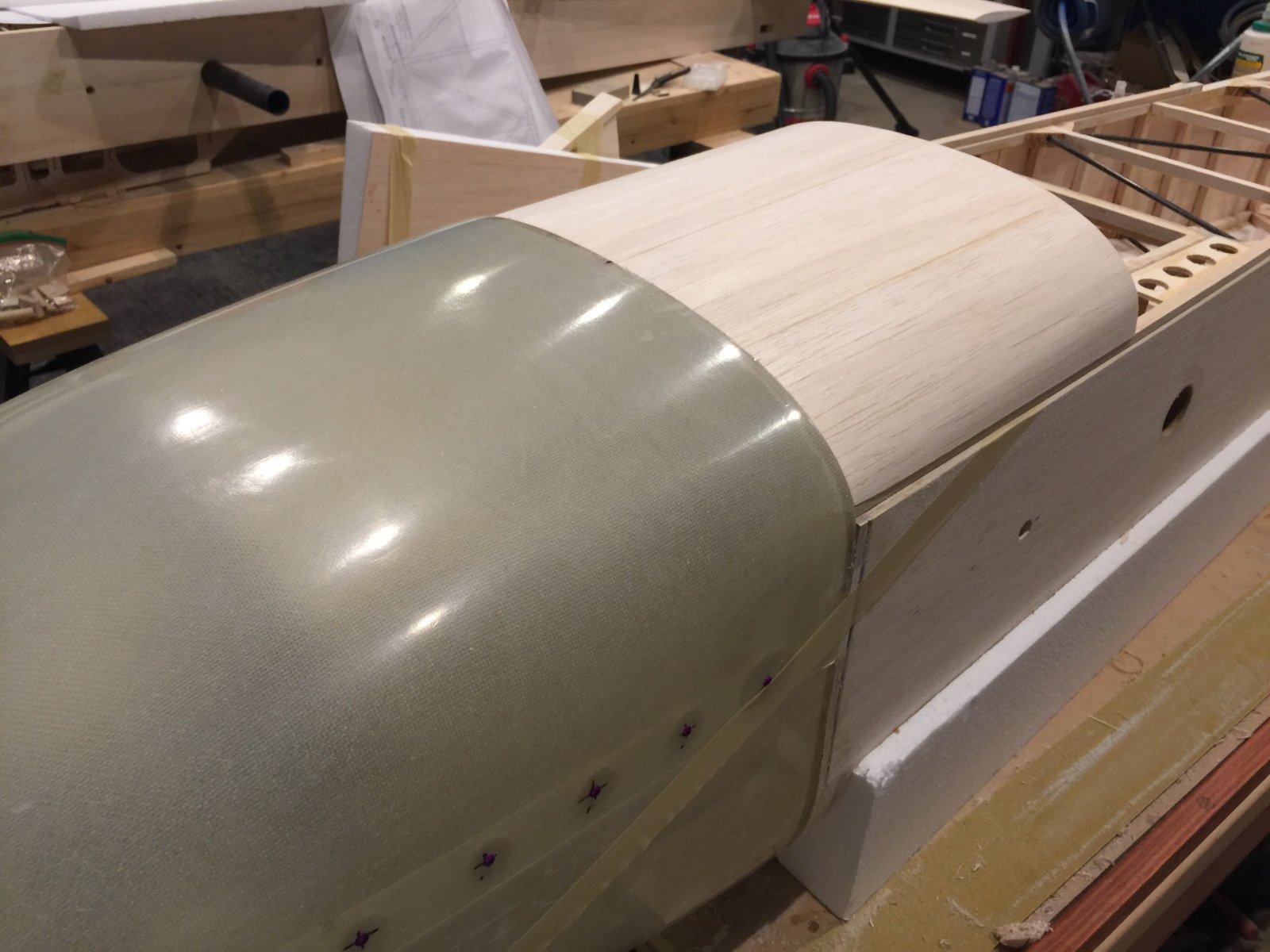

the cowl is coming together, and I wanted to get an idea of what it will look like. Tomorrow, I should be able to glue on the fin, and then the turtle deck.

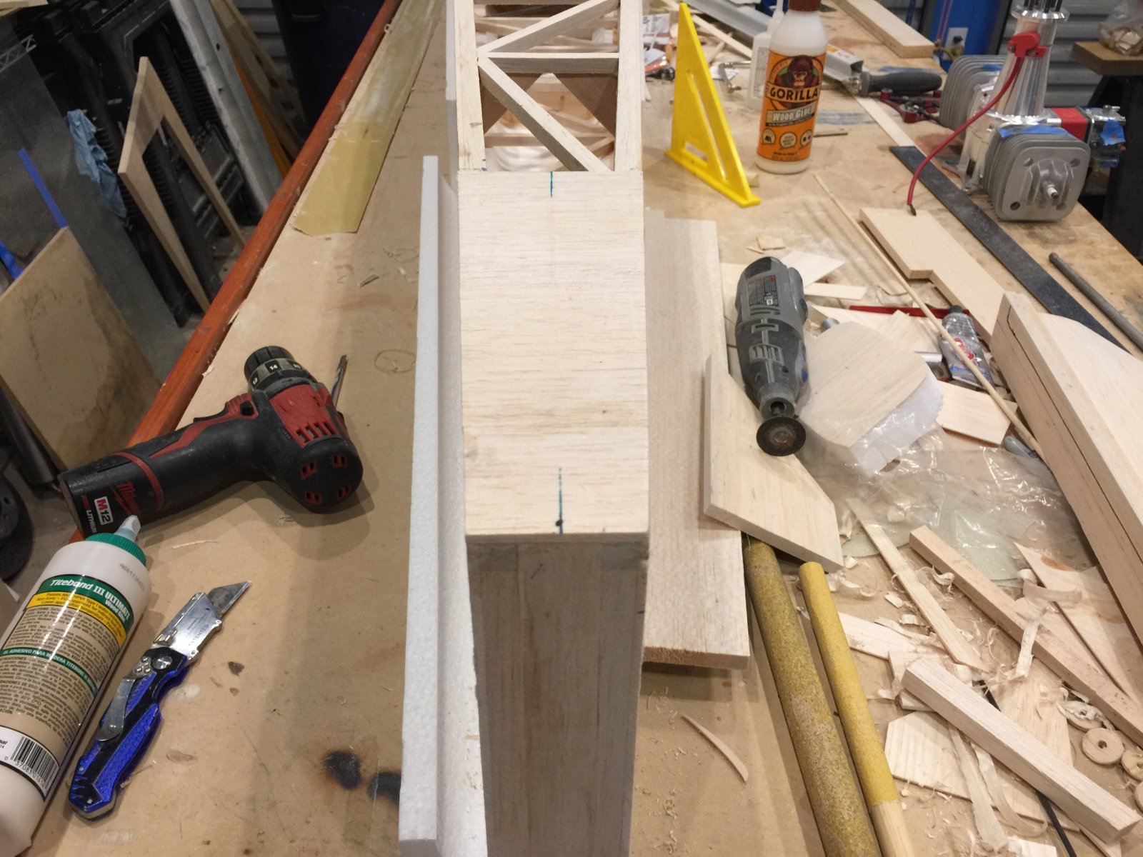

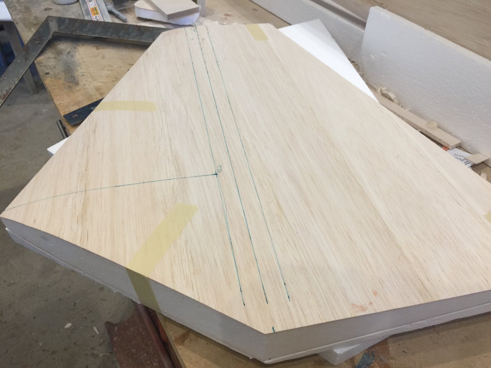

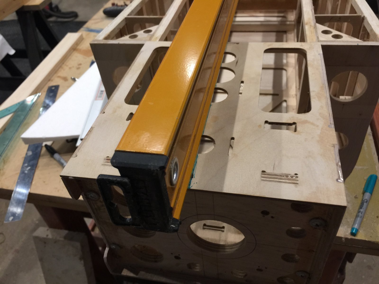

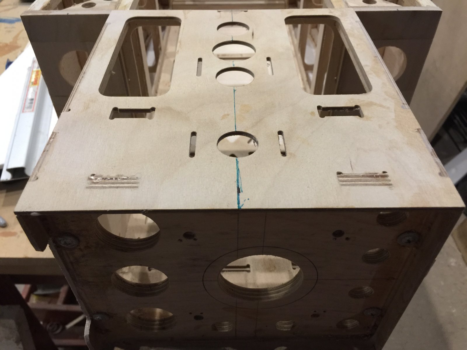

This morning, I shaped the LE of the fin, and then began to draw out the center line of the fuselage, from the nose to the tail.
I marked the tail center at the fuselage trailing edge, and also on the fuselage nose, by motor box, and then checked it with center line on the firewall. SO far, so good..
then, I drew my line in the top of the tail of the fuselage. This will mark the front of the fin.

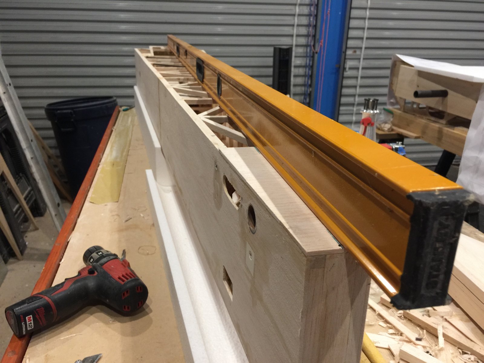

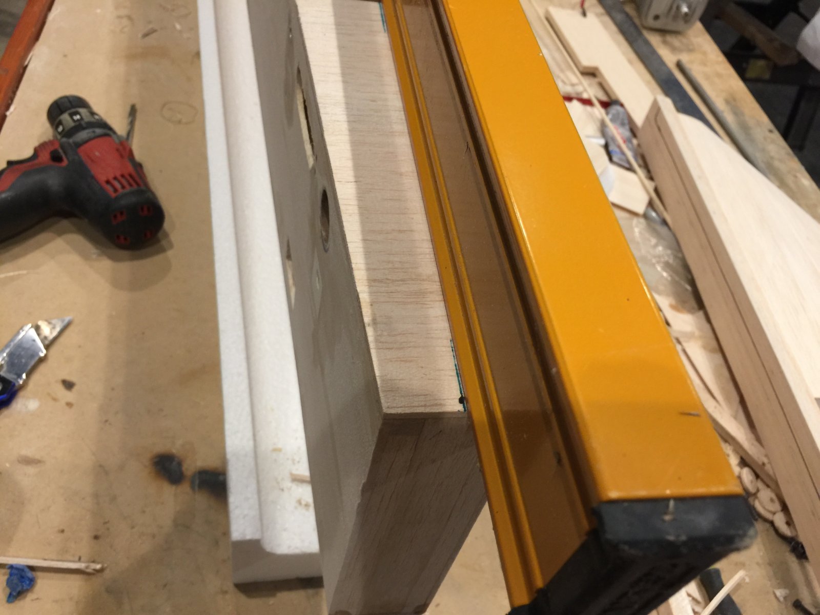

Here is the line. I want to make sure the fin LE center, is aligned with this mark. Additionally, I want the fin to be perpendicular to the wings. SO i brought out the laser light, and made sure the fuselage was level on the table.

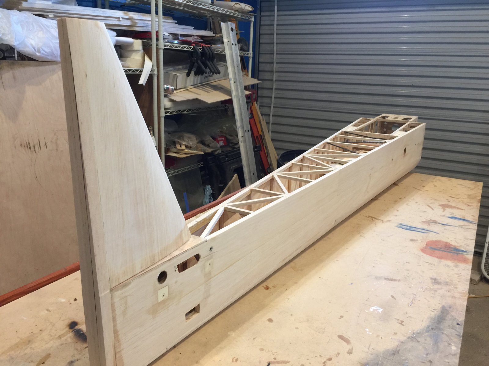

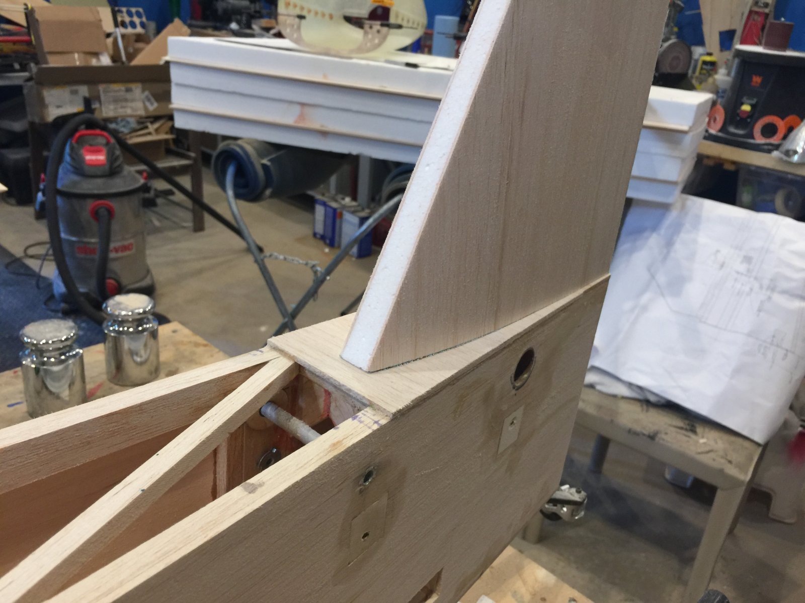

Early this morning, I did glue on the fin, and I used epoxy resin mixed with milled fiberglass. I also used the laser light to make sure it was perpendicular to the wings. And, it was. When i got home, it was solid.
I sanded down the TE of the fin, and then did some measurements again. SO far, so good.
I then flipped it, and began to work on the bottom of the TE of the fin, and sanded it smooth. This will be fun to cover!! LOL!!! I guess I could fill that gap with balsa, and let the tail wheel elevate the fuselage tail more??
