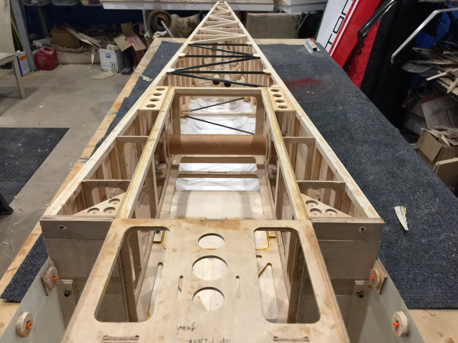

Before
After

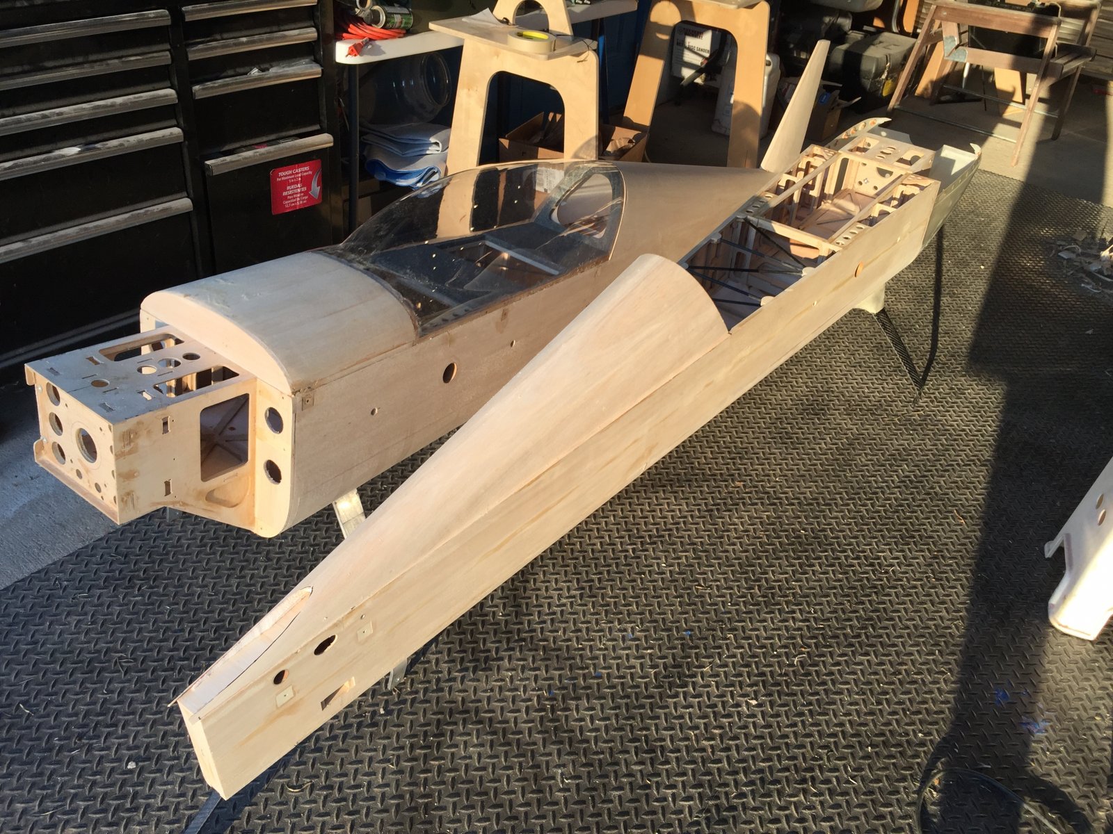

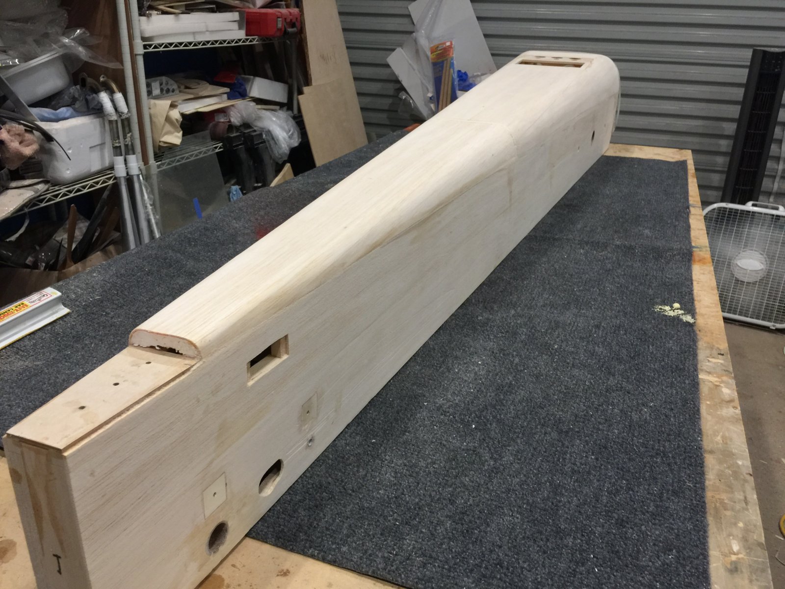

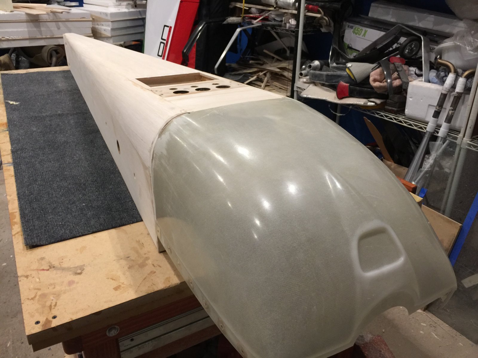

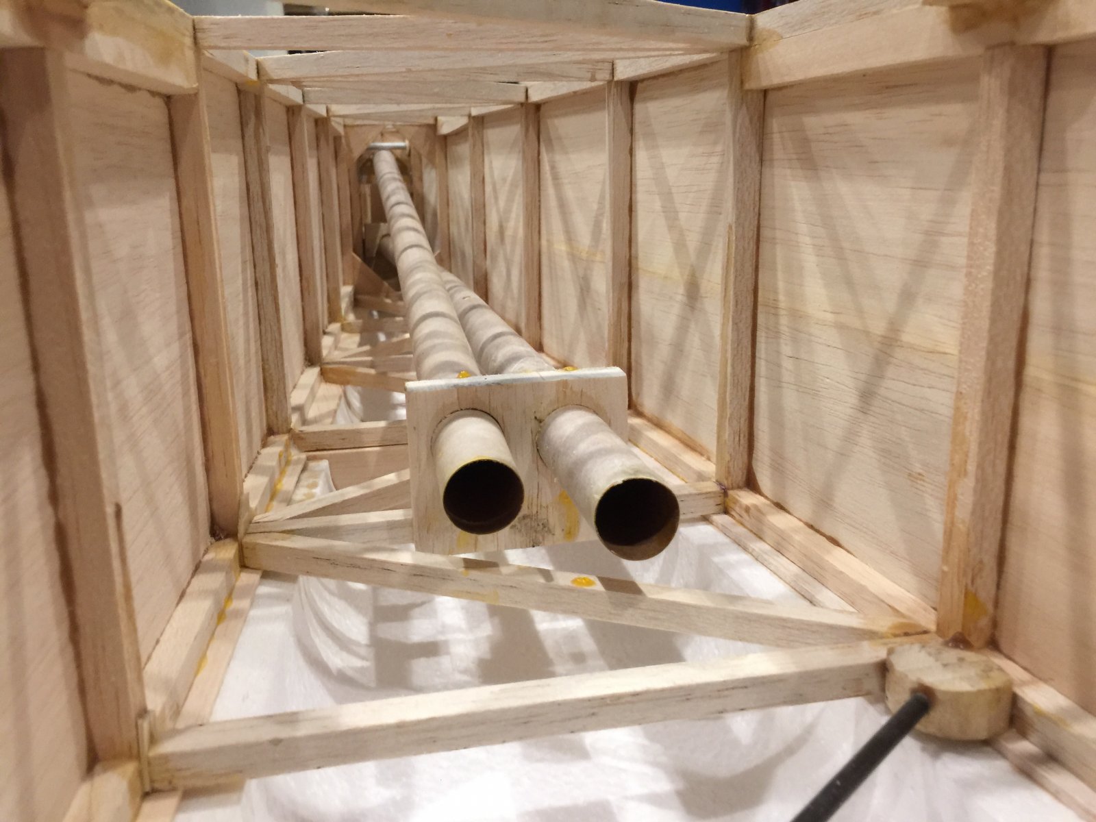

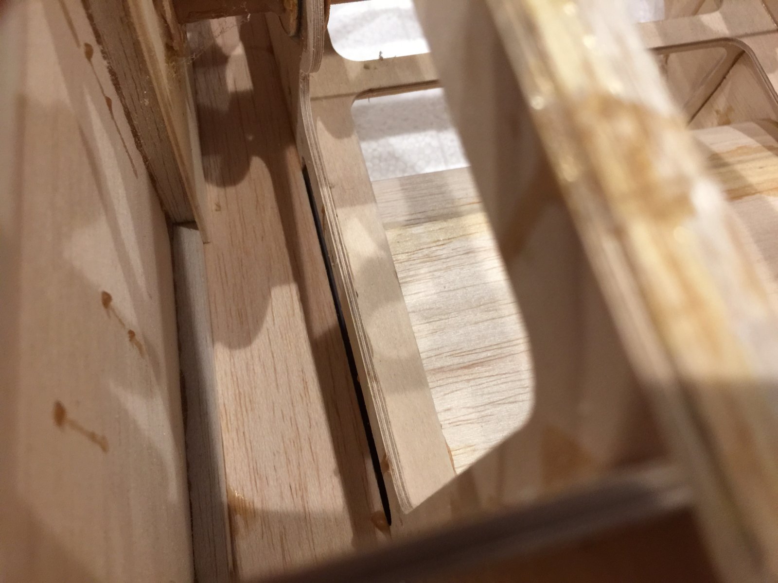

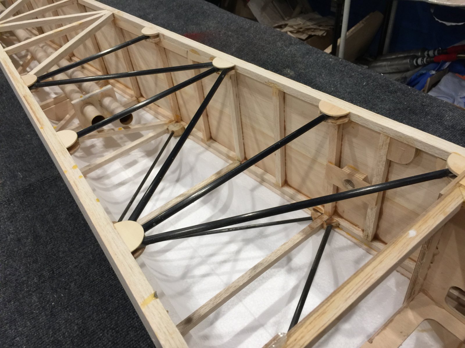

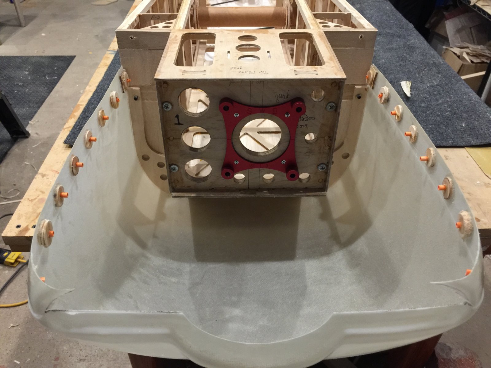

SO I have been able to install the canister mounts, then, I did the cowl. Then installed the conduits for the servo leads, then glued on the bottom front and rear deck. Now to finish the tail wheel balsa, then I can glue on the fin, then the turtle deck.

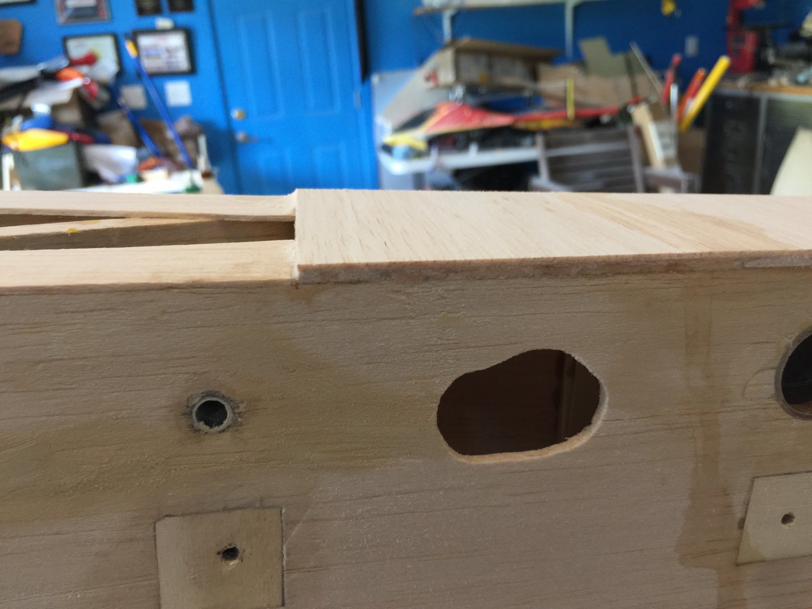

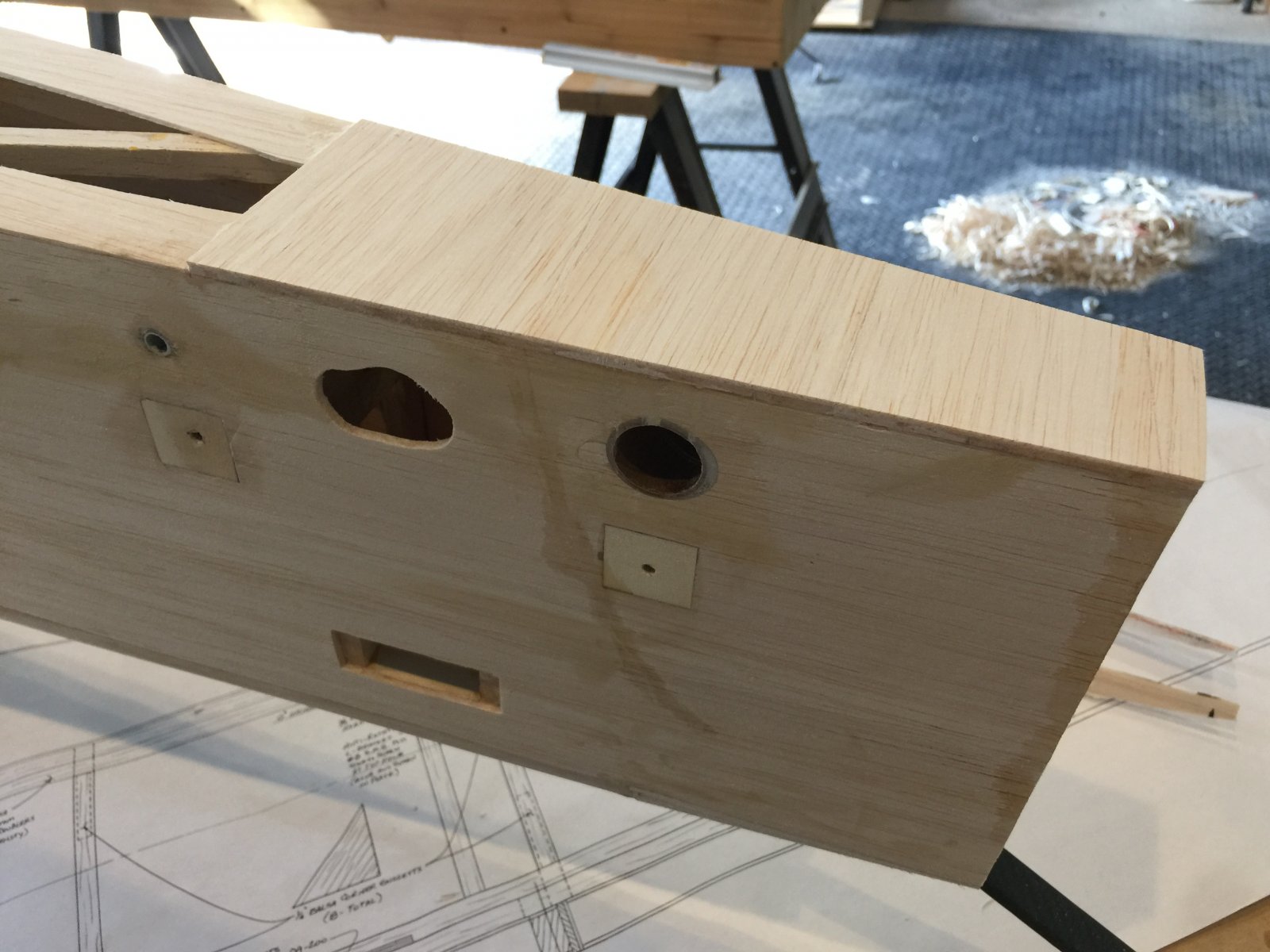

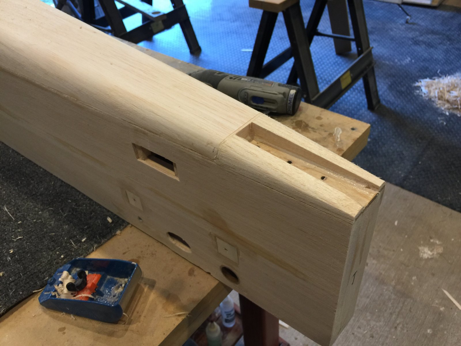

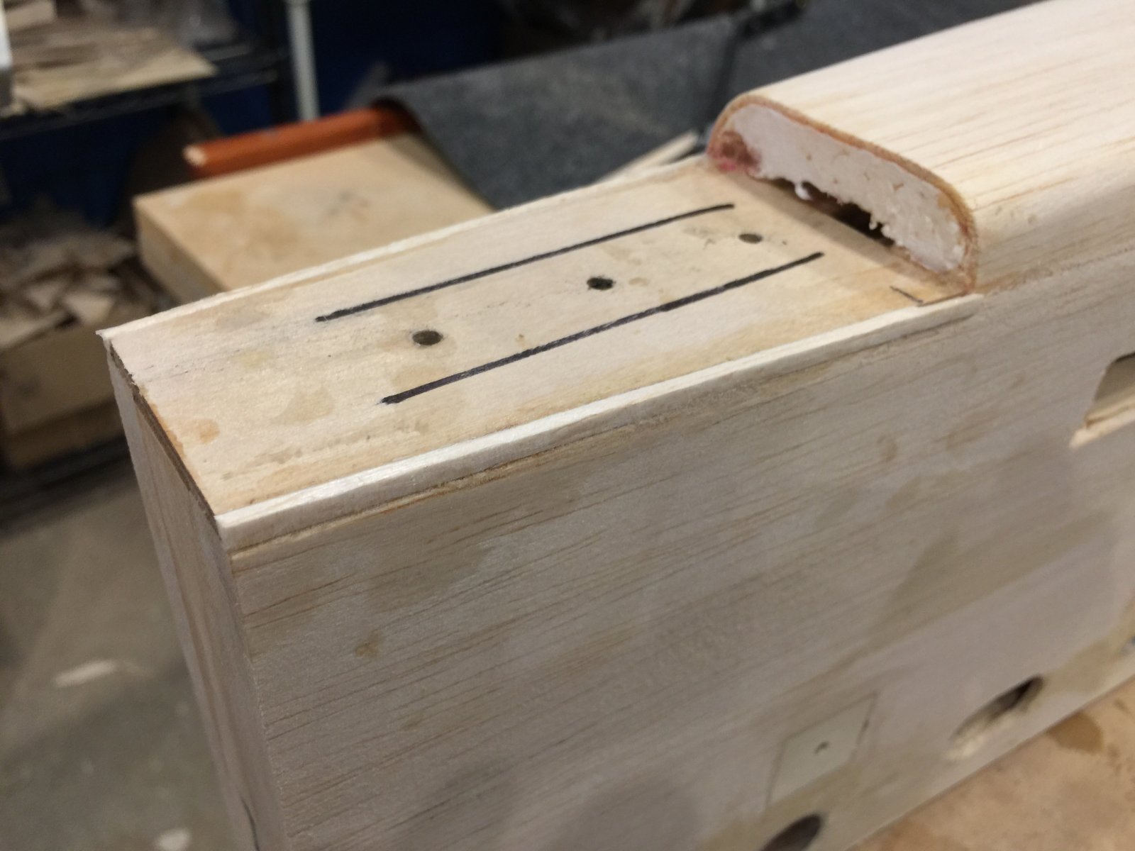

Tail wheel balsa:

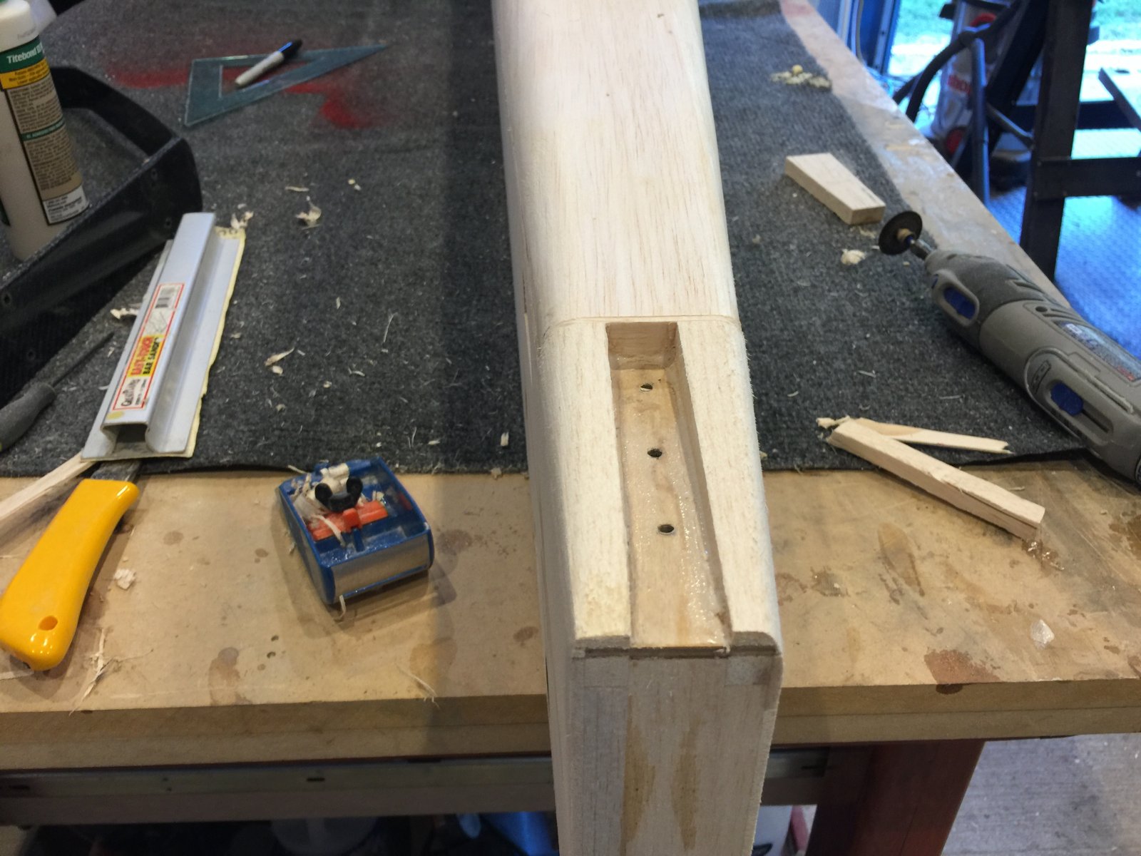

I need to mark where the carbon spring goes, and then I will have to fill the rest in.

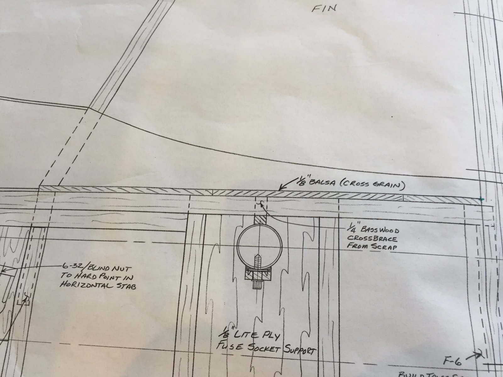

also, please note, that the plywood from the tail wheel support, there is no sheeting on its side. I had to fill this in with balsa,

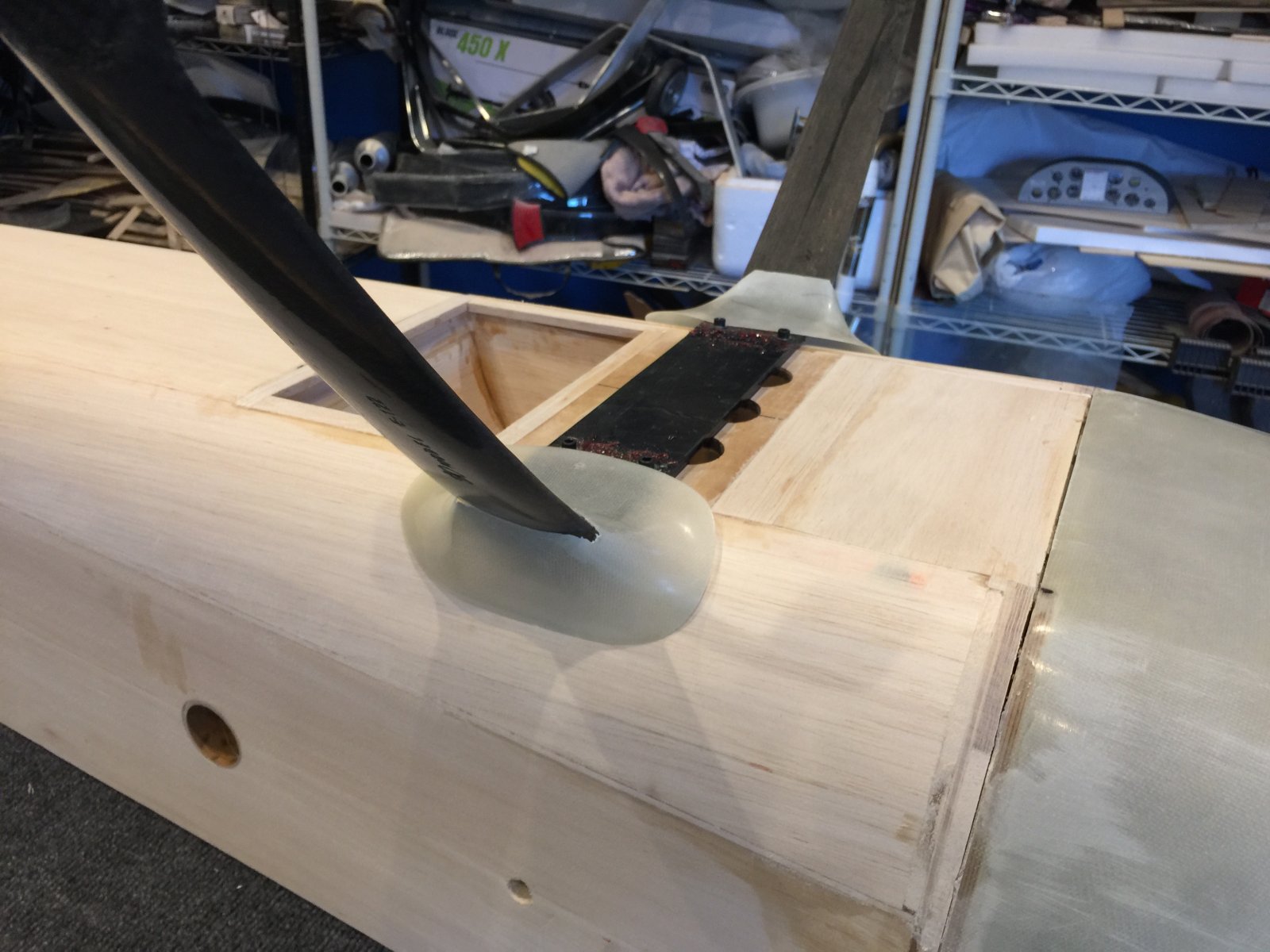

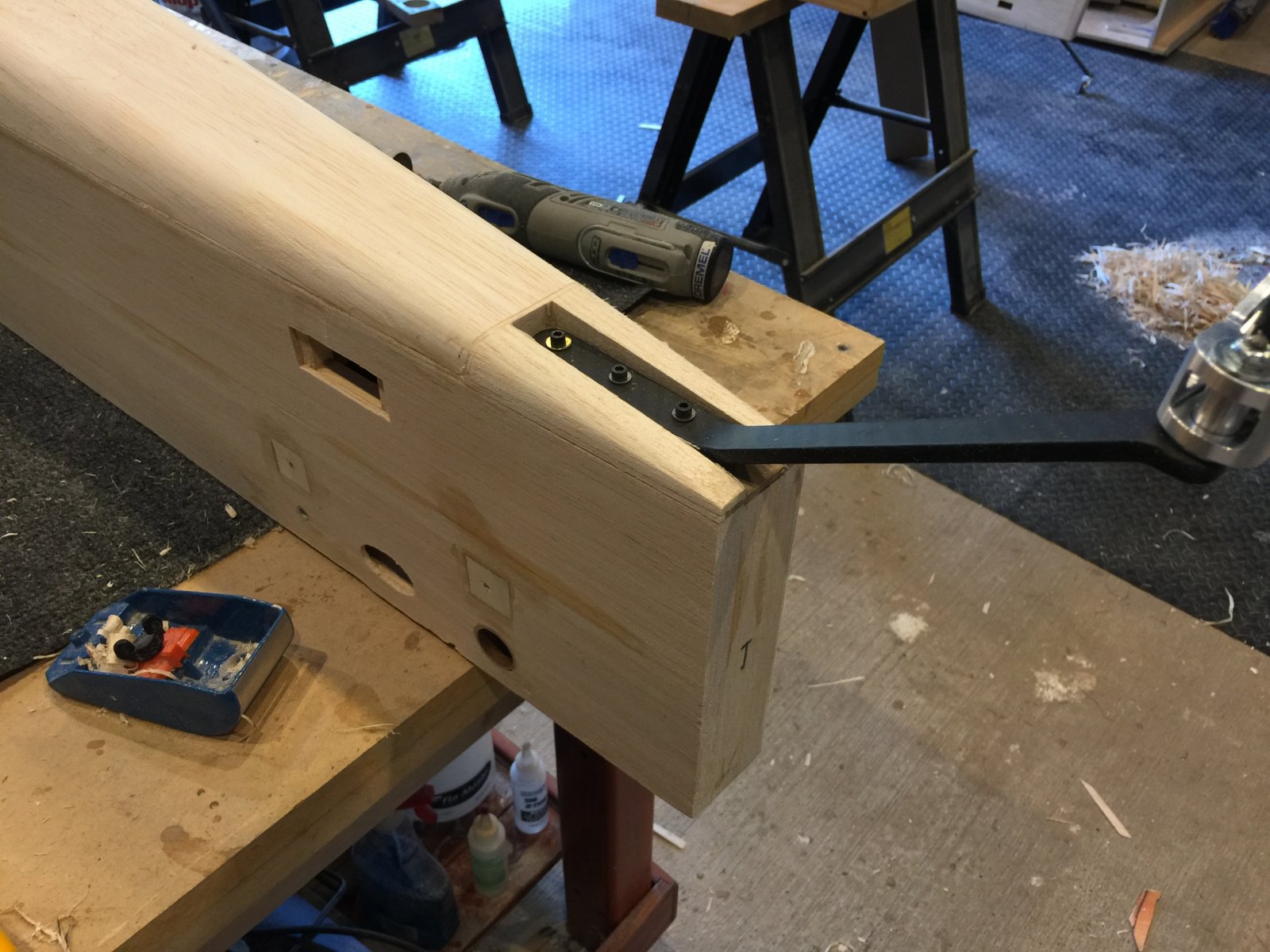

Ok, I did it, I ordered online from Chief RC store. Whom, I must say, is very unreliable and the person who runs it, the RC department, very rude. OK, well, he has redeemed himself, but I still would not order from them again, since I think this was a winning the lottery type thing!

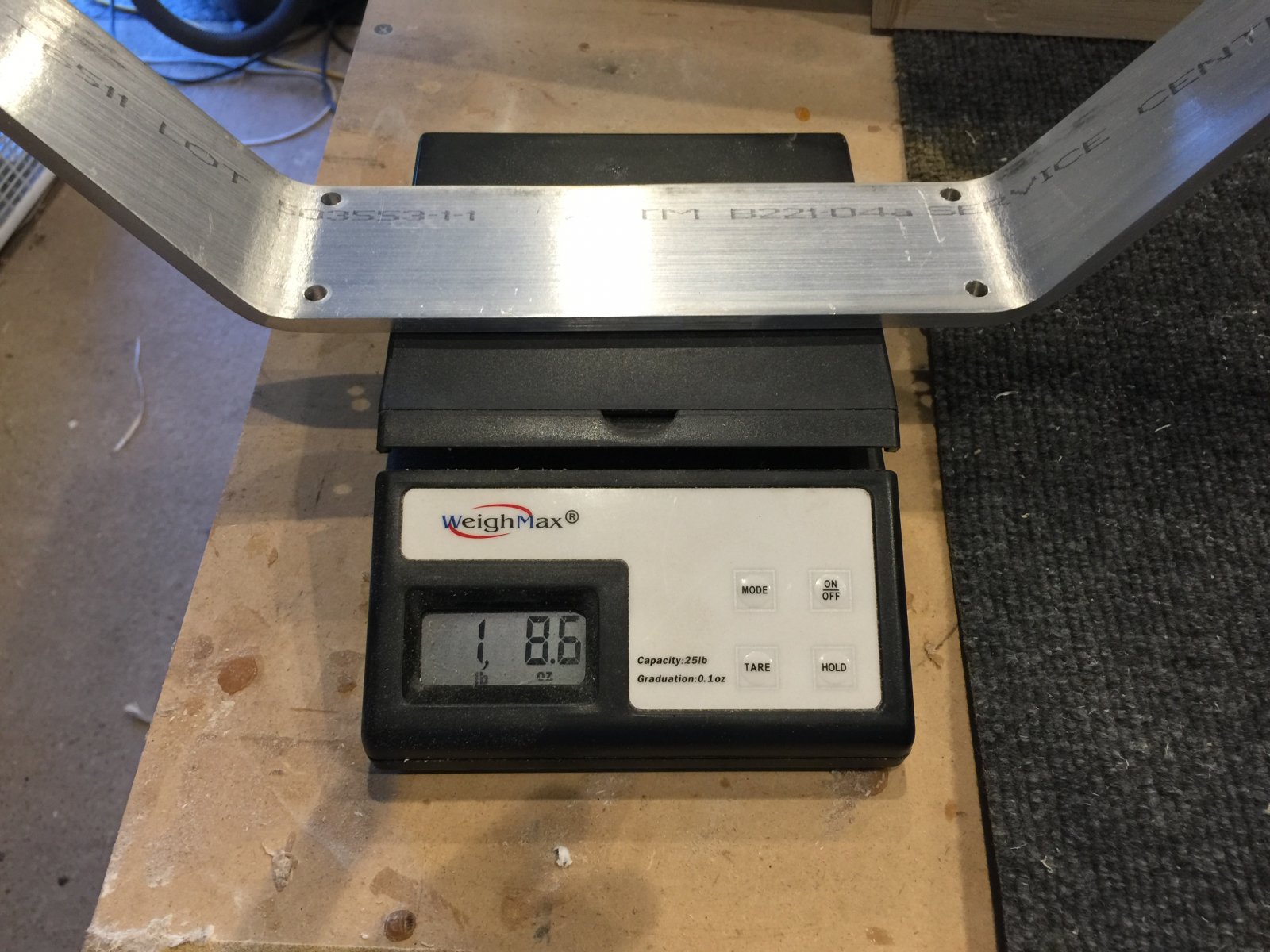

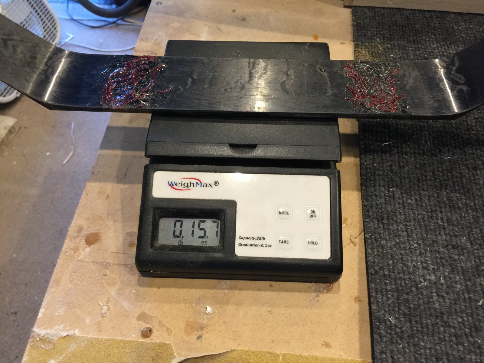

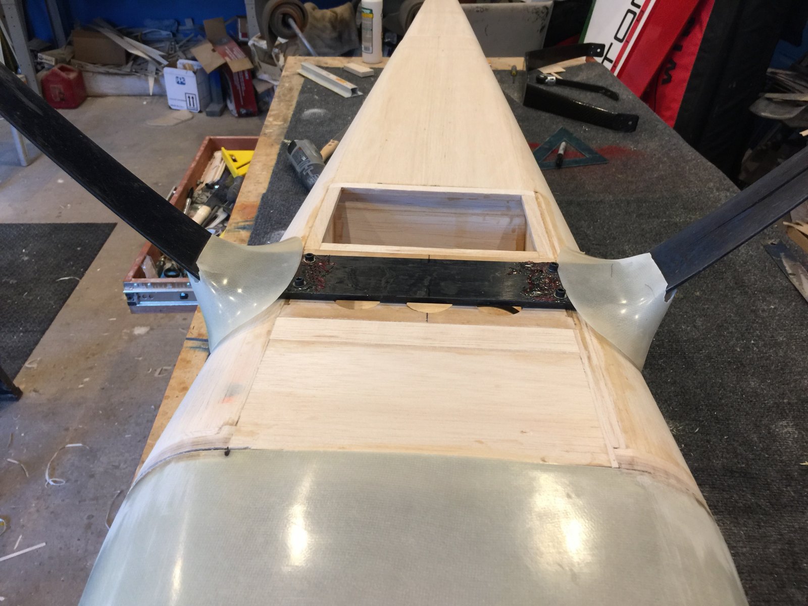

I found on their website these new carbon fiber landing gear for like 70 dollars! and the quality is superb! For a 40%er.
You guys better go check them out
it says SD hobbies on the side.
The gear are real good carbon fiber. SO much better than even the best Graph Tec, back in their day.
I have a LG from Bill Hempel on a Yak, and that gear is like the best!! This one reminds me of it.
On all my past 3DHS extras, and also the graph tec gear, all, have fractured, some on the 3rd landing, others, after 100 or 200 flights, start to sag.
But not the Bill Hempel one. SO maybe these will hold up as well as those.
Plus, guess what else? these weigh over a 1/2 pound less than the Carden landing gear.
And they are already predrilled, even for the wheel pants!

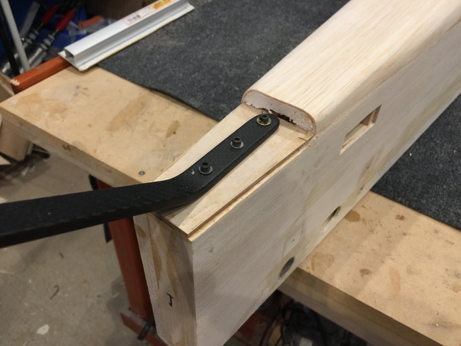

Also, it was drilled on the mounting area. SO this was filled with carbon fiber rod, and adhered with resin and then covered with kevlar/CF hybrid cloth.
then I predrilled them for my fuselage.
so a 1/2 pound less, I will take it!

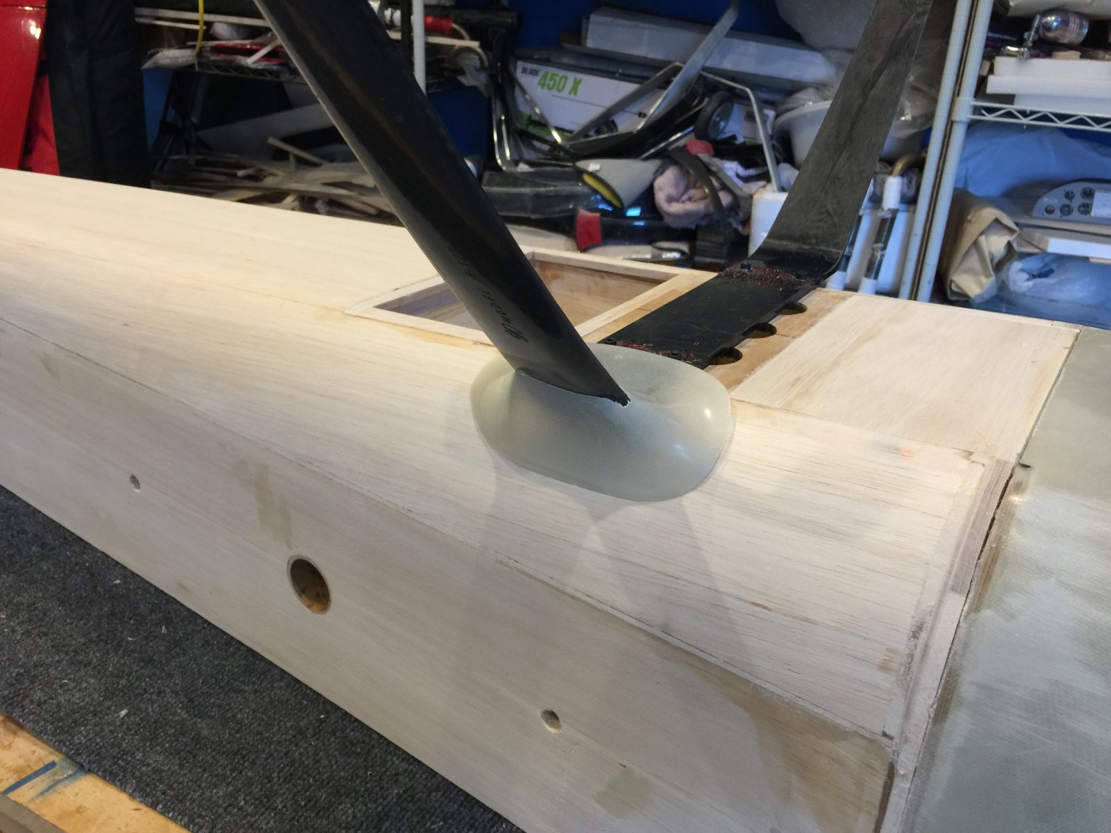

Now, something I have never used before! I feel privileged! This is going to be nice.
These are the fairings for the LG:
this is going to be real nice!!!
