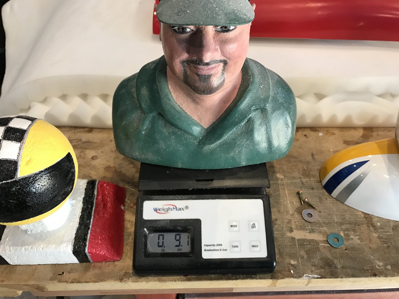

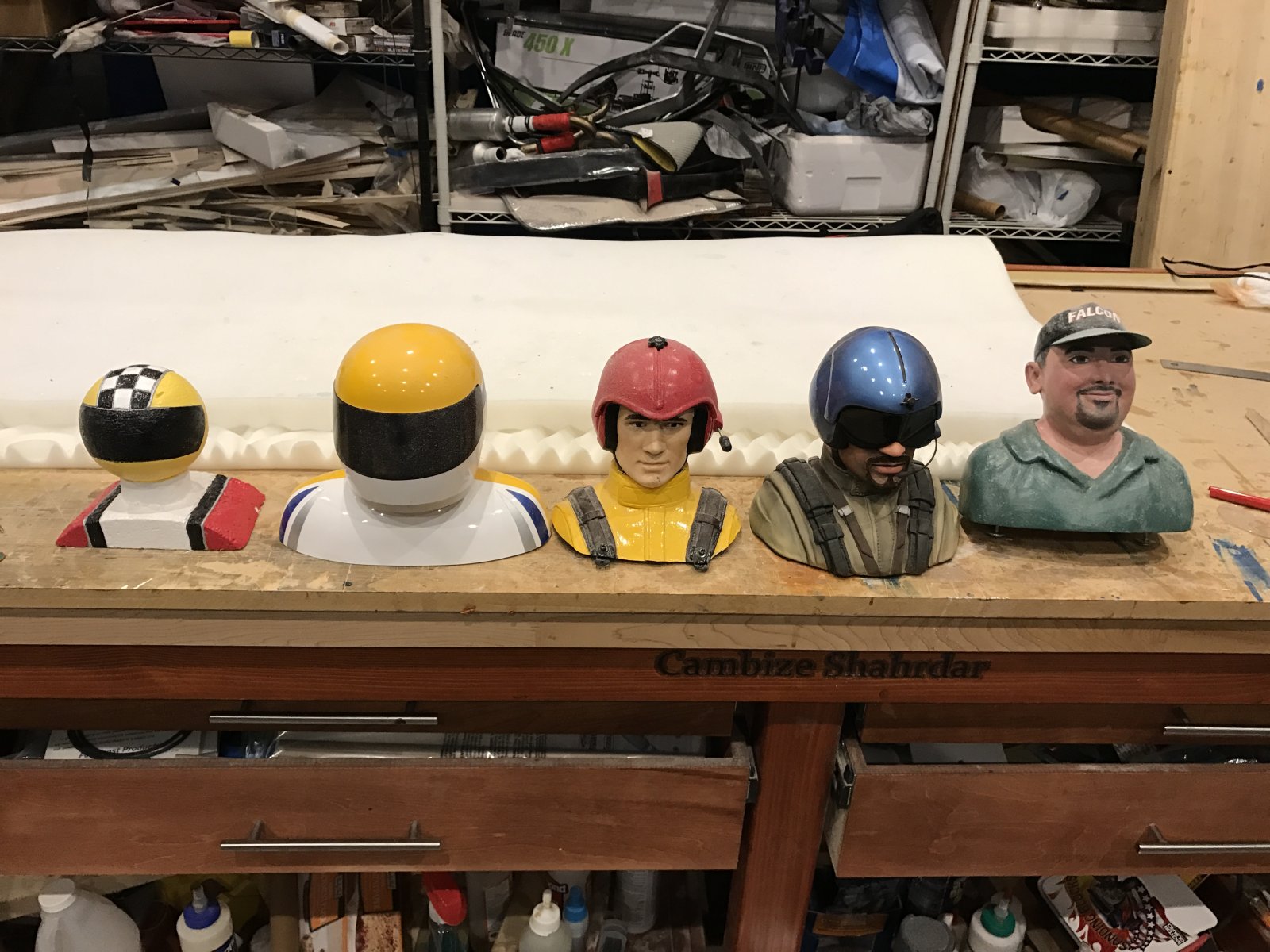

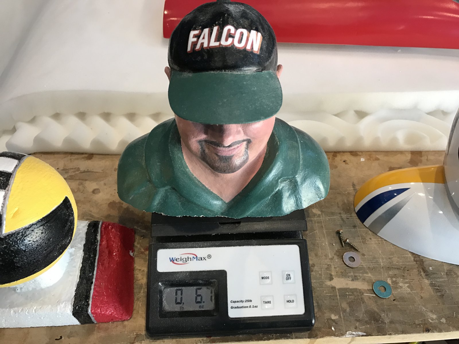

Here are some pilots, I want to say, from left to right is lighter to heavier. The one all the way to the left weighs under 1 ounce. the one all the way to the right is the heaviest. It is a balsa block. the others are either fiberglass or plastic.

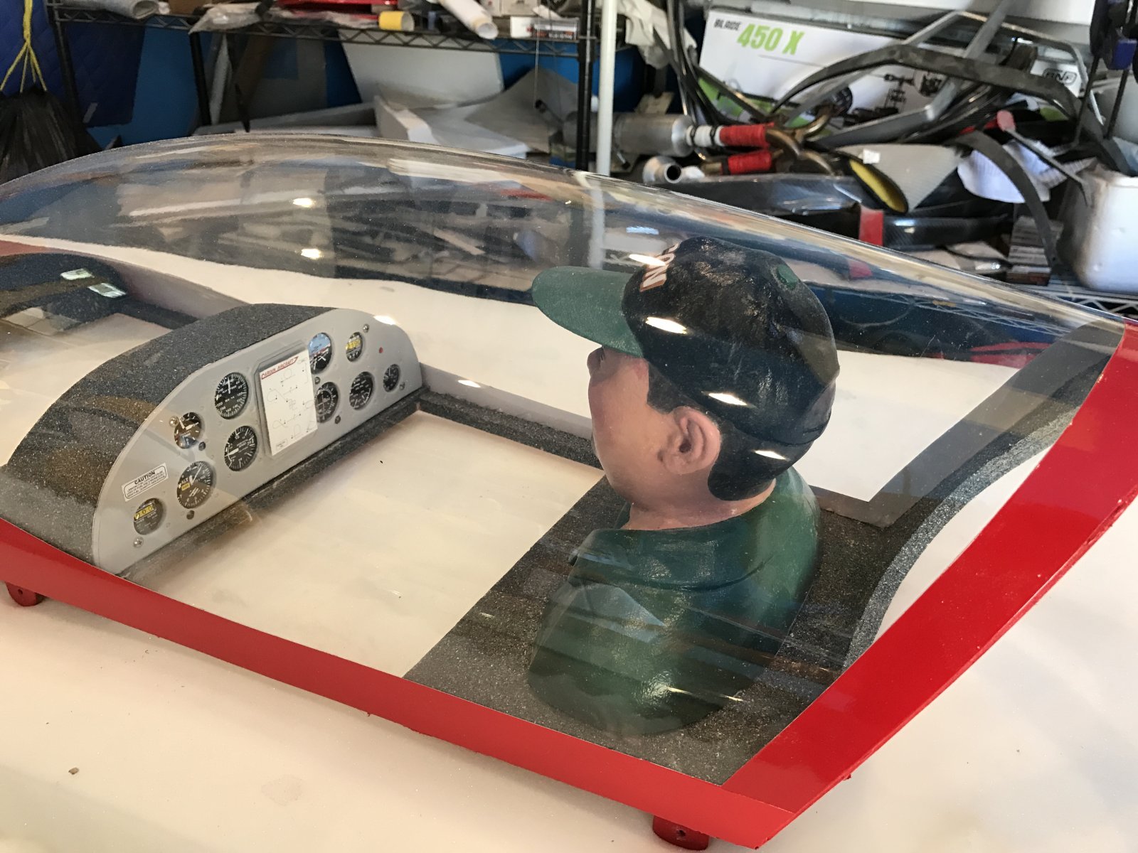

However, none of the fit inside the canopy, except for the foamy one. LOL!!
Looks like I will have to do some cutting.

Are these for plane one or two ,most of these are 35% scale . The G-force pilot I received was a 25% and fit in the canopy of the 35% Extra , the 35% would be too tall and would hit the canopy .
Like the yellow with red helmet pilot as second choice.
