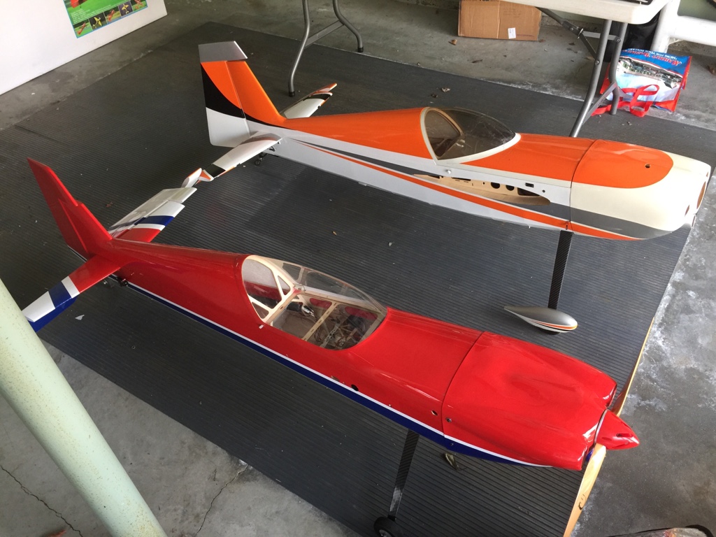

The Laser is a bit shorter than the MXS and has a wider fuse and is a little better internal design in my opinion.
What power plant you going with?
My laser fits in my SUV where a 50cc won't, so I understand that issue. Just that my 87" redwing slick is essentially the same money to put together as either of these "40cc" planes and is not terribly bigger in the fuse.
Not much difference in length. The Redwing has a bigger wing and thicker fuse. This is why putting a DA-50 into the MXS works.
Over on RCG there was a discusson on this. The Edge has serious pitch authority and the Laser is smooth, better balanced design. Similar weight and such. The Edge will be better at harrier and slow flight. Neither e-version is available yet.

bonedoc also put out a comparison of all the 60" birds. I think it was on the a extreme Flight owners Facebook page
Only thing is that there is a slight bit of difference in the sizes as the 78 and 76 are a bit heavier than the 2 74s. Also seems they have made the Edge character a little different.
The comparison was done by Doc Austin. He has a blog page.
