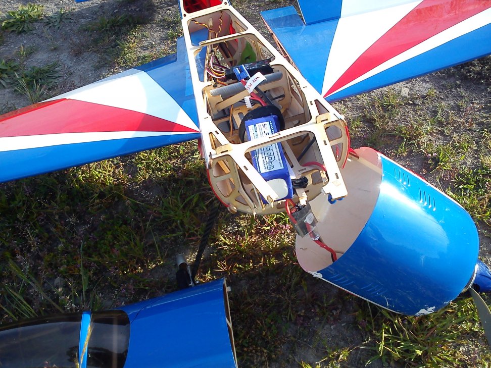

My Yak met it's maker today. A cold solder joint was the cause. This was one of my original solder jobs from when i first started flying and i had a terrible iron.
I might be able to repair it but both wings were ripped out and the motor box needs to be replaced. I'll have another look at the damage in a few days. IMG_20130413_082202.jpg
Steve_B
'motor box' is what I thought when I first saw the photo but i'm afraid if you look harder it's a lot worse than that. Look at the busted formers in the fus and where the wings are, one wing has broke through the fus and the wing tube mounting is ripped out.
Fixable maybe but a lot of work to do it right.

Yeah it especially sucked because i was on my final approach to land on my last battery and i planned on switching ESCs before my next time out.
but on the other hand... wing has 3 or 4 points where it holds to fuselage... wingtube, wingbolt and 1 or 2 pins... by the looks of it, top fuselage formers and bottom carbon stringers are in 1 piece... if you have all parts to properly put together at least 2 points, repair should go muuuuch easier... stringers? cofffe stirrers and a lot of fibreglass... im waiting for money to recover my 60" edge to test durability of repair... but it looked a bit worse than yours... both wings and half a fuselage formers behind a battery tray was displaced 2 inches to the left... well, 2 days and 8 beers later all thats left to do is recover...
