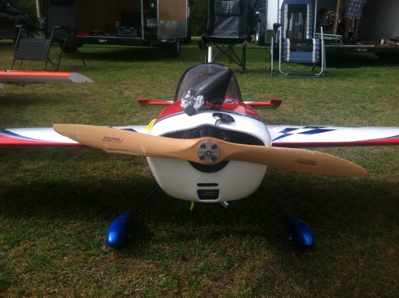

Maybe I can spark some advise here without starting a new Forum. Had a bit of a well damnit moment this weekend, the bolt that holds my spinner on snapped in a full throttle up line and my prop eat my spinner, destroyed both spinner and prop also caused my header to crack, I have ordered a new header and need a new prop I was getting good performance with a falcon wood 23x8 7200 RPM on the ground and fairly quick spool up, Would a CF 23x9 hurt my spool up and RPM or would I keep good performance and gain a little speed? busted prop.JPG

I would think the 9 pitch would drop you to the 7000 range and more speed and slightly less speed on spool up. But I don't think it would be that bad. Never hurts to try.
I am just thinking the back plates and poor grade bolts on these carbon spinners is plane poor. The cones are ok but many will recommend an aluminum back plate which can be had from TT. Like Brad said. Probably get better thrust as well.
