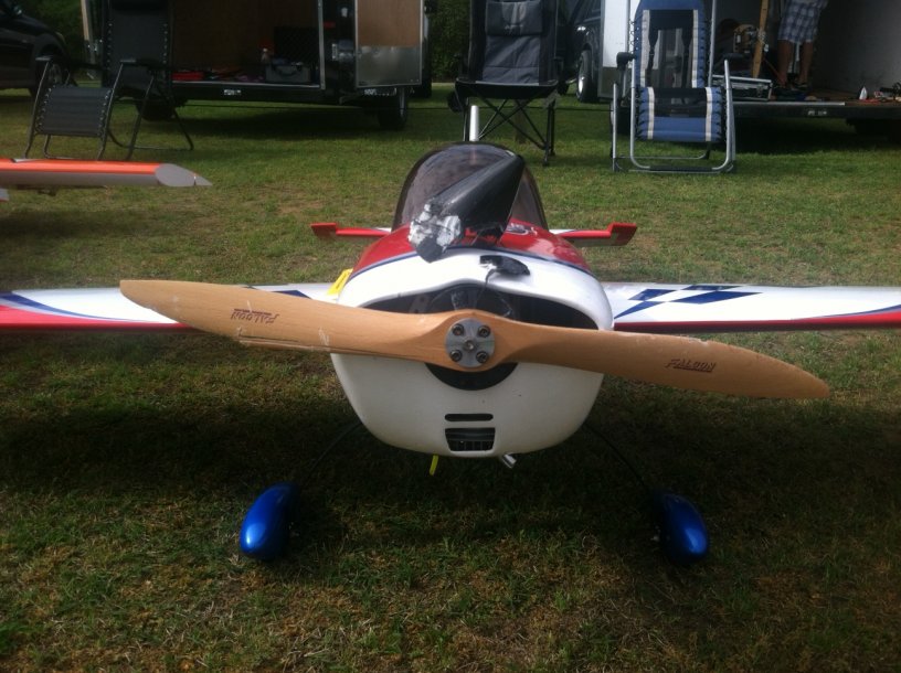

Maybe I can spark some advise here without starting a new Forum. Had a bit of a well damnit moment this weekend, the bolt that holds my spinner on snapped in a full throttle up line and my prop eat my spinner, destroyed both spinner and prop also caused my header to crack, I have ordered a new header and need a new prop I was getting good performance with a falcon wood 23x8 7200 RPM on the ground and fairly quick spool up, Would a CF 23x9 hurt my spool up and RPM or would I keep good performance and gain a little speed?View attachment 17679
A friend of mine is running a 55, but different manuf. Was running a 22x8 Xoar at 7200. Went to the Falcon 23x9 CF, increased his performance without dropping RPM. He stayed at the same RPM figure between the 2 props.
So, I would expect little to no rpm loss, but your performance will increase some. Falcon CF props are wickedly effecient. :)
