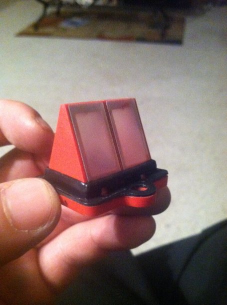

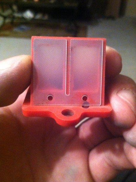

Ok I know this is coming from my EME 55 But I have had an issue with a fuel leak, I have a small spray into the motor box and a drip that is obvious when the cowl is pulled. I attempted to fix this today I changed the gaskets with a new kit also changed the fuel meter needle and diaphragm, I know that a bad reed valve seat can cause the spray so i decided to check the reeds, I know they clam to have fixed the issues found in other motors in this area but the block was just as rough as any DLE I have resurfaced, I also noticed that they didn't screw the reeds down to the block like any normal two stroke they only rely on a formed rubber band to hold them, This I did not like the idea of. Now I may be wrong in thinking this is a bad design and if so by all means some one correct me but its obviously not the normal set up.

DA does not screw reeds in place either. Not doubting you may have a leak, but I have never run a single cylinder engine with a rear carb without a velocity stack on the carb. This helps curb fuel spray that is pretty common.

Well that is some comfort lol, I found that and my jaw dropped, But I know how my DLE's are and how any two stroke bike or boat I have had were set up, I did play with the thought of a velocity stack though I figured it would help with the spray plus I have red standoffs servo mount arms and screws coming and i figured hell why not one more thing i can add some flair to
Just my 2 cents. By using just a formed rubber gasket that doubles for a "floating" retainer the reed petals stand a better chance to open and close with out causing fatigue to the reed petal and thusly breaking. Also reduces tension so the petals more easily open and close with crank case pulses. I see a down side that if the rubber gasket gets deformed or damaged in any way issues will appear. I knew my EME 60 reeds were done this way and elected not to disturb them when I made the repair videos for the crank and rod.
