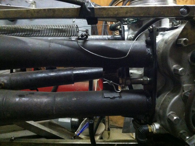

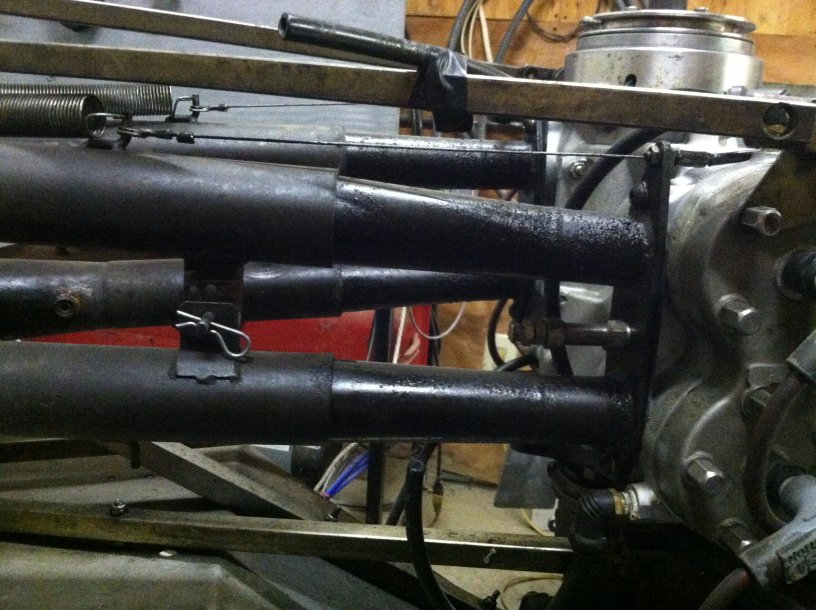

Ha! You are right on target! Here it is being used today on a 350cc outboard racing engine! LOL
These expansion chambers have VERY Narrow power bands that require sliding. Pipes back = 10,000 RPM
Pipes up = 14,000 RPM.
From all the info I have and following Trever hoe does a lot of testing it seems that all the motors that I have played with and the last testing Trevor did with 35cc engines the ideal length is 8 1/2 header length. Hope that helps. The only unfortunate thing is that all the pipes and headers are tuned at full throttle. I am no expert but played with and built 50cc racing bikes in thr late sixties and early seventies and built our own e axpansion pipes for the motors. If you new the rpm you run while you were hovering you could tune the pipe into that location.
