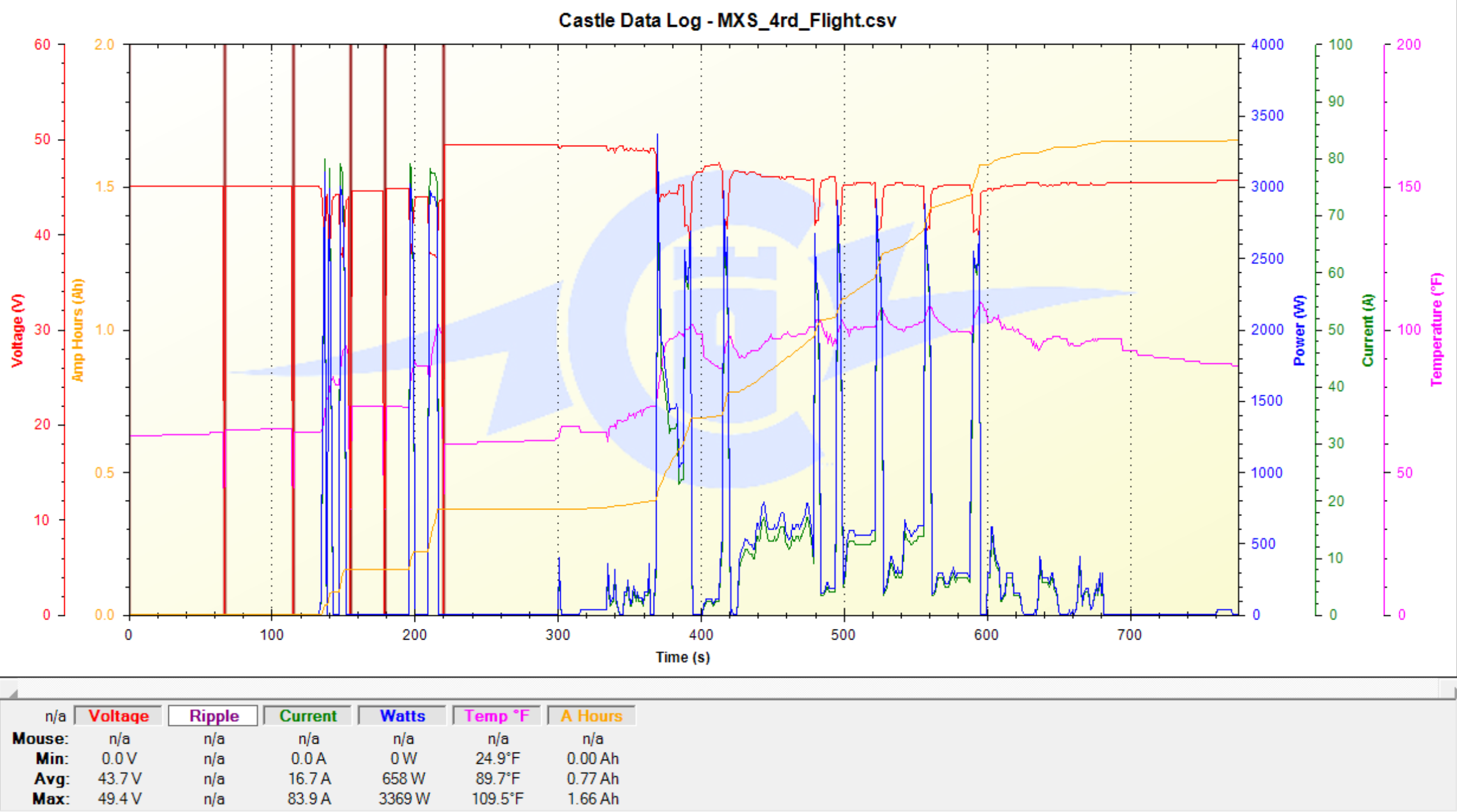

So I sold my 89" Slick and I'm back to thinking about getting the MXS and going electric. I know some pilots are doing a 50cc equivalent power plant but what about going with something along the lines of an F3A set up?
So instead of 12S 5000mah, I would go 10S 5000mah. The weight difference between the Motrolfly 5335 and 4330 is almost a pound lighter, the batteries would be 1/2 pound lighter, and so loosing 1.5-2 pounds would be possible.
The main reason to go this route is if I ever got into pattern, I'd have some batteries and it is lighter weight.
What do you guys think?
