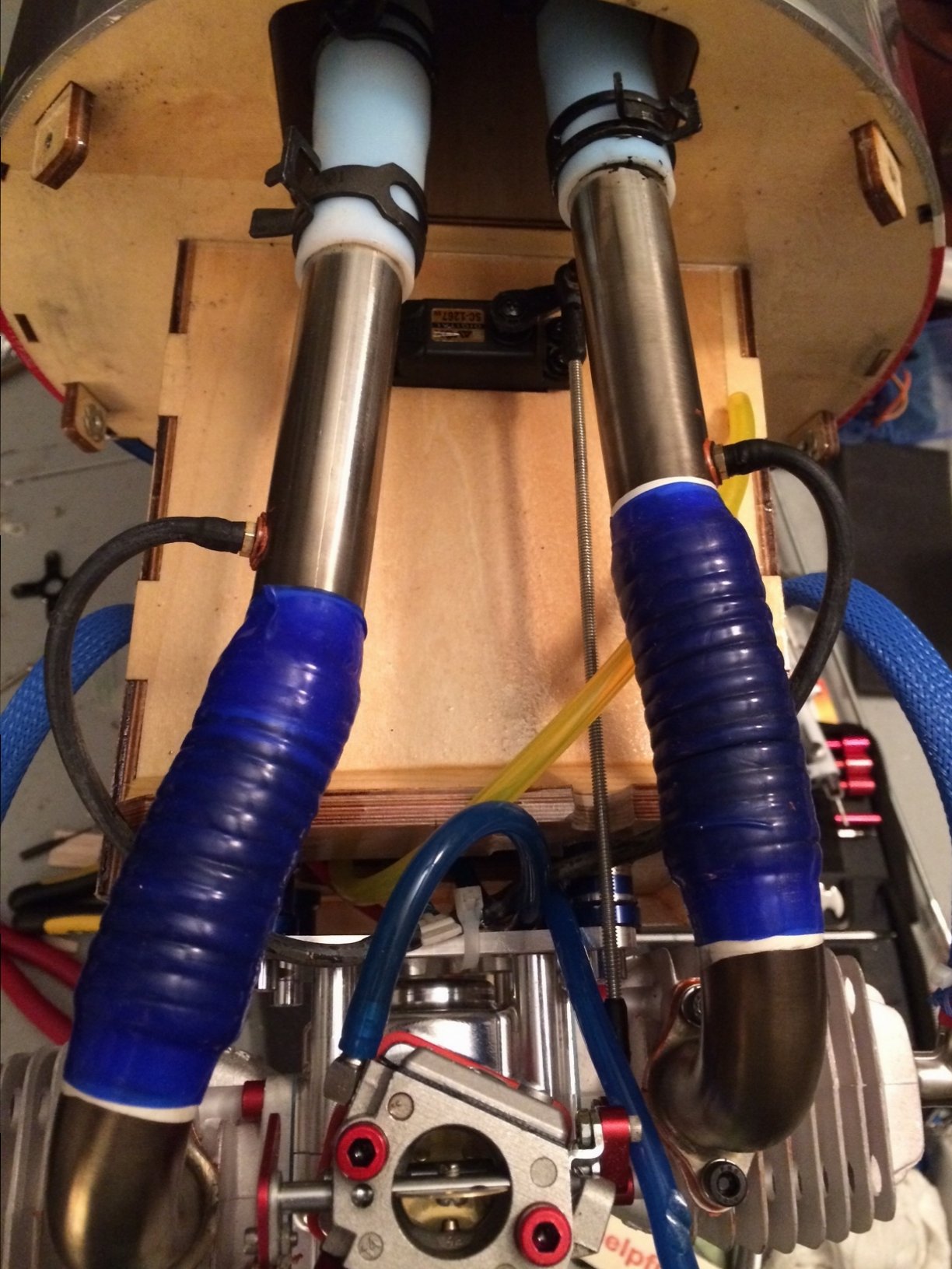

Dribar, what plans do you have for exhaust on your new Yak? Here are the static pics my twin pipes from the video. However, it took a lot of cutting and engineering. Alternatively DA is about to release a 2 into 1 header that can be fed into a tuned pipe or can. Tony at DA has the details. Just FYI.
Richard

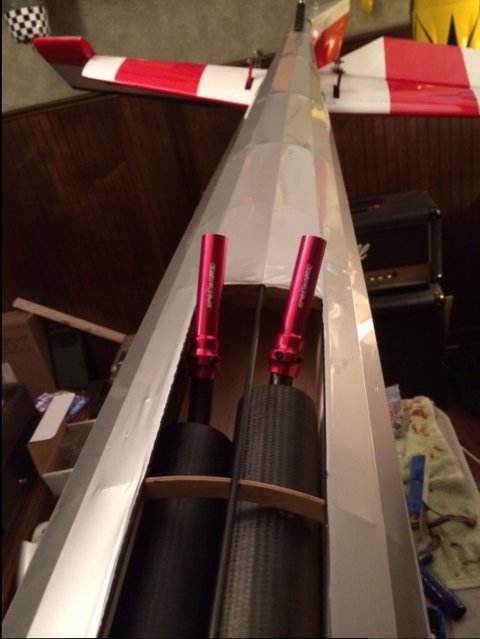

Hmmm, only lets me upload one pic at a time?
Here is one with the smoke tubing installed.
dribar
Richard
I just got the stock mufflers. Should be pretty simple and my field has no noise restrictions. Thanks for the info!
