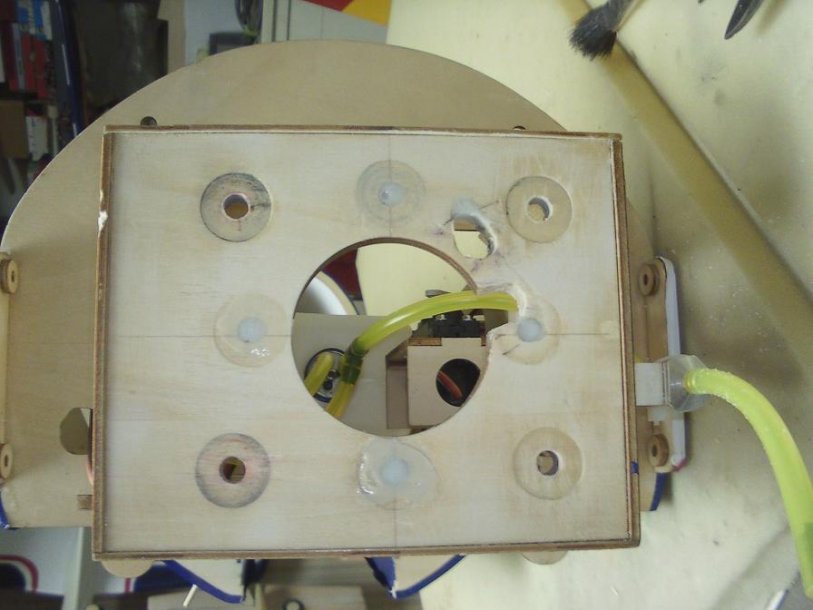

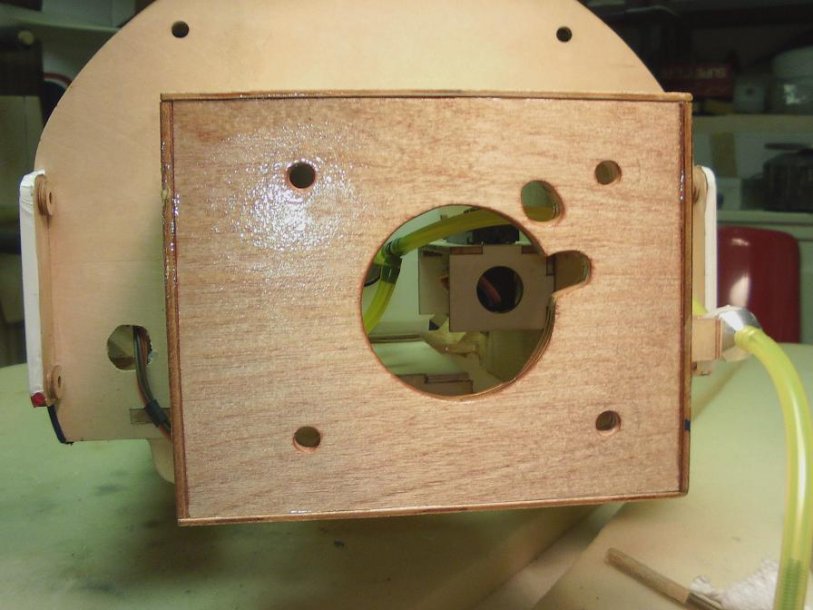

I had an Aeroworks 50cc Yak that was electric powered before someone else tried to install a gasser. It was a mess, it looked like the guy used a chisel to cut the throttle linkage hole. I filled the extra holes with epoxy and ground fiberglass and then laminated a piece of 1/32" ply over it to make it look good. It worked out well.

they can look pretty ugly after they've been through a couple of different engines/motors, throttle servo locations, fuel line and ignition wire holes, etc.
clean 'em up though and they look great! laminating the firewall though, that's almost like bling for an old plane's soul....i commend you!
