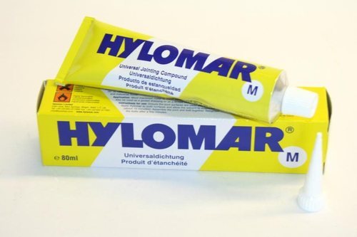

@Skyluc, which exact Hylomar product do you use as the company makes many under the brand?
I use Hylomar M,it has been working fine for me for years now,it never dries and is fuelproof
I did not have any Seal All handy for a recent Taildragger rc tank installation but did have some Sigment. It is fuel proof, I used just a little at the end of threads. Probably made it a permanent cap but how often do you need to remove it?
