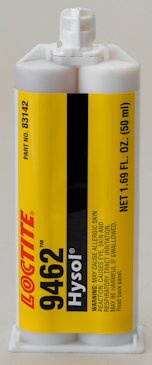

Loctite 9462 hysol or something like that. It used to be mainly a jet thing years ago. Works great for wood against fiberglass fuses. Its a 2 part mixture epoxy type material that when mixed is thick white. Dry time is overnight. It is strong stuff.
Honestly they make like a jillion different versions and I have to look at my old orders or the tube to remember what to buy.
