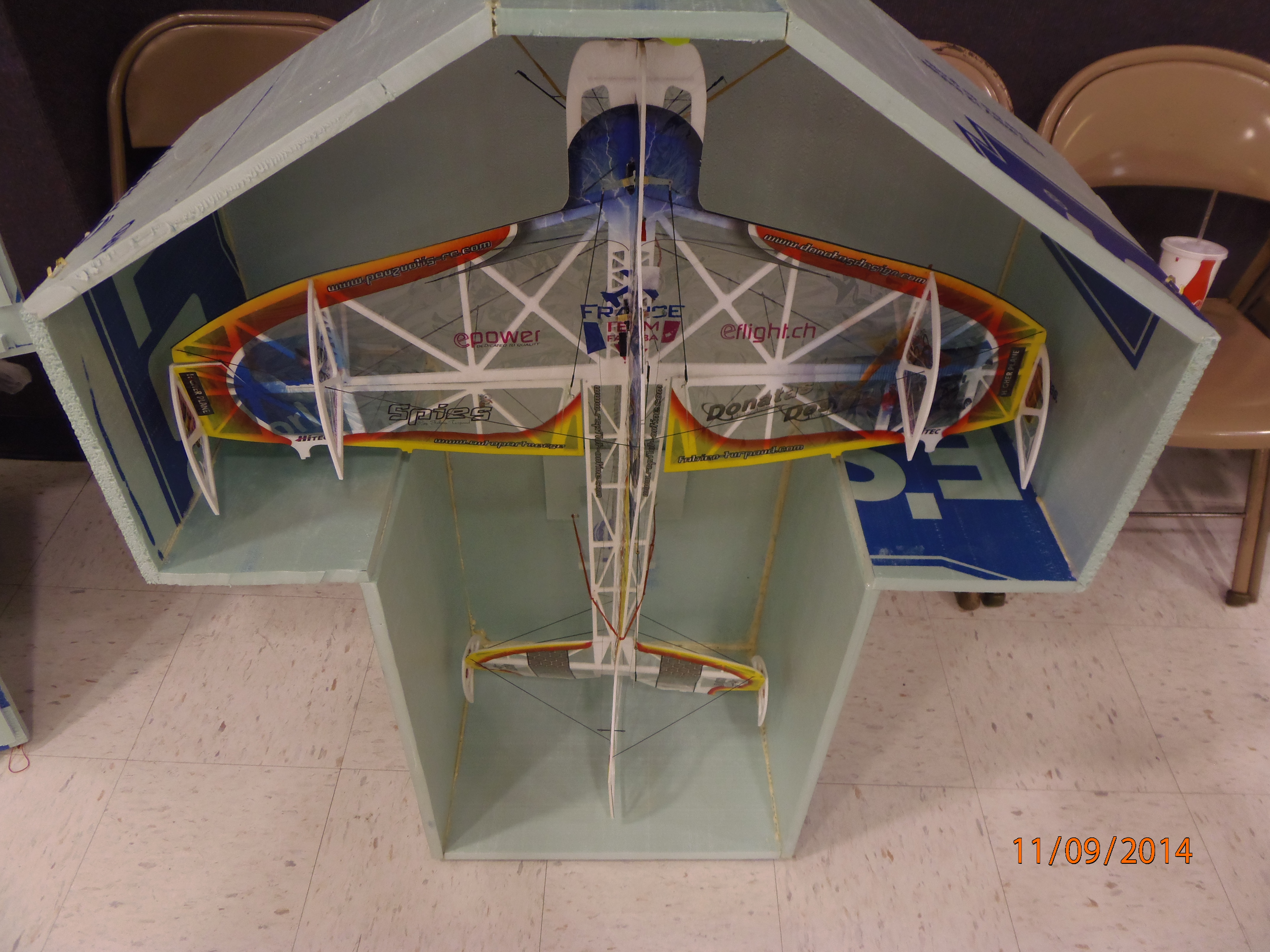

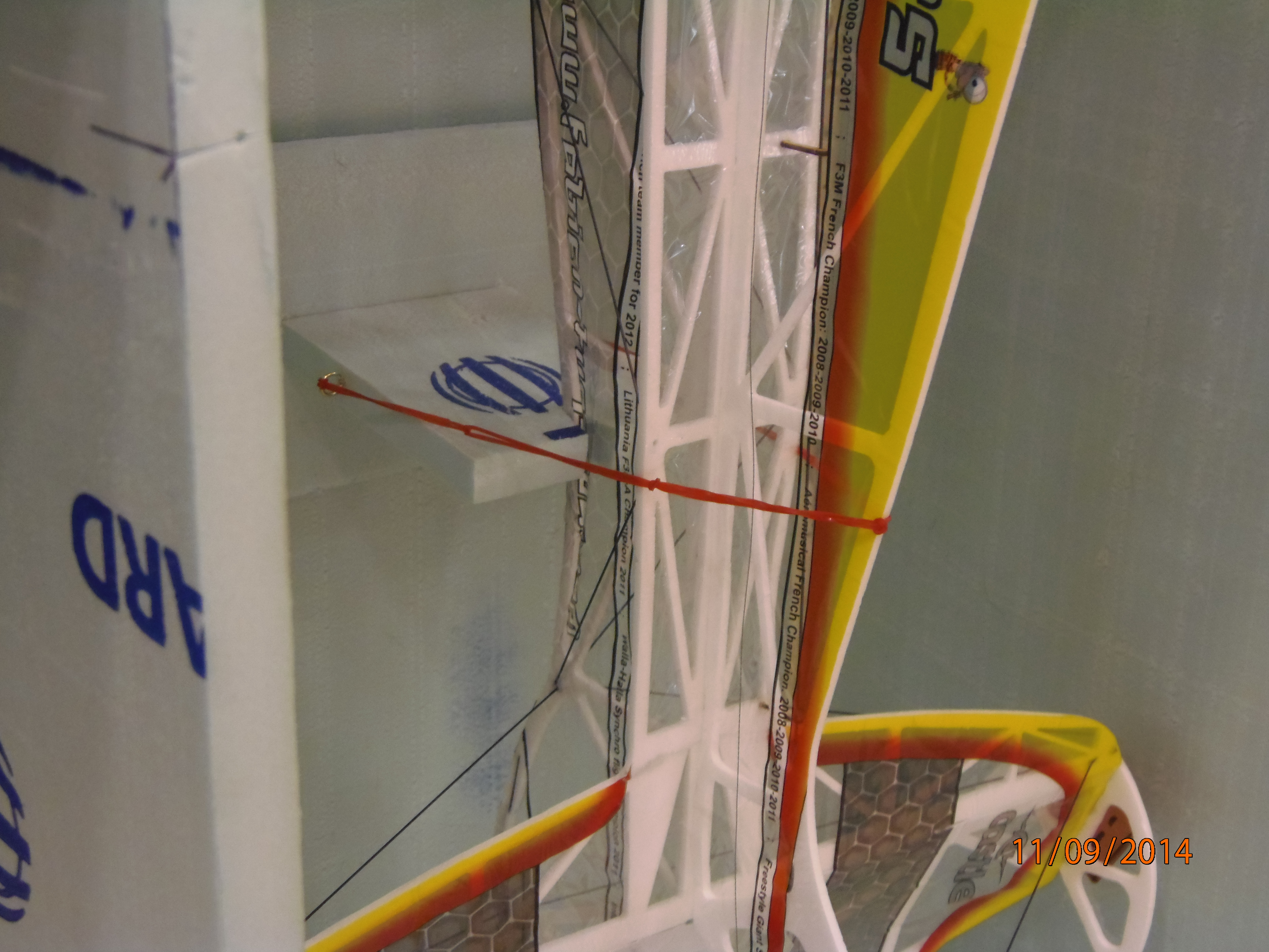

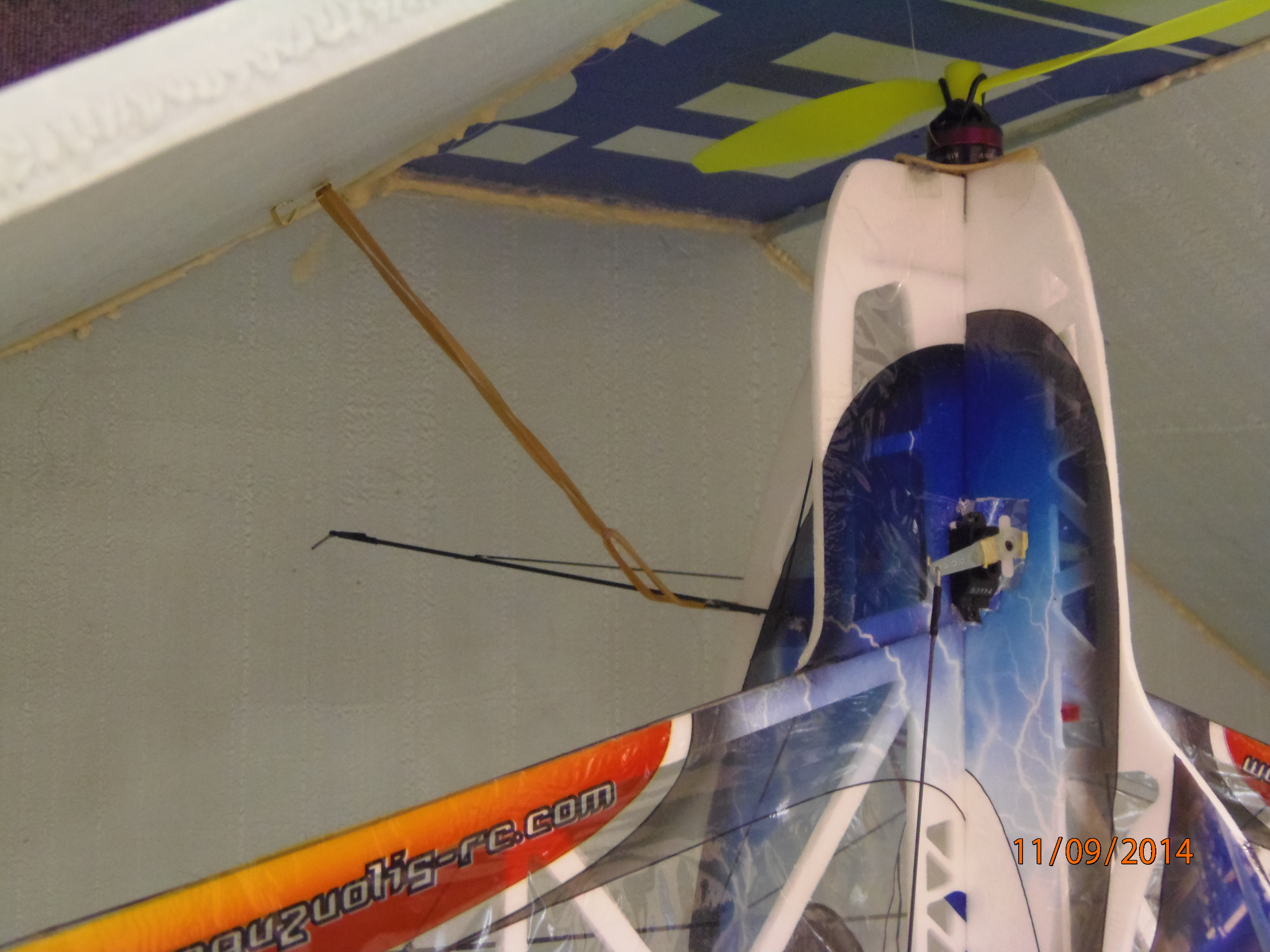

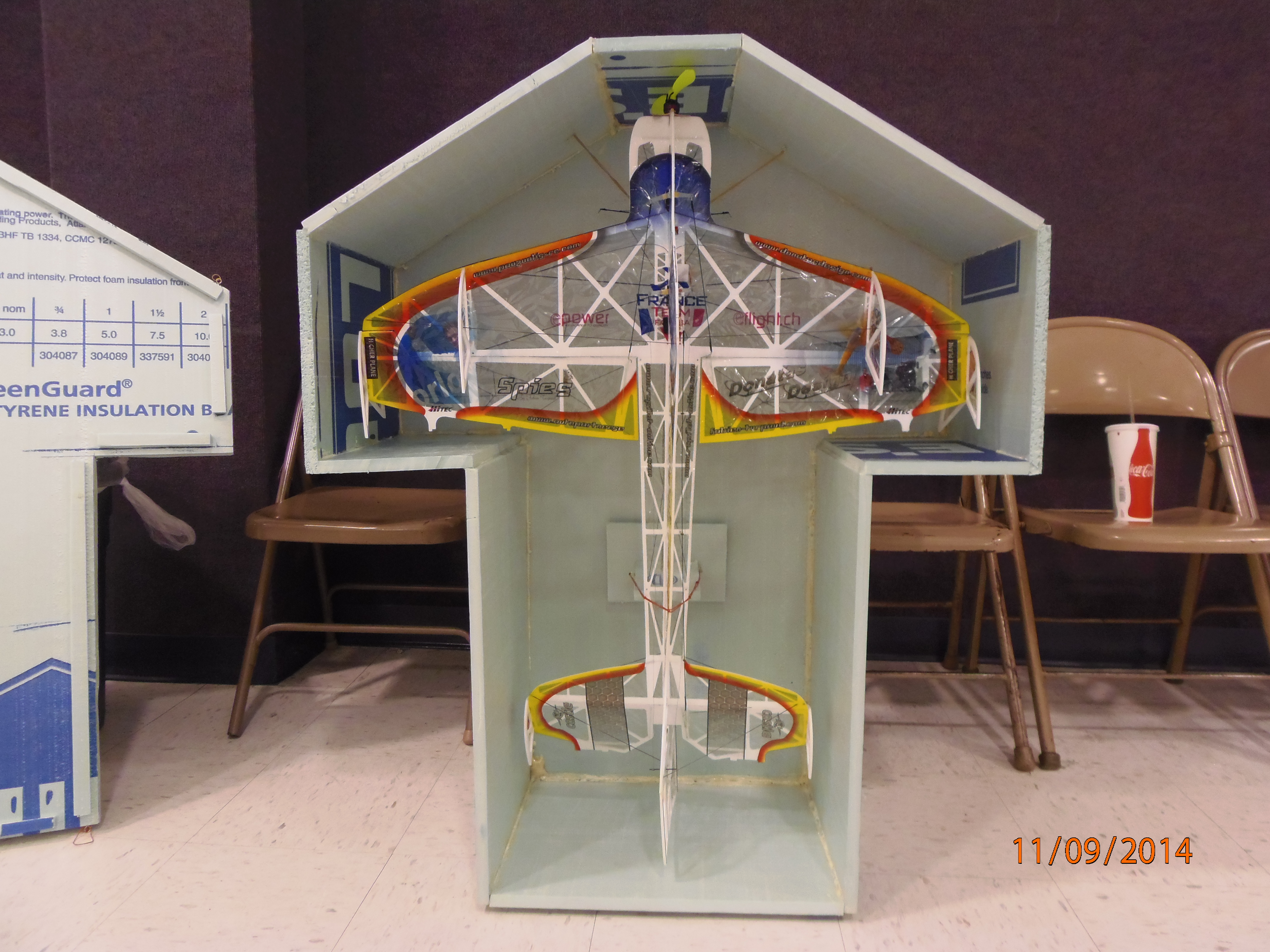

Figured out how to suspend a plane in the box for transport. Dollar store had these picture hanging kits and rubber bands. Used those to hold the lid on and to hold the plane inside the box. rubber band chain holds on the the loop that typically goes on the back of the picture frame to hold the wire. The hooks that are usually on the wall are on the other side. There is a foam piece inside that hold the rudder up off the bottom of the box. That has a rubber band very loosely holding the plane to the foam piece. The only other component is a rubber band from the front of the box, around the gear and back to the front of the box. This hold the motor to the front of the box. You can stand the box up and the rudder will not be smashed against the bottom.
