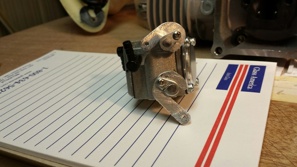

Sorry I'm afraid I don't. The best I can offer you is a picture I took during the process. I also rotated the carb 180 degrees on mine to make it line up with my throttle servo.

30cc
PSP mfg. sells arms for the GP 61. You grind off where the shafts are peened over and pull the short arms off. Both shafts are 3/16", so one of the arms needs drilled out to .188" diameter. The new arms have two set screws so they will hold with some red lock tight. The arms are not drilled for a clevis so you do what ever your favorite is. Its still a small space to connect, but it can be done with a forward choke rod.
