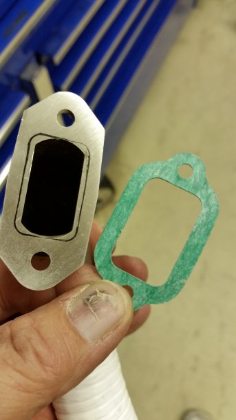

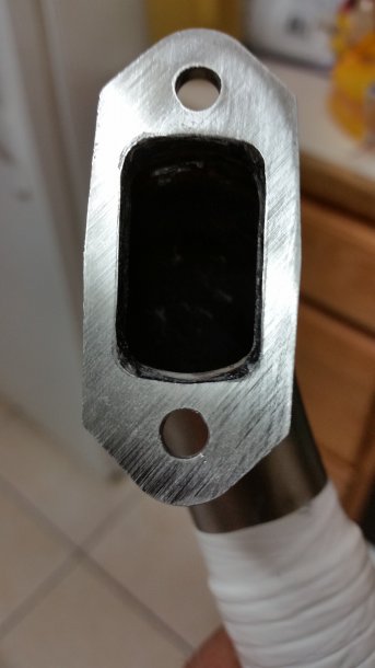

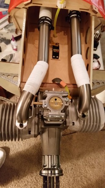

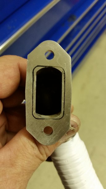

Terry, I sold the adapters with the motor. However I do still have one new set of DA headers. I used a dremel and a diamond bit and "shaped" out the opening of the header to fit the exhaust port of the GP 176. I used new gaskets and red silicone high temp sealer...just a film... on both mating surfaces. (Jugs and Header Flanges) It is also necessary to "open" up the header bolt holes just about .5 mm or so on each of the two bolt holes on each header. The alignment is so close but just not close enough without grinding them out just a "tick". Bolted them directly on and fit, looked and worked well. They fit perfectly and had zero leakage.
