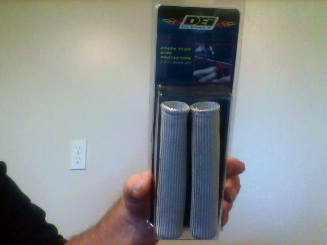

I have used the "yellow" and it is a bit better than the "white" Teflon tape. I make several wraps (about 4) and then cover with these nice auto motive "spark plug wire" protectors. Really keeps things "clean" under the "hood"!
