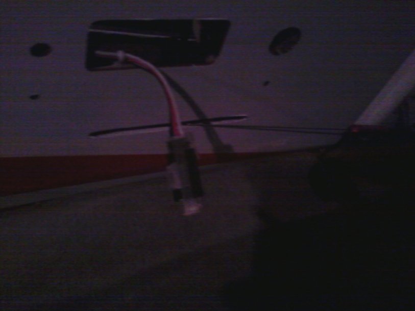

I have been setting up my large planes for 4 or 5 years on the tail like the picture. I have never had any issues with the connectors coming out or even appearing to be backing out. I use a similar set up for the main wings.

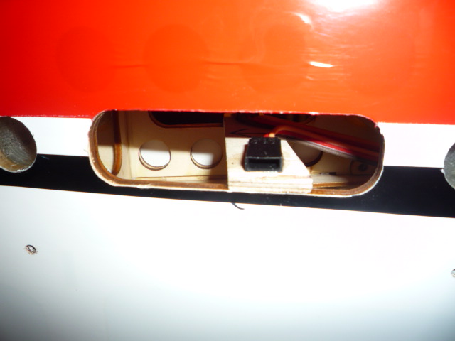

Cam if you have duel servos on each stab and you want to be able to remove them Chad @ taildraggerrc has these....I use them on my wings but not on my stabs since I never remove my stabs for transport. They lock in good and you never have to worry about them coming loose during flight...
I use nylon wire ties that have a square flange molded in for affixing to something secure and then use the plastic servo connector retainers.
I use nylon wire ties that have a square flange molded in for affixing to something secure and then use the plastic servo connector retainers.View attachment 4660
I too have been using the same locks as "dimes". On the new Sukhoi I did however want something a little more elaborate. I also ordered the wing harness from Chad for the big Suk. I may still do the stabs as they will need to be removed for transport. Thinking I may upgrade the big 260 also. For the 50% Edge? Yeah, no extensions... Going to hard wire everything and will use TDRC's harness throughout the entire airframe. Dang this hobby is fun. So many really cool things to buy for your big flying hoopties.
